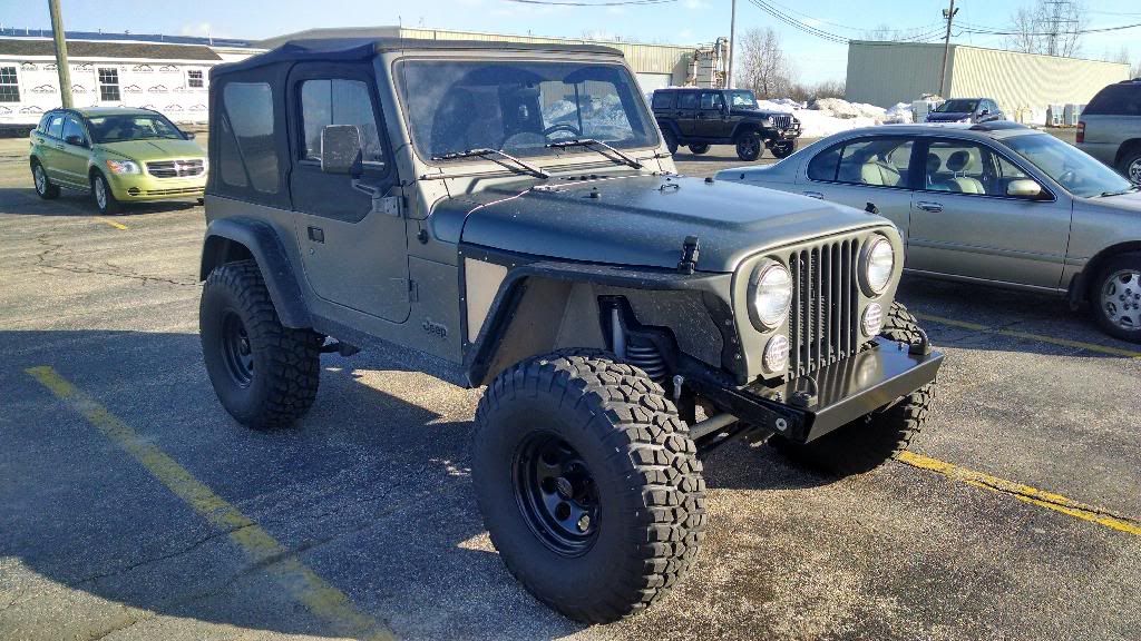

Well, love it or hate it, but I have a new build.
I just brought home a awfully unique Rubicon. It's an 05 with Auto, AC, Cruise, and has 47k miles. It has banks exhaust, banks cold air, 4" Teraflex lift with all 8 adjustable control arms, ARB rear bumper, mismatched tires, a kickin sound system, and oh yeah, a CJ Grill! The Jeep is painted some silver Ferrari color - Ill have to go back through my texts and get the paint code for those who get chubby's over that sort of thing.
First off is getting rid of the stuff I don't want/like. Swap out the 4" coils with either 1" H&R's or a 2", sell wheels and tires(NONE of the tires match), sell ARB bumper, sell flares, sell/trade hard top for soft top, sell trade slider upper doors, remove fog lights, sell fenders.
Next, add an adjustable front track bar, currie steering, currie antirock, high lines, unknown bumpers, 35" Kevlars with most likely steelies, undecided on CJ or JK turns - yeah I know. Cage, full soft doors, Soft top, thats all I have for now..
Two problems I have noticed that need addressed:
1. The rear track bar bracket is aftermarket, and is stupid tall - when I lower it I am thinking I am going to have issues - big issues... Ill get pictures.
2. While I am new to this, I don't think the front locker is working. The front diff light just flashes - the rear stays solid. Any ideas here? Without making me work for it, anybody mind posting the little trick needed to get the lockers to activate while in 4 high? Also, is there a way to run the front and rear lockers individually?
All for now, here are a few pictures. These fog lights are apparently some sort of BMW model. While they are stupid bright, they are in the way of where my fogs will go upon high line..
I'd love to hear your comments!

On another note, I discovered the front track bar is adjustable, possibly teraflex. It adjusts in the middle. Not a flex monster, but whatever it works.
Also I may have slightly exaggerated, the rear track bar bracket may not be as tall as I originally thought.. I'll have to flex out and see. According to the Internet machine, it looks like it might be a teraflex bracket.
green50gt is offline

Front locker: Ok, so I pulled the hose off the front diff, put my finger over the end and the pump did not shut off. I then pulled the small hose off the pump and put my finger over it, it also did not shut off. Does this mean the bump is bad?
Ordered: PSC High Line fenders with 3" flare(steel), PSC inner fenders, CJ turn signals, 1 - D44 Solid Diff Cover.
Sold: The 5 mismatched tires and wheels.
Removed: Silly wide fender flares
Installed: The front frame cover over the sway bar, Pristine rubi wheels and 265 MTZ's left over from the last flip.(sold as of this coming weekend)
Considering: 2" Pro comp coil springs, 35" KM2's over 35" Kevlars.
I'll leave you with a photo. She's awkward looking, but before she becomes a real lady she'll have to endure some ridicule.

oh my lord those turn signals are ridiculous - they look like nipples haha. I'm diggin the CJ grill though, I think it will look great highlined/flat fenders.
Thank god you sold those absurd fender flares
Have you looked at MC's front trackbar? I went with them because of clearance issues with the currie trackbar on the D44 with skids - just something to research

I would say itís the center section of a regular CJ grill grafted into a TJ grill frame. Defiantly not an original CJ grill, the shape would not fit at all.
Very Unique!
