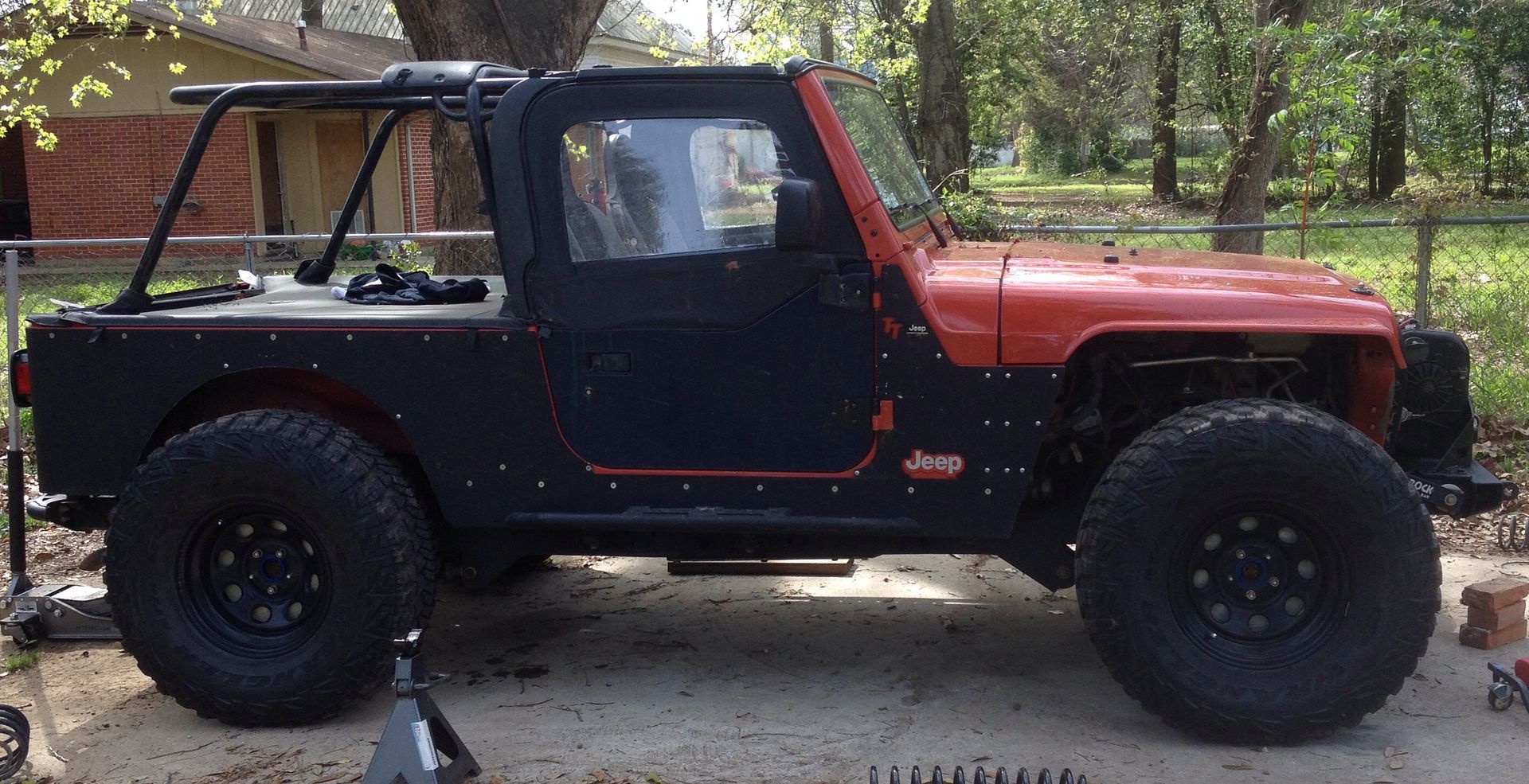

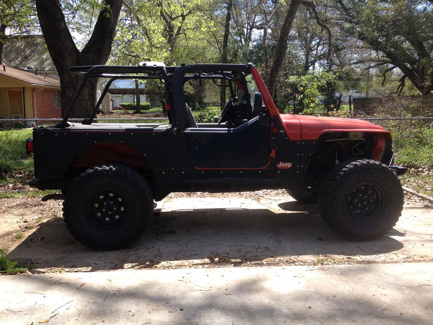

I put one 934 front springs on the jeep this morning and removed the saggy stock springs and 1" rubber puck.
At full bump
And now.
Looks like it is level again. If the spring sag, I'll put the pucks back in. Front ends picked up just at 2+ inches.
And since I have got a lot of PMs asking this, my front bumpstops are stock, rear are 1.75-2" over stock (guess since I have those aev deals back there). If I didn't have the ucf engine skid, I could lower the front bumps and the rear would hit everything if it moved any higher (tub mostly).
