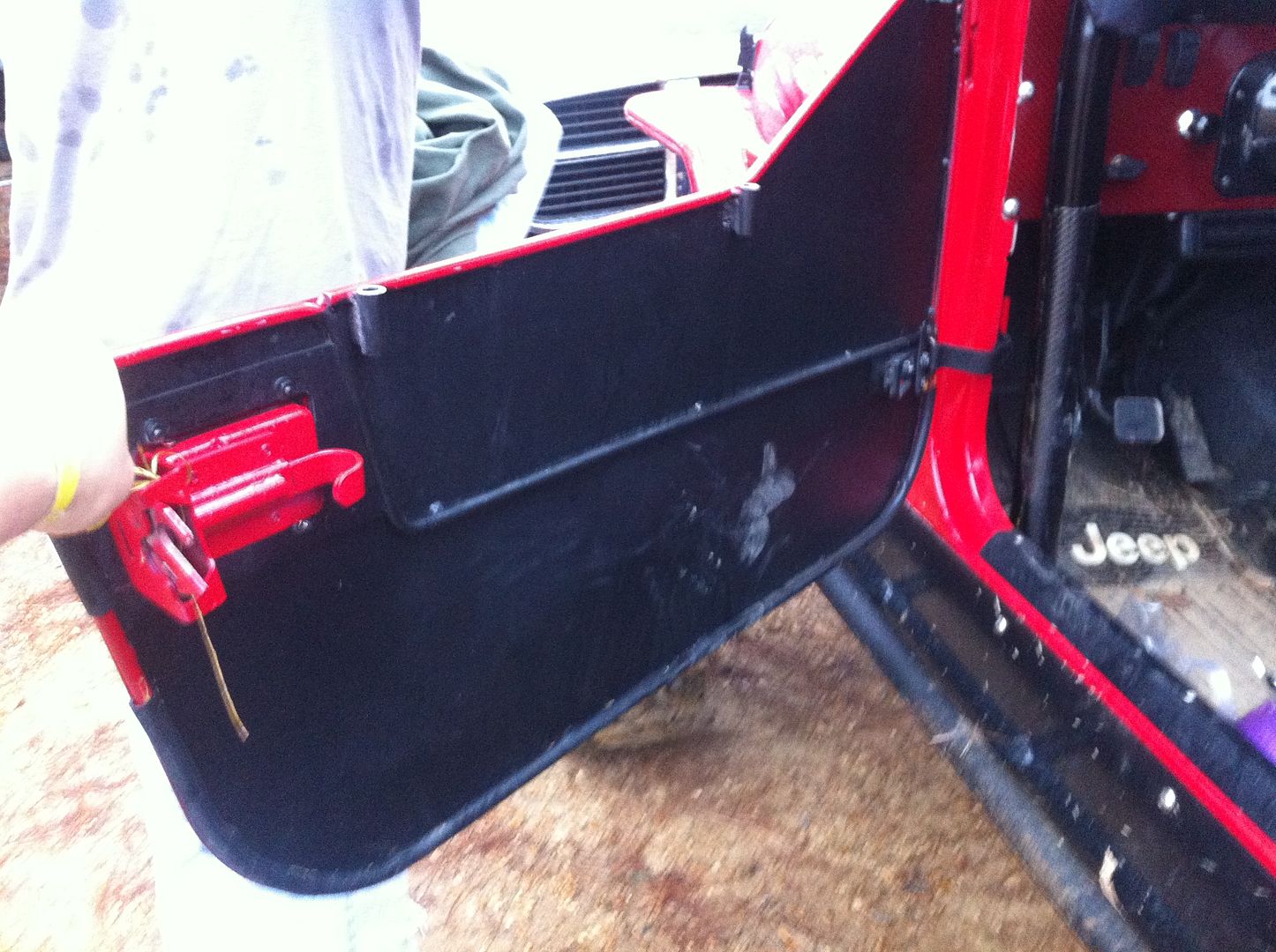

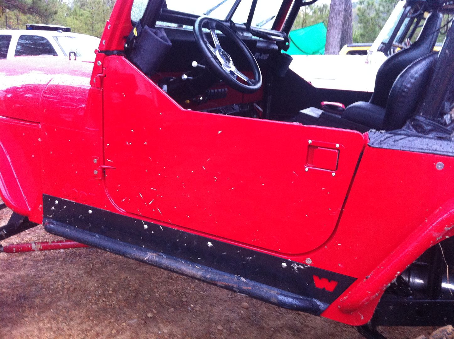

I like the idea behind DV8s doors that use a stock upper , and I just so happen to have a 5' by 5' piece of aluminum left over from my tonneau project .
I guess I missed their press release on the doors aka I haven't seen them yet.
These are the ones I saw this weekend.

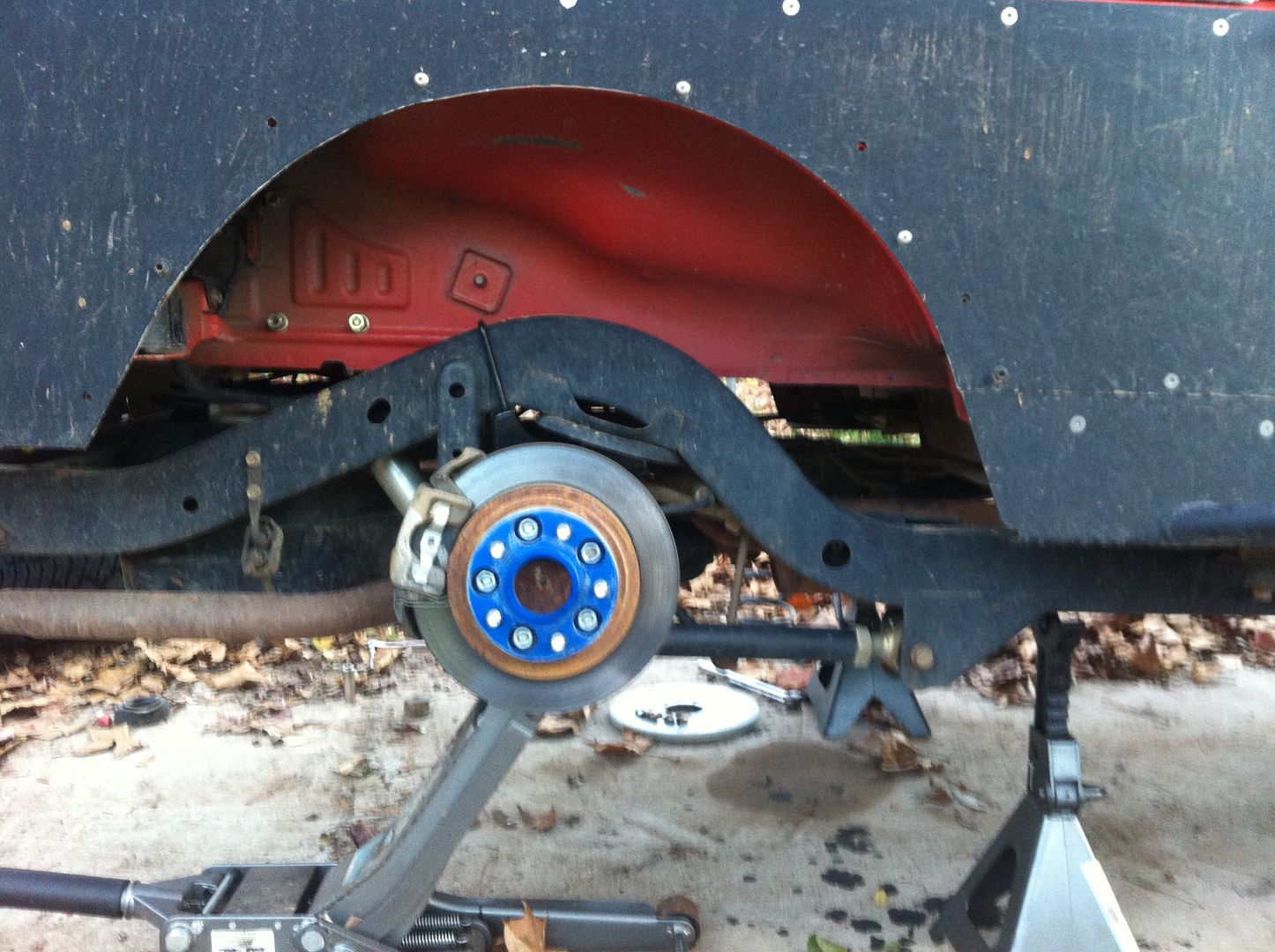

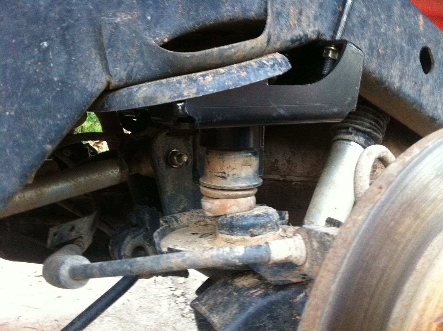

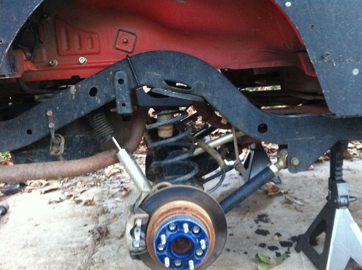

Added some AEV coil dealios this weekend and reset the bumps since the poly 1" spacers completely failed in about 500 miles (no pictures but they just basically fell apart).
second flex.... pushing the joust in.
droop
I am sitting .5-1" taller in the rear than I was before. Maybe it will settle some more. Someone is coming is a few minutes to buy the old rear bumper/tire carrier. I figure once I put the tire back on the back of the jeep, it will sit level (or close enough for me).

See in the first and third picture above how it is a U bolt that wraps the frame. The set before used 2 bolts per side (3 were unusable) and a piece of metal to use as a strap to wrap the frame which was bent to sh*t for both sides. The previous set also didn't come with a 1" poly spacer (see second pic above) that allows to relocate the stock bumpstop to the height it is set on. I was able to mount the stock bump stop (before) but it was not in the correct place and the spring was very loose when it didnt have the vehicle's weight on it - which is why I removed the previous set and went to spacers. I replaced all the hardware in the first set and sold it on here for a lose. This new set up cost about half what the first one did and was delivered to me.
