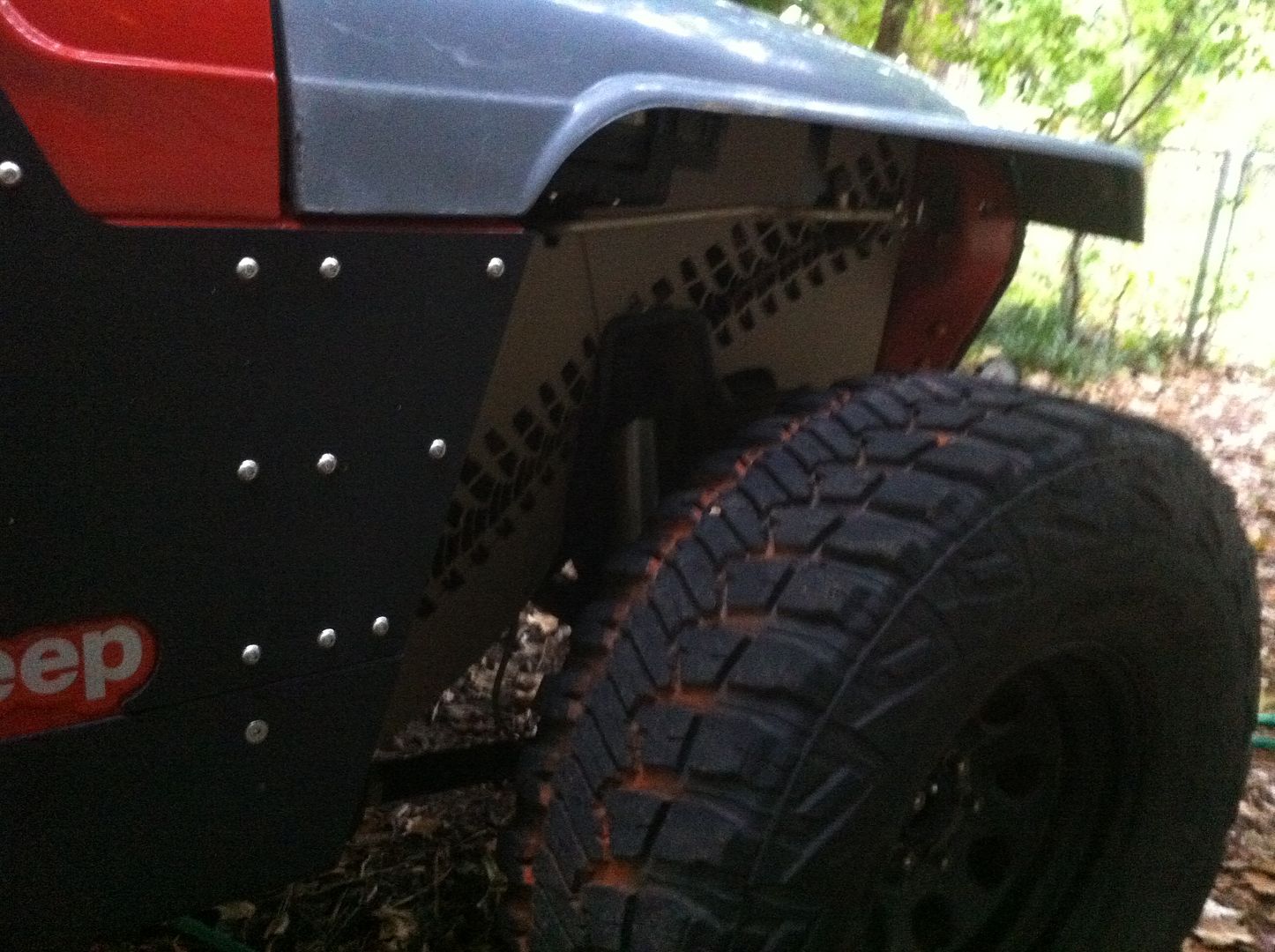

Thanks. Sh*t, I will be cutting mine out tonight for another fitment and sending the cad files. I don't know if you can cut this design but I have a back up plan, just let me know. I will give you a hint, they are complicated air holes.....
Hmmm...dimple dies? Sounds good.

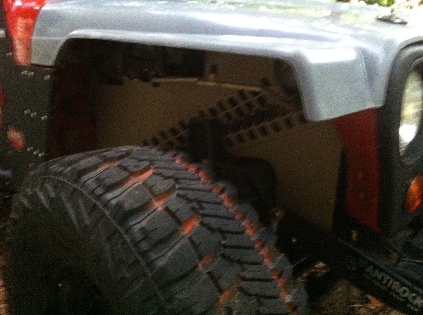

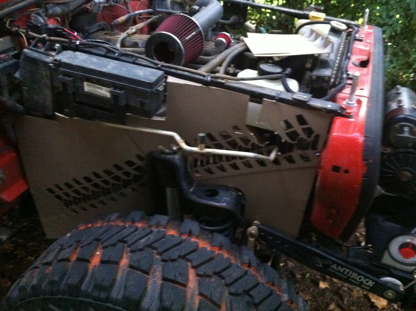

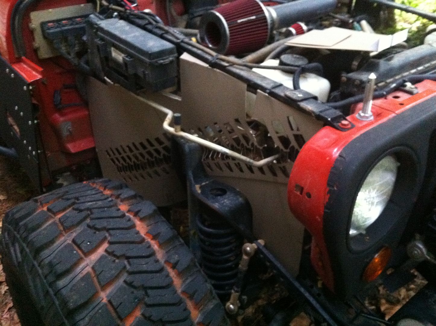

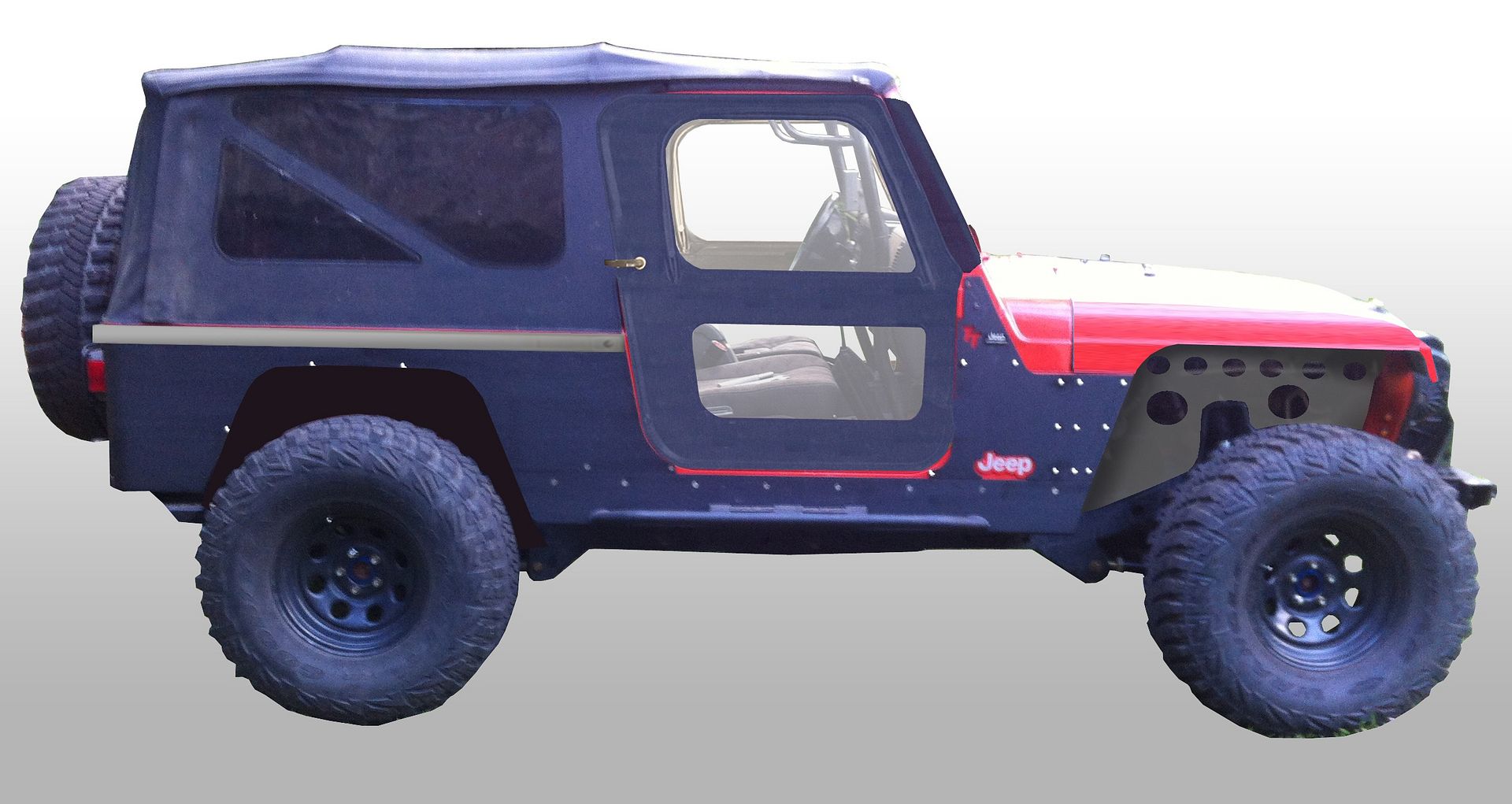

That is the back up plan..... Please excuse my ugly craftsmanship this morning but here is the rough idea.
I would move all the electrical stuff and the panel would be completely flat and in the same plane as the strut above. A piece for the grill and the firewall would be made and the middle piece would mount to those (you can see those two other pieces sitting on the engine in the first pic). The middle piece would be attached with some bolts and could be removed for cleaning or maintance. Now I need some opinions, should I continue or go back to the drawing boards?

i like the inner fender design. creative but not too obnoxious i think, especially if you painted the inner fender a darker color. should also help get some heat out since you wont be putting the louver back on

I could do that design...but it would take more time for my guy to program that which is more $$$. We'll chat once you send me the file. I think some simple little holes would look a little better but thats just me.

Here is the original idea with dimple died holes.
Some ~1.5" holes across the top and two slightly larger ones just in front and behind the shock/spring tower.
I will send the files to you today and we can discuss after.

cool to see you got out and did some wheelin!
Are you against a solid inner fender with no holes? I just see those as a way for mudd and water to get into the engine bay.

Yeah, it got me back into the jeeping spirits and was a good little run, already looking forward to the next one. I don't mind stuff getting the engine bay.... And it is open from below. The cleaning last weekend wasnt bad.
The inners are for some protection from large debris like rocks, engine noise baffling to others around while dd-ing (quite loud without), for something that will visually make it look finished (as opposed to seeing the engine all the time), unique and the holes will help with engine cooling. Mostly, I am looking for something unique and the cooling.
I am not opposed to no holes, but that is the last option. I have recently found a guy running the same hood with a similar louver to the one I had on it for a while without issues, so that might be an option too.

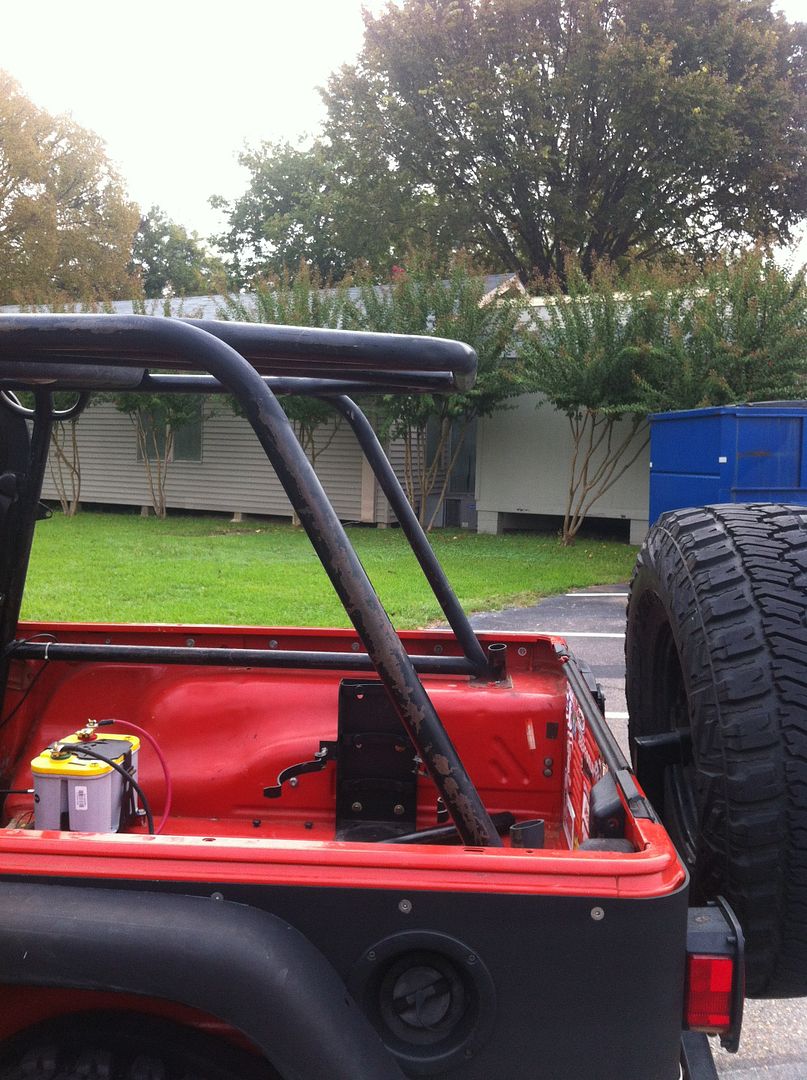

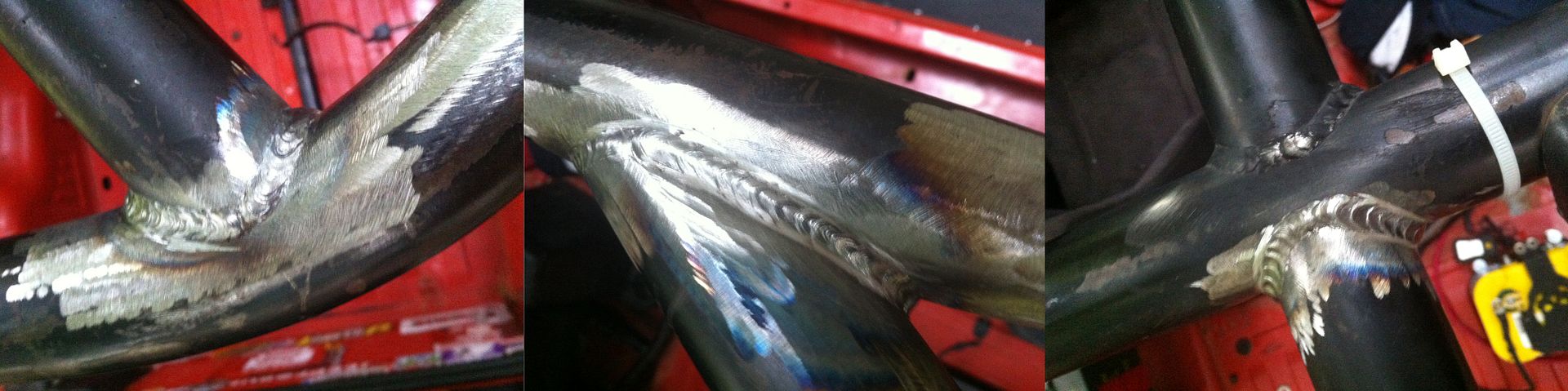

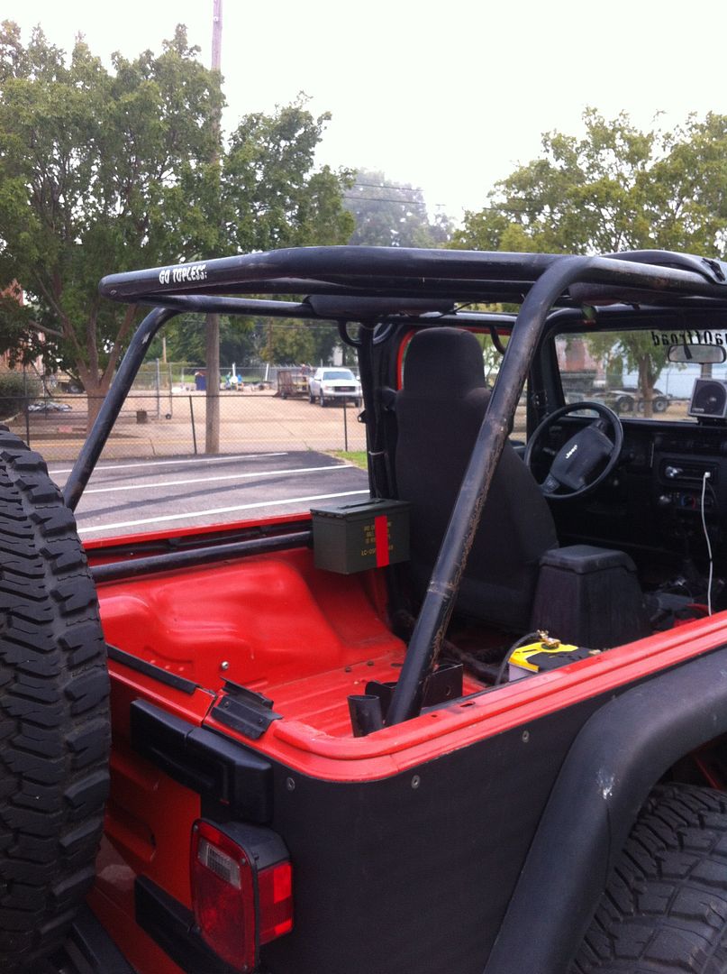

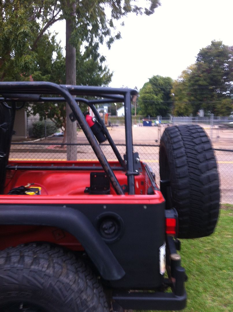

Chopped the cage down some to fit a hardtop on. After the seats are changed out, we will be adding more triangulation. This guy knows what he is doing and we will be doing business for a while. He met me at work, picked up the jeep on his trailer, took it to his shop, did the work, and returned it before I got off work. I know it isnt a lot of work but I was happy with the service.
before
now
You can see the bases on the bottom of the tube that was removed off the rear. He drilled thru the base so it wouldn't collect water, but it will be completely removed later when the cage is pulled after the next round of the cage.
welds

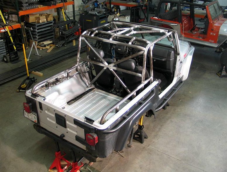

Build a cage like this... It's bada**

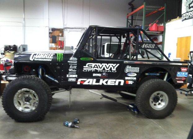

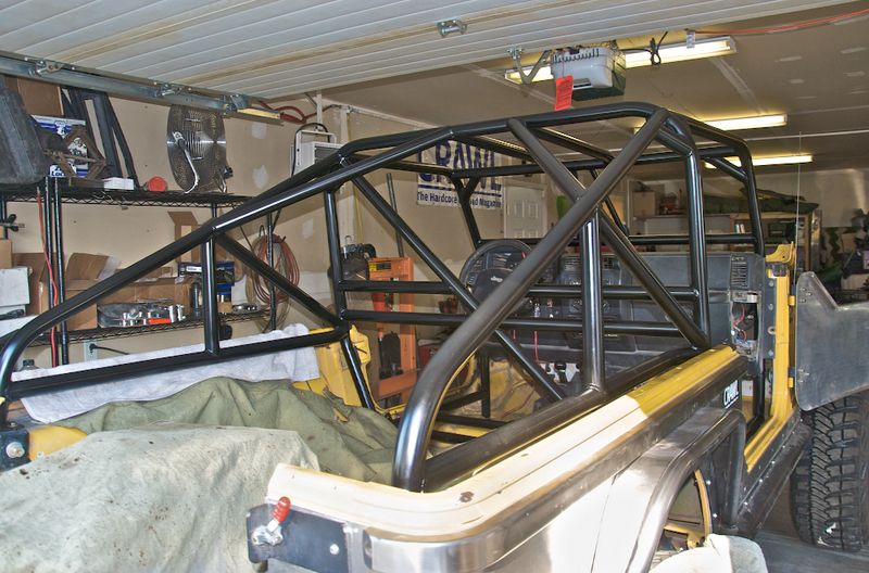

It will be similar. Haven't decided yet but between these three LJ cage ideas...
Probably just pull a bit from each, but we will see when we get there.
Rokmen's freak
Crawl's LJ
Savvy's blackhole
I like the unobstructed bed and the double tube from B pillar to C pillar on Rokmens along with the X in the B pillar and the side profile proportions are very nice. I like the CJ-esque down sloping bar on the crawl rig but dont want to have that much tubing and the spare tire location is pretty ideal too. I like the X bracing in Savvy's LJ and the aluminum tonneau they create.... just my thoughts currently.
I know the work I had done yesterday will be removed with any of the ideas shown above, but I need the work done and wanted to see how good this guy is.
