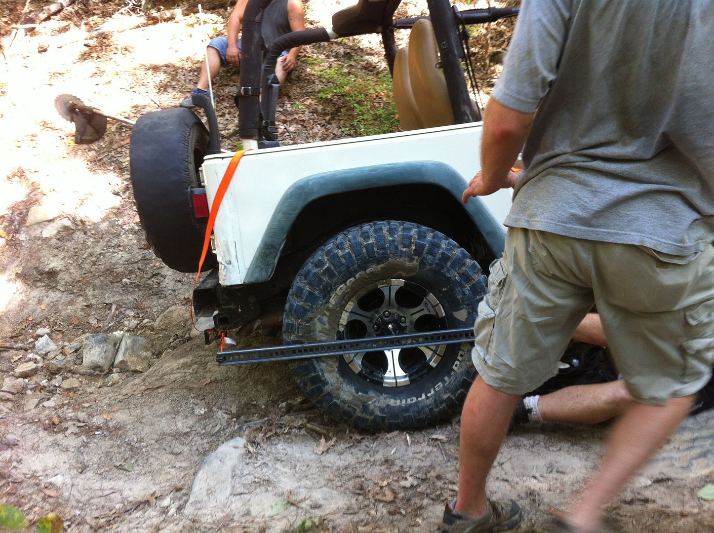

The work day weekend was pretty awesome and we got a lot of new trails cut. There was even a good learning experience when it came to wheeling a d35. Bone stock 98 tj on a level 4 trail made it up half way.... 45* or better with rocks bigger than their tires..... snapped a rear shaft standing on the throttle, ended up breaking a banjo bolt on the front end, and massive rock rash..... This is how we go it off the trail. Started with high lift handle and ended with a tree trunk strapped to the frame winching 10' at a time for 150'+.... Took over 3 hours and about 7-10 people to get it done. Did I mention we could only winch for 10' at a time because it was a narrow windy trail and we were using snatches to manure between the trees.... Fun times. Lucky they brought a trailer.

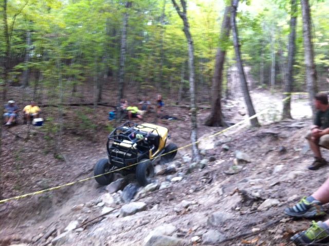

same trail in the competition 2 years back.... this was the class above me. Here is a juggy racing up the same trail in almost the same spot.

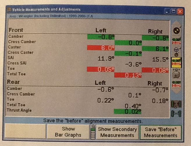

So here are the measurements from this weekend. I know the toe is wrong. Bad Vibration at 55, I think the wheels are unbalance (due to sitting and I am sure I have the rotation off by now). I think the SAI was off due to a tire being mounted in the bed on driver side and the relatively new springs (have about 500 miles total on them, including POs mileage and have been sitting for 8 years on a shelf).

Since the last post, I have been having some wheel balancing problems to say the least. Brought the jeep to my guy who did the original dynobead, wheel, tire install 22k miles back. He put surface applied wheel weights on the inside and out... He said it was the only way to re-balance them. Looks bad and was still wobbling till I rotated them a few times. Seems to work well now.
I looked at the steering since the alignment rack said I was a bit toe-d out. The currie correct-lync steering is designed to work with a ~4" lift, so at the shortest adjustment, I wasn't adjusted correctly, plus my wheel was at a 45* angle which was messing with my head while driving. This weekend, I took about a half inch off the drag link adjustment sleeve and half inch off the tie rod. I re-installed and did a 1 man alignment using the most random items to mark a line around the circumference of the tire in wet paint.
