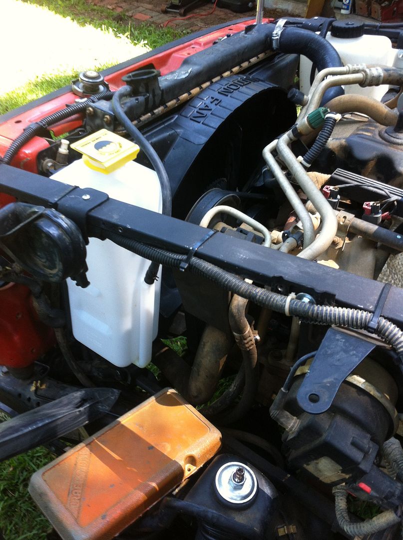

installed the shroud and overflow bottle. We ended up removing the radiator to get the shroud in. Marked and drilled the holes up 3/4" to allow the shroud to drop down 3/4" which is all there was room for. I would have liked it to go another 1/4-1/2" down but the fan blades didn't hit after the jeep was started.

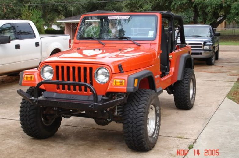

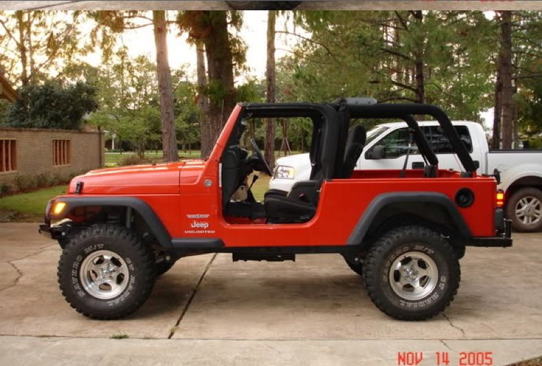

And just so you all can see it years ago before I owned it...... Found these on JeepsUnlimited a long time ago.
ThrowbackThursday...Friday.
I think all that was done at this time was bumpers f+R, lift, tires and wheels. That front bumper looks nothing like that anymore.... just hacked up haha.
But the hood is Orange
