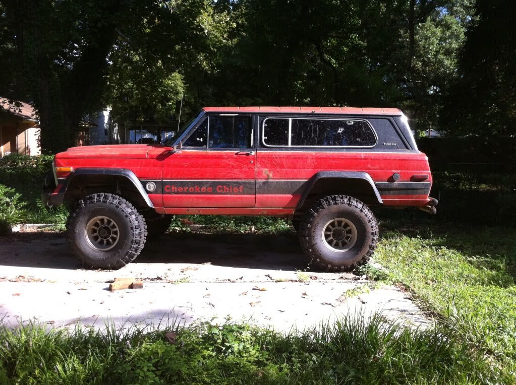

post #840 of 1924 Old 06-06-2013, 07:50 AM Thread Starter
dayriesw
dayriesw's Avatar
1987 MJ Comanche
Location: Louisiana
Posts: 6,140
Originally Posted by jeeplovin View Post
I really like that you use your Chief the mud makes it look good...
Thanks. I thought the two bullet holes in the rear driver window was a nice touch too. I have wonder about the story on those for a while.
