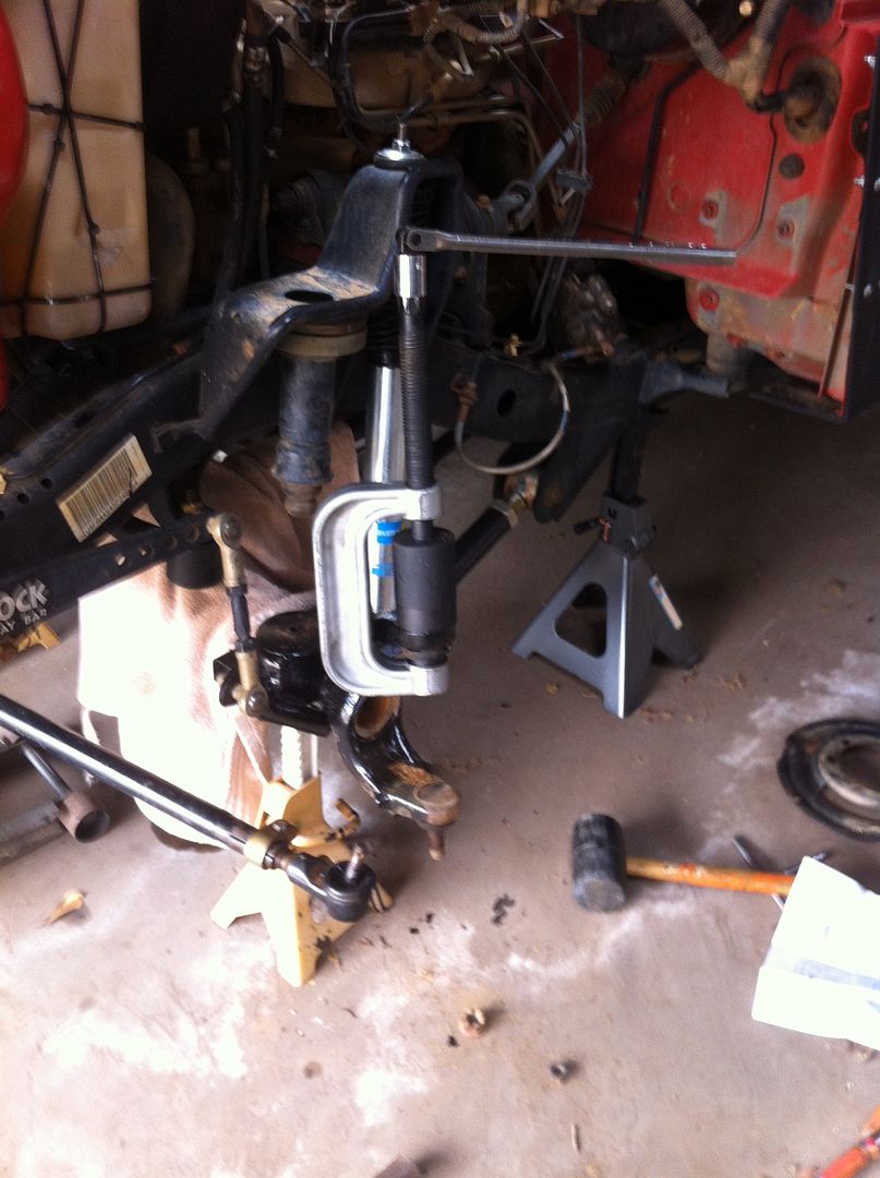

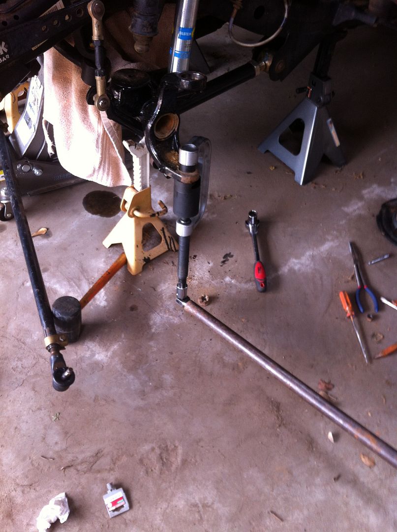

Made a little progress today. Removed the knuckles and ball joints.
Upper go first. This is using the mopar adapters GB mentioned above.
Then lowers. It really helps to have a 4' breaker bar and room.

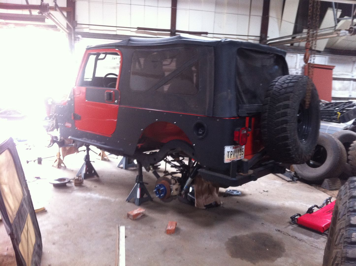

Then I removed the rear 44 cover because it either loosened up or the lube lower just gave out?? Because there was fluid all over the floor. Fluid was cleaner but I like to change the dif fluids on the same schedule.
Floating jeep

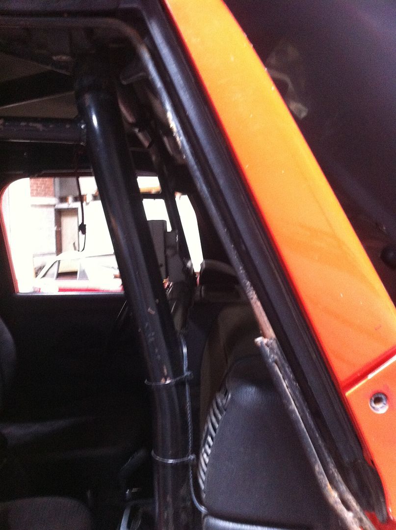

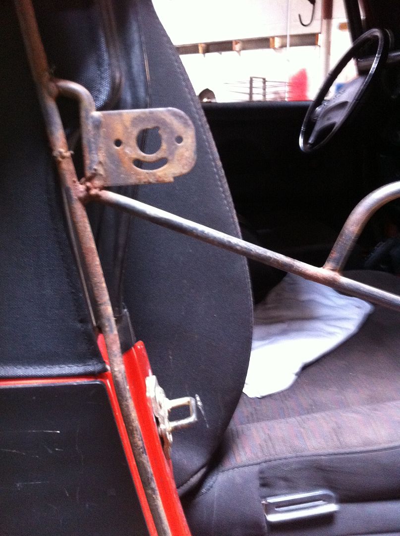

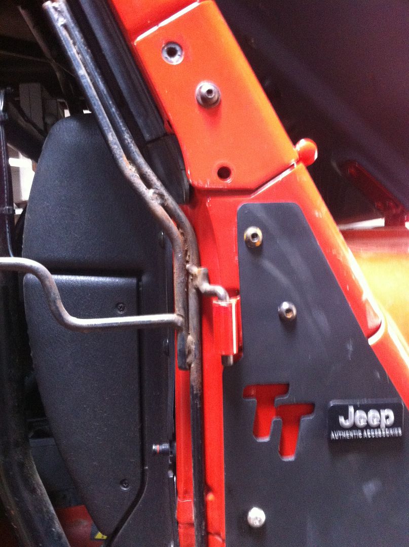

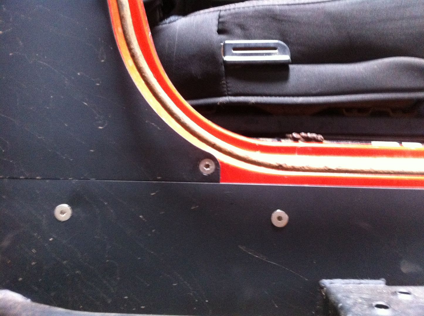

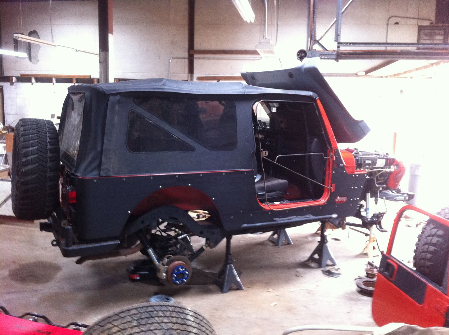

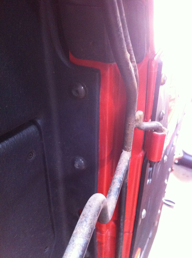

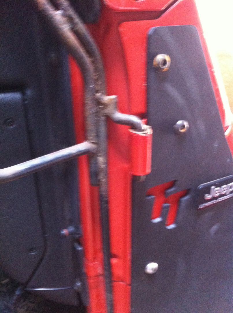

Then test fit the door on the passenger side. I removed the skin since that side's skin was pretty destroyed. Anyway, here is how it fits. I'm posting close pictures in case anyone else want to try. These should show exactly what needs to be changed.
Both of the 'z' hinges are going to hav to be cut off and welded in different positions.
Holding the door shut, the windshield is parallel.
Then problem area.
The rest is fine.
