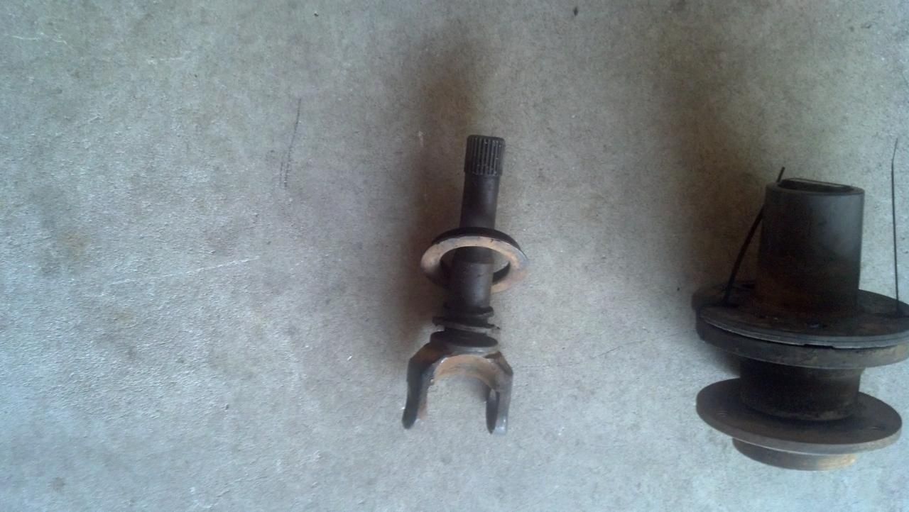

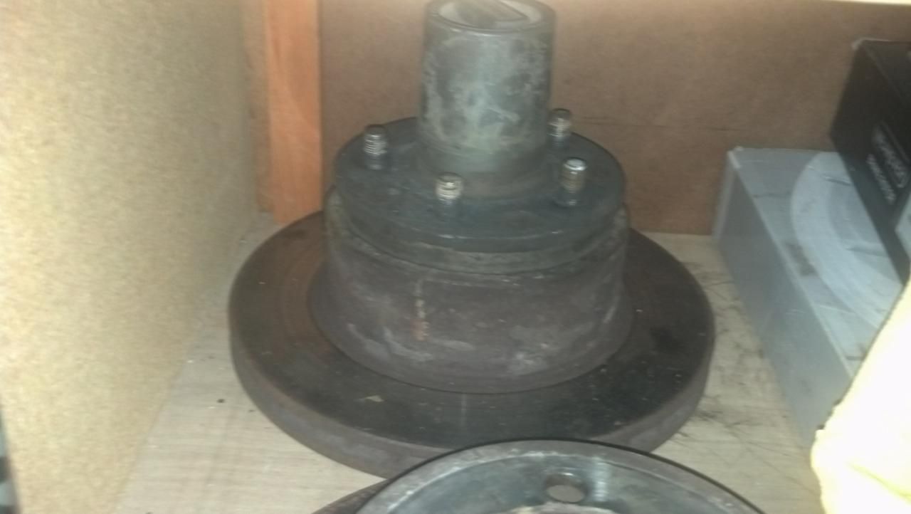

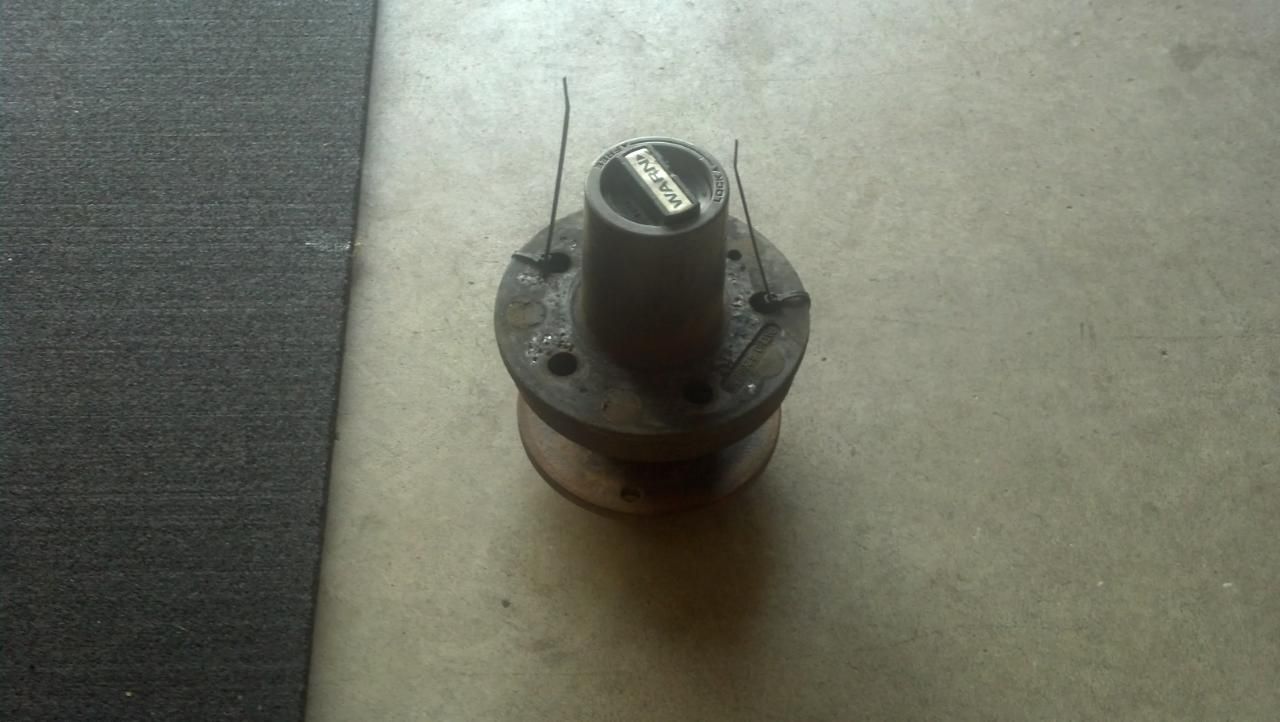

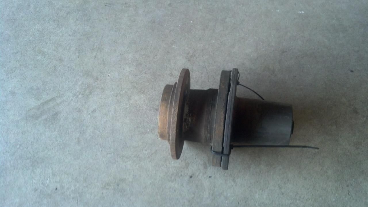

If it is the unit bearings, this is the pictures of what I am in negotiations with someone about.
http://www.jeepforum.com/forum/f9/wa...bs-tj-1519002/
Here is his pictures.
diagrams and part list
The gentleman said that part 8 on the above diagram is broke and that he does have the two disk brakes that will be included. I have look thru the pictures but cannot really tell if there is anything else missing. Can someone else see anything missing? Otherwise, I will probably pull the trigger on these and replace the part and install asap. I have always wanted lockable hubs and the outers are chromo (IIRC), so this should be a pretty good upgrade. I will buy a set of hubs to carry as spares after all is done too. And this should give me a little bit more piece of mind for wheeling longer distances away for many reasons.
