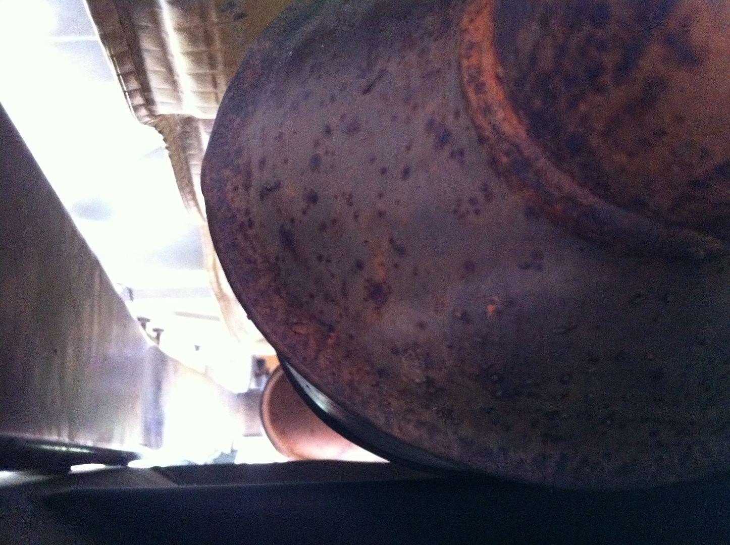

After it was painted, we put the belly skid back on multiple ways. First we bolted the skid to the frame and couldn't get the new trans mount to get into shape. Then we tried bolting the skid to the trans mount first and the frame bolt holes would not line up. We did get the skid up high and noticed the tub was contacting in a few places.
Above the driver side on tc
Same shot, different angle
It also was contacting just above the 3rd cat. After we saw that, this fell out....
Then a hammer hit here and there.
After I removed the heat shield, I realized I couldn't jamb, hammer or manipulate the tub enough for what I was needing.
Them as we ran out of light, I was thinking: the skid will mount up to the frame but won't line up with the trans mount (with the exhaust hanger installed) and will line up with the trans mount, but them won't line up left to right. The exhaust is completely stiff in it's place. I think tomorrow we will mount everything up without putting the exhaust hanger in. If everything fit this way, I will take it to an exhaust shop to remove the third cat and reinstall the hanger and get the hangers height shortened after the jeep in on the road.

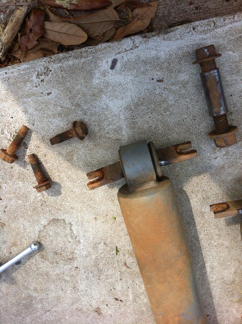

We also removed everything but the links off the rear axle. What are the things the top of the shocks called? This one is slightly tweeked but the other one is perfect. Do I need to replace them or can reuse and how do they get removed?

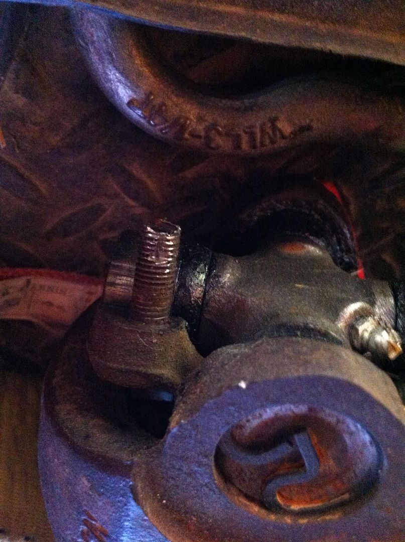

Also, the front transfer case drive shaft bolt was stripped and slightly loose before we started yesterday so I used a cutout wheel to remove it. How can I remove this?

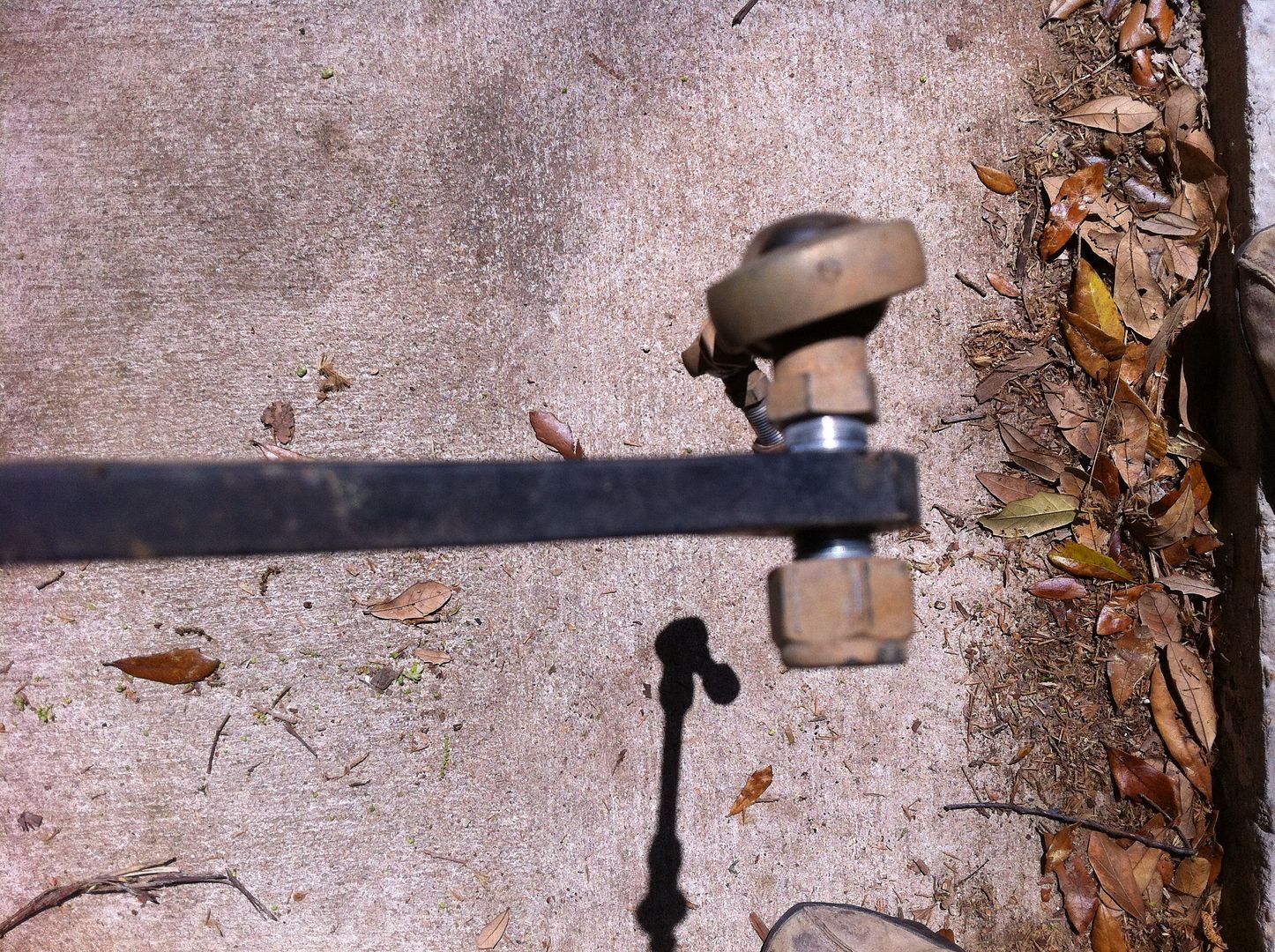

And my front ar 'wing' is pretty twisted.

This is a bar pin , mine were bent from over tightening . I re used them and have had no issues .
You should be able to clamp some good vice grips to it and turn it out .

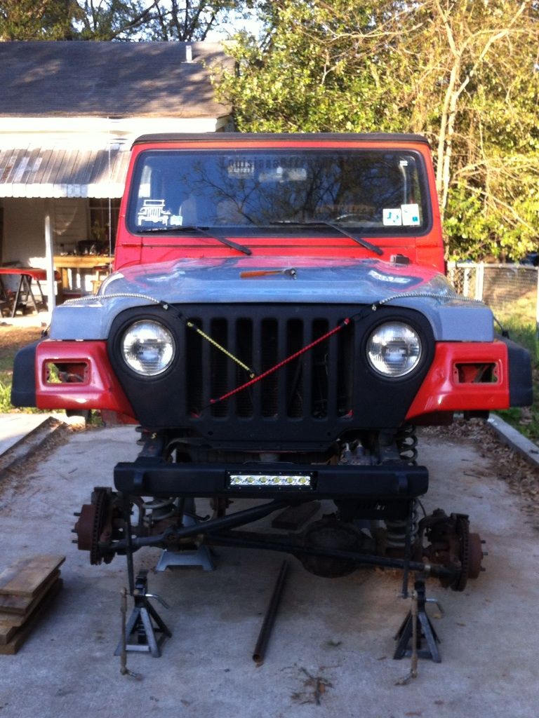

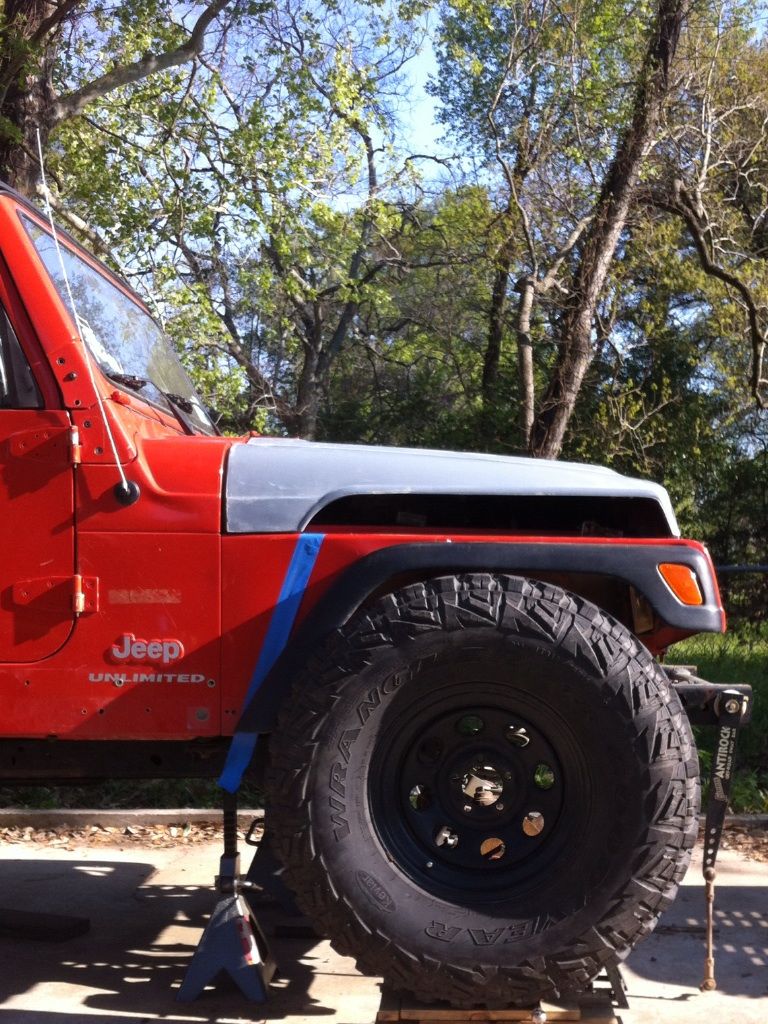

Got the hood mounted and finished the mods for the front bumper/light. I think the tire will sit a little further from the body in the end. And the hood is sitting a touch above where it will be in the front because the hood's fenders are contacting the top of the factory fenders. The hood had a few scratches and dings around the edges because the packaging came open in shipping.

The hood looks awesome .Are you going to cut the fenders along the blue tape ? Are do you plan on making a filler panel ?
