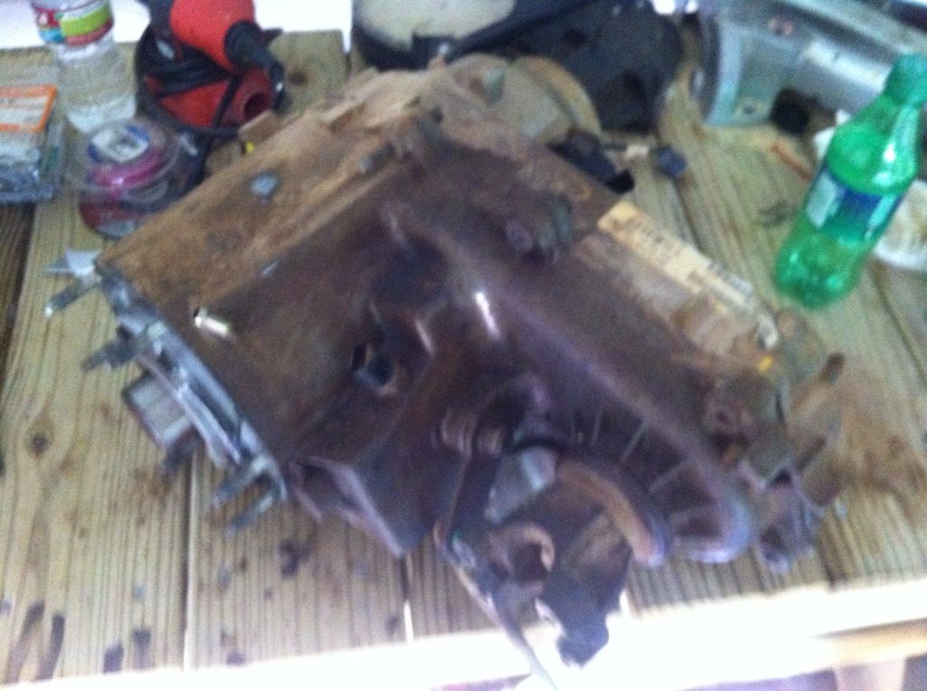

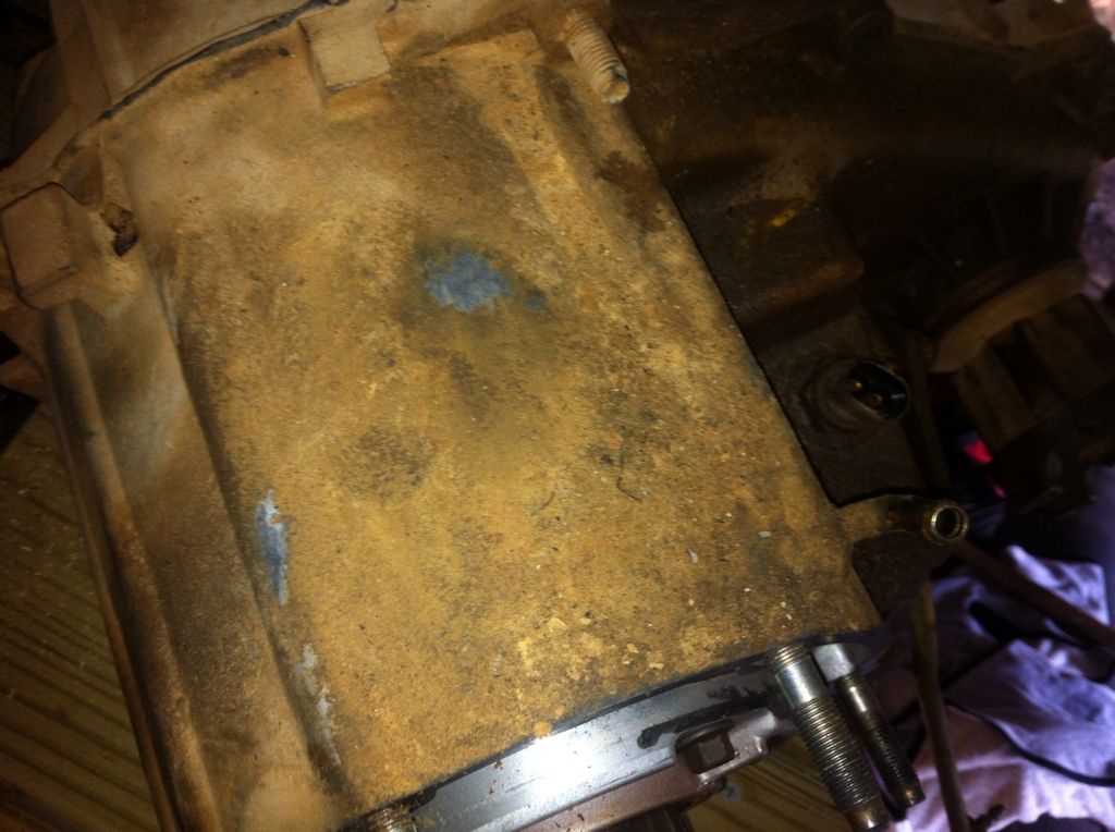

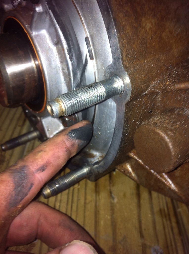

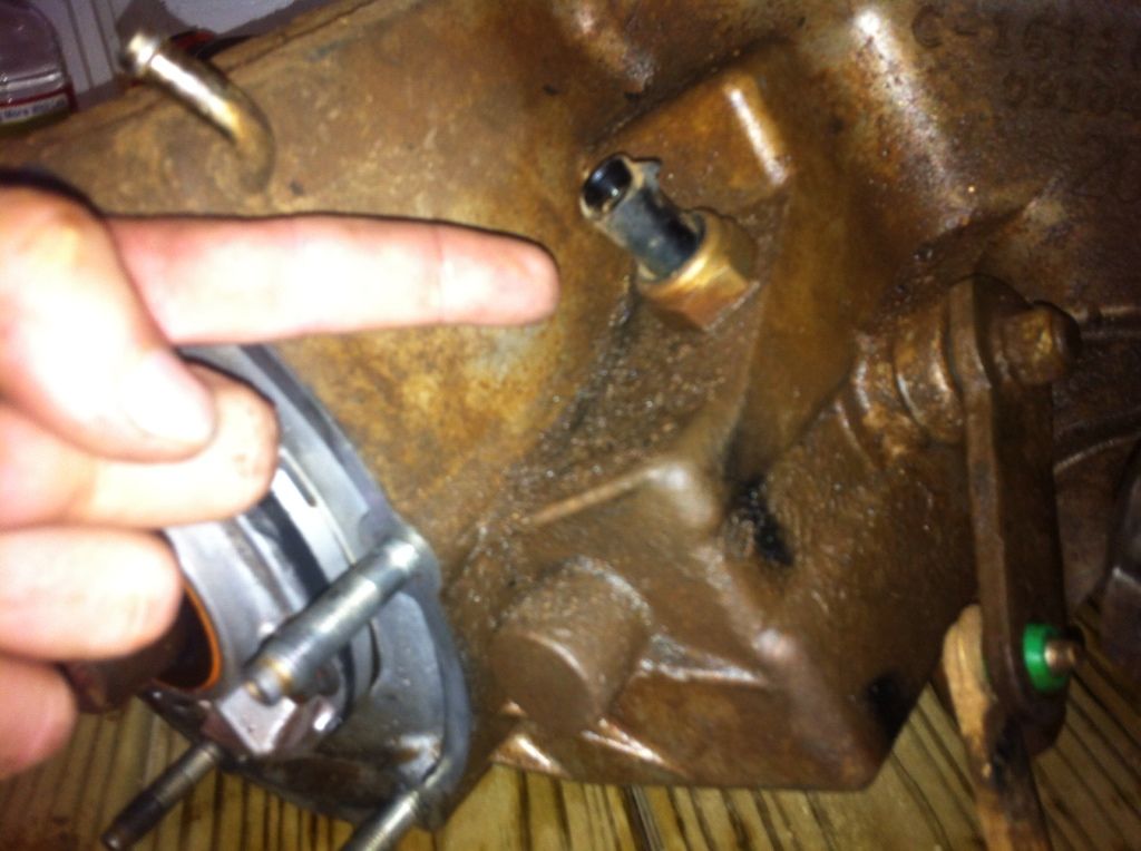

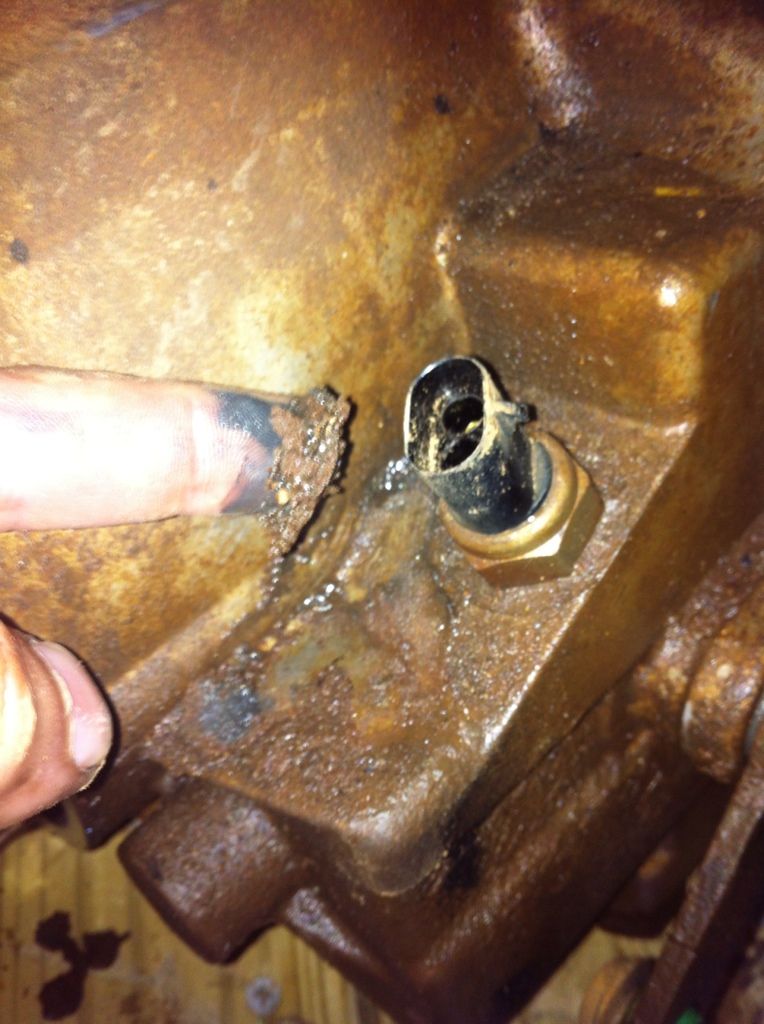

Well pulled this puppy out. The leak is not obvious to find. I think it is from the frontward electrical plug in that I am pointing out in the second to last picture.
I didn't want to clean the muck off yet just in case I could see where the leak is coming from. Unless someone notices something that I have not, I think I will clean it well and fill it up with fluid and turn it over to see where it is coming from. Anyone have any ideas?
By the way, dropping the drivetrain down HELPED so much!!!!

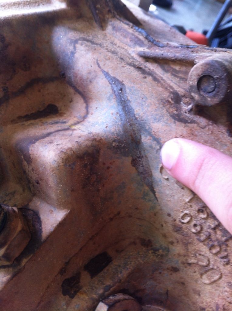

Cracked. Can this be welded back together?

Yes, tig welded and you will need nickel rod or something else very expensive if you want to do it 'right'
But I would just try some bronze tig rod. The area you need to weld isn't a high stress point really. And it depends in how well you can tig weld.
He can actually stick weld it easier.
OR, just replace the case half.
I don't know much other than what I've read about stick welding cast. So I recommend what I've done myself.
It seems 'easy' enough to stick weld cast, but I'm not sure of what type of welding he is capable of.

From my research, this is a cast aluminum housing that will need to be baked and welded. Found someone locally who will do it, but have not got a price yet.
Or Davey's Jeeps has a stock 231 with 42,000 miles for 150 plus shipping.... and then all I would have to do is swap the sye over.
Local 4wd shop said 205 plus shipping for a new front case half plus I would need about 60 in bearings....
It's probably baked just to pre-heat, then welded. Not that hard unless you've never welded aluminum or cast before, haha. It's tricky.
Good luck getting that puppy fixed up.
