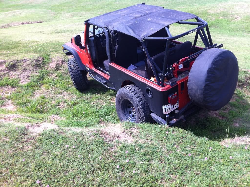

A quick shot from yesterday

Nice flex shot , almost looks like the rear of the tire is into the armor ? I think I am going to follow your lead and get the Rokmen armor . Any regrets or suggestions ?
The tire is just into the armor when the tire is fully aired up. I am waiting to trim it when I figure out my new ride height and rear fender selection...... Or just when I am less lazy.

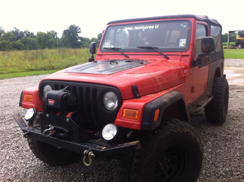

The LJ's two year (with me) birthday is tomorrow.
On the dealers lot
Today, how it is after 5 minutes of little mudding last night and a rain wash.

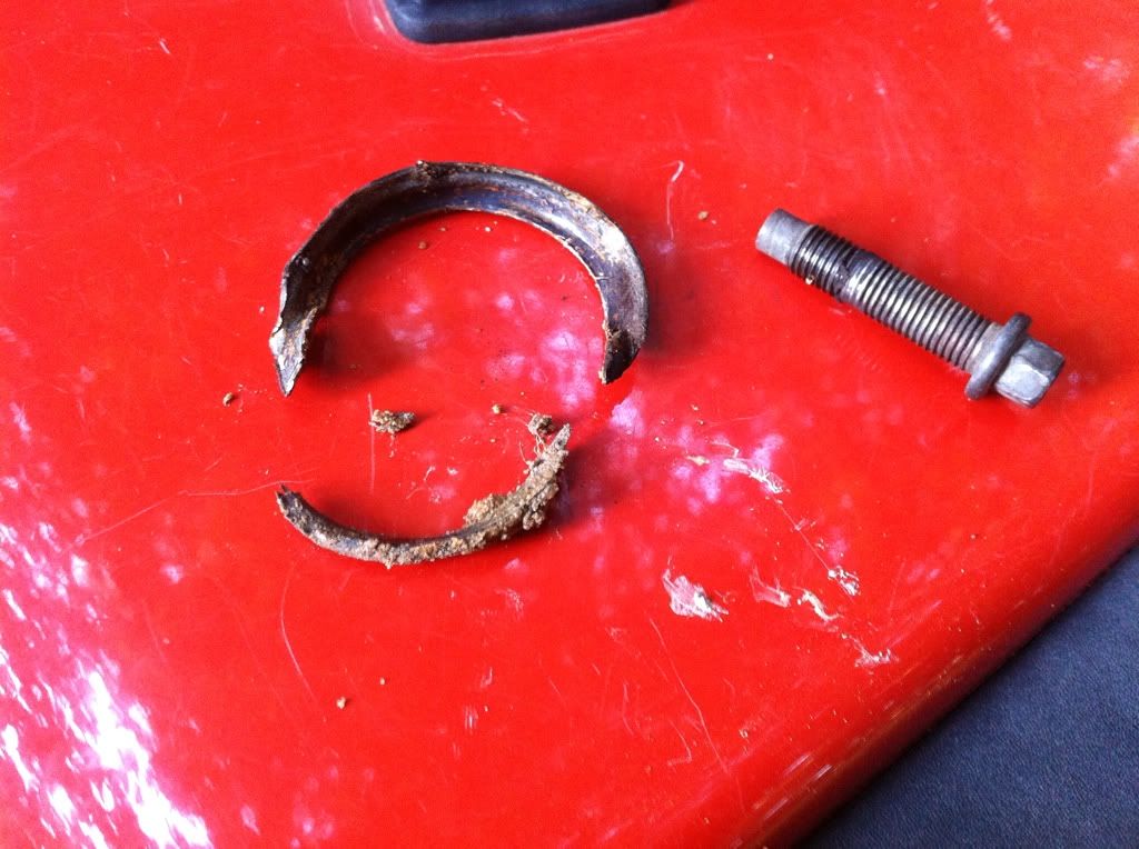

Yesterday as I was pulling into work, the jeep started making a very loud "chirping" bird sound coming from underneath. I thought it was the front drive shaft on its last leg, I put my hand under and moved the DS showing a lot of play. When I left work, It was really loud on the way home and gave me a horrible death wobble. I took it to the car wash and then home. I went to pull the front ds and found a lot of oil and this laying in the skid and a LOT of oil on the 231.
I guess the camping/wheeling trip is off for tomorrow. Does anyone have any tips about removing the 231? I have never done this before. I am pretty sure that I drove the jeep home without fluid (might have leaked out all day, I park on gravel). I am removing it to check the internal gears out.

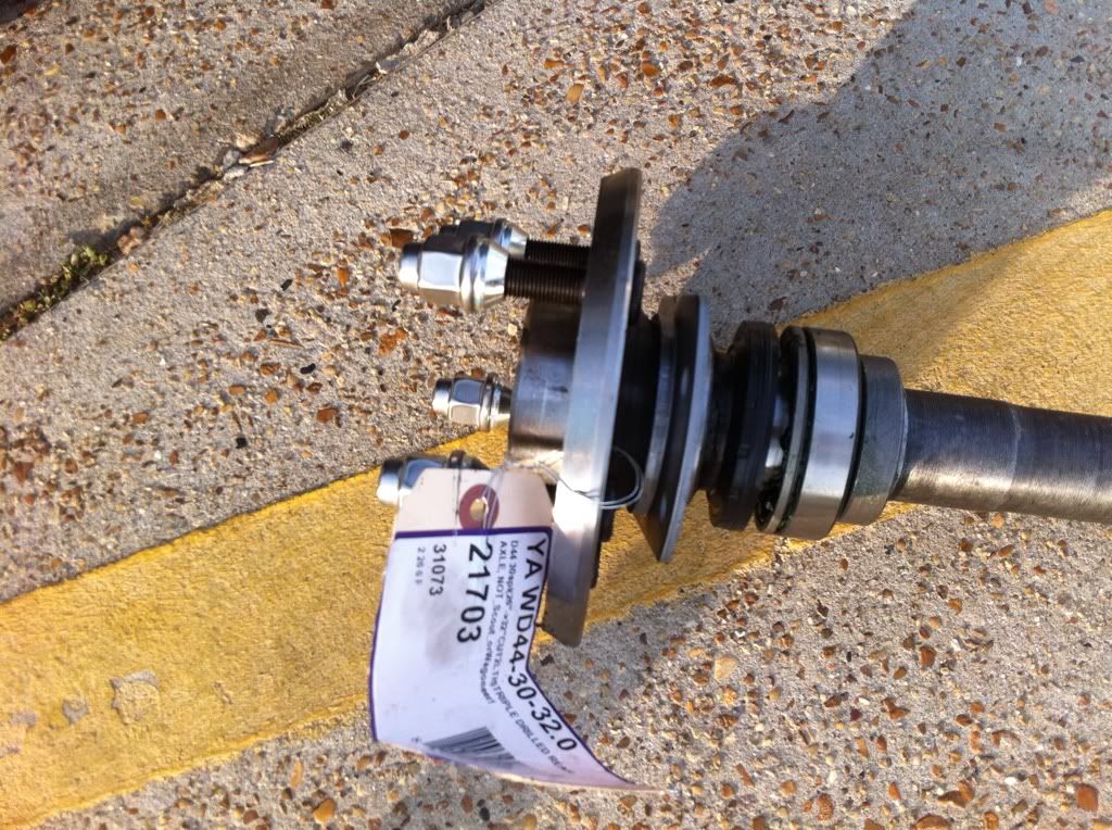

But I also went and picked this up this morning. I had to use a different shop that usual. I has quoted about $60 for parts (flange and wheel studs) and labor. They tried to invoice me $180. Needless to say, it was the wrong day for that.

Mostly frustrated. I tried to drop the t case myself and got it almost out except I could not get the top bolt out because of not clearance (if I do this again, I think I need to loosen the engine bolts to let it drop?). I then put it together and took it the transmission/transfer case shop. They took 6 business days while calling me each morning saying it would be ready that evening.... When I picked it up, they would not give me my front drive shaft, which turned into an argument that I won. Took the jeep and drive shaft to a different shop the next day and while under the jeep with the shop manager we found that the t case is still leaking. They are lengthening my front shaft by about an 1". Took the jeep back to the transfer case shop and crawled back under the jeep with the owner, who could not find the leak (because there was a lot of fluid with even some blown on the rear axle). He cleaned it off and I am bringing it back today so hopefully he can actually fix it this time. He said they replaced all three seals (transfercase to transmission, front output and rear output), but it seems to be leaking from the same spot. Anyways, I believe I have learned a valuable lesson hear which is do your own work. I am slow but it I could have gotten the t case removed I would have finished the job is less time and less frustration. I just wish shops would tell you the truth instead of what you want to hear. We will see if they stand by their work or what this afternoon.
Some good news, with the front drive shaft removed I had no wobble at all. I am hoping it will have none after it is lengthened and reinstalled.
