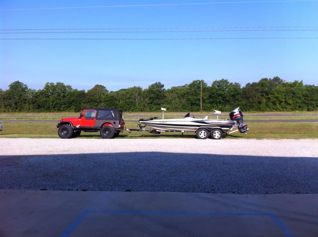

Thanks B2. Been thinking about this a lot. It has always been in the plans, but the swap was supposed to be later down the line...
Springs sagging about 2"
