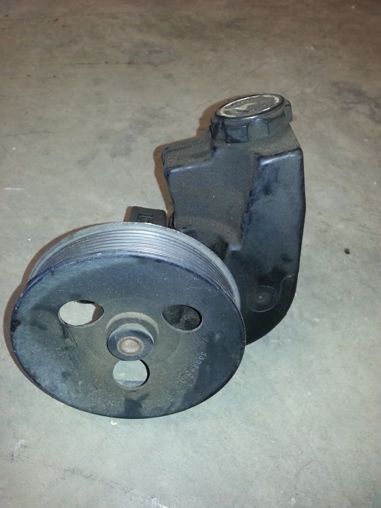

Originally Posted by SH00T3R View Post
Do I need to swap the pump also or can I just snag a bracket?
Here is s shot of my cherokee pump. Hope this helps if not you could always call auto parts store and ask if they have they share same part number. Mine needs a new reservoir the po broke off the return nipple pulling the motor out.

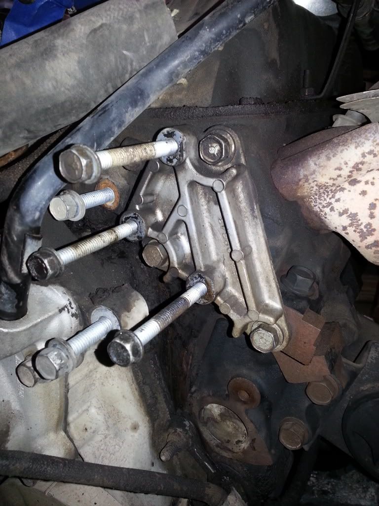

Originally Posted by bmgadg View Post
Seems like the cherokee pump mounts to a small bracket that mounts to the right side head.
Correct here is the cherokee bracket.
