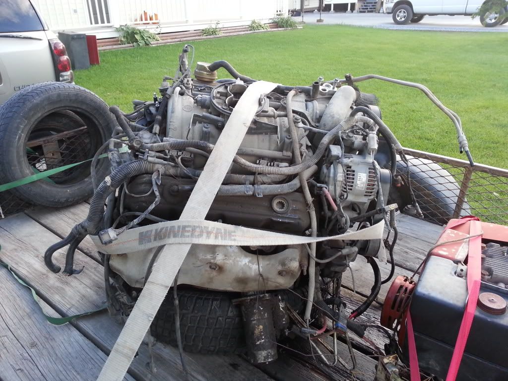

Heres a small update. I picked up my engine tonight! I got it a little cheeper because the guy I bought it from ran out of gas and I rescued him off the side of the road. lol So I got it for $380 with everything. Next up on my list are the engine mounts and bell housing and I should be one my way. I do need to pick up a fuel pump out of another jeep because mine WAS carbed. Any suggestions from the guys that have done the swap?
