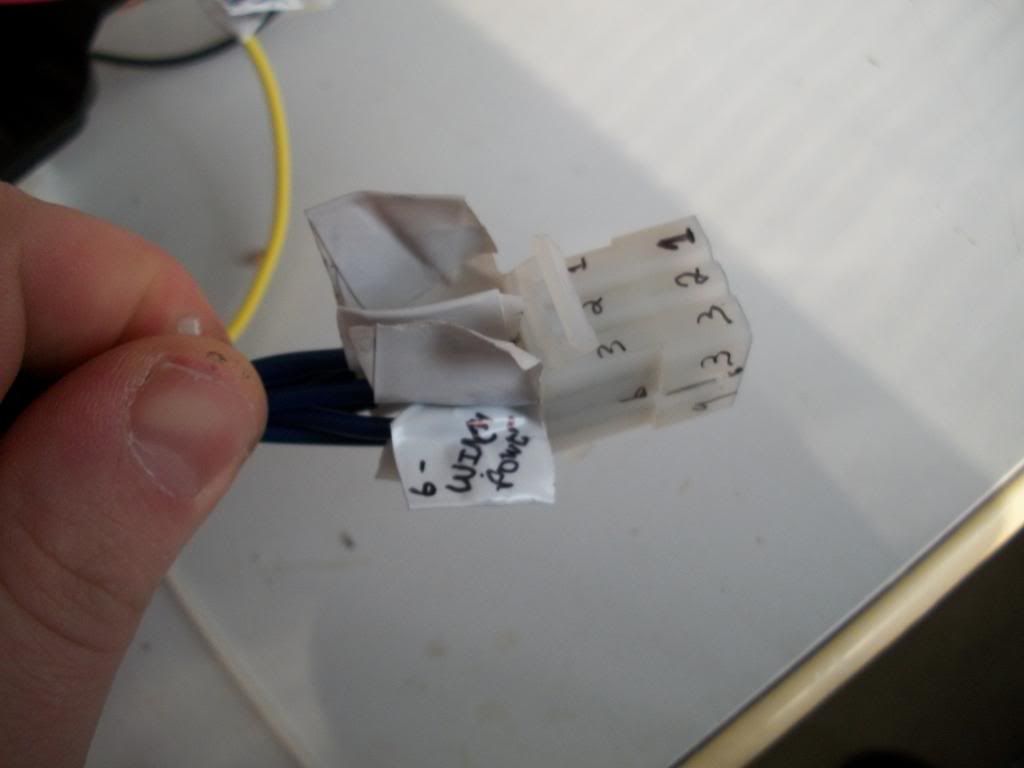

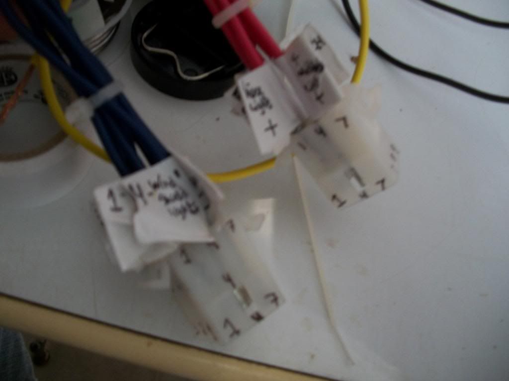

Here are the pics of the wiring I did. I jumped all the grounds together and go out to a single ground point. The yellow wires are all the switch lights that go to a dash illumination wire if I can find one, those are also jumped together as they pull minimal current. The Red wires are 12V powers coming in from the relays under the hood and the Blue wires are all the outgoing powers to each specific aux item. I put all the Power (red) wires & Aux (blue) wires to their own 9 pin quick disconnect that way if I ever need to change out a switch or pull the panel I will only have to unplug the two plugs vs. take all the wires out. Each wire is labed to which number pin on the disconnect as well as what Item it controls.
I then Ziptied all the wires together to keep them clean and managable when I finally install them on the dash.

I also labeled the harness as well to avoid any confusion.

Where did you get those connectors?
I got them at Radio Shack. They are a standard 9 pin male/female interlocking connectors, I bought 2 males and 2 females. They had a bunch from 4 pin to 12 pin. I figured 9 was plenty, gives me a few spaces for further accessories.

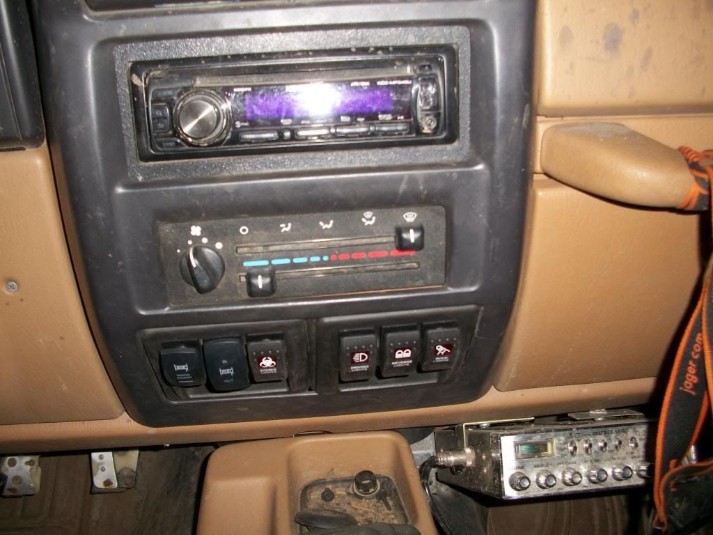

Got some pics of the installed switches. Now waiting for my u-joints to show up. I bought some for my axles and my driveshaft that way I have some spares (only because I ordered the wrong ones to begin with!)
