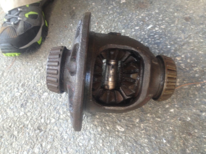

This has turned into quite the project.... I just got both front axles out and the gears out. There was mud inside my axle tubes and we found the seals were junk which we knew. I got all new seals and bearings already so now we just have to put it all back together.
But my buddy in his infinite wisdom, couldn't get a cotter pin out of the passenger side tie-rod, so he beat the bolt with a hammer until the pin broke. Unfortunately now the pin is stripped and he cut the bolt because it was just spinning... I've tried looking and I can't find if I can replace it, so looks like I'm going to have to buy a new tie-rod. Not to mention my damn dog chewed the cord to the sawsall so thats junk too. Pics to follow tomorrow, I was too frustrated to take some tonight.

Here are the axles and differential as I type this....
