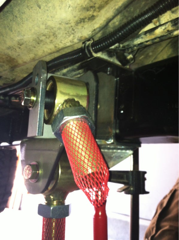

Did a little messing around with the new upper link mount. Opinions on location and or strength of placing this link mount on top of the poly 3 link mount. Towards the front of the mount or rearward, maybe directly over the lower?
Plan would be to weld it to the top of the 3 link mount, to the vertical where the two meet and probably come backward off the inside edge to the back edge of the link mount with 3/16" or 1/4" plate. Maybe a dimple die hole or three.
Vs mounting the duroflex joints 90 degrees to each other as the poly link mount would have me do. Which as already stated isn't ideal for a duroflex joint.
