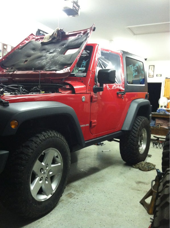

Helped a buddy strip his JK rubicon after he drove it into the Chesapeake bay by accident and totaled it. Swamped the engine and fried the electrical system.
35's in the rear on 3.5" lift. Stock spring and tires up front. Digging into the rear tomorrow.
