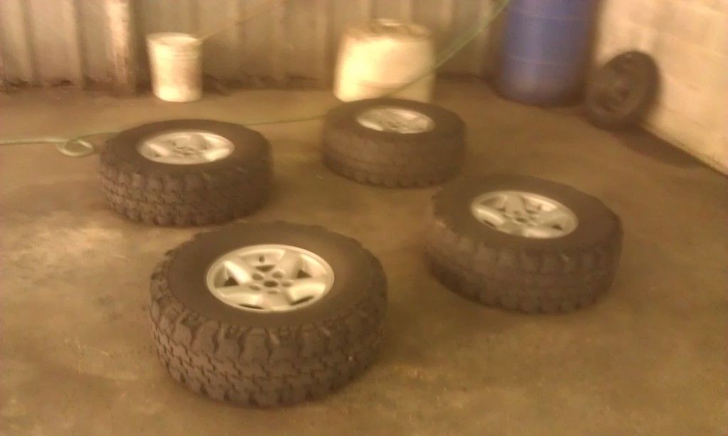

I painted my rims black with bedliner today to match the rockers/flares/bumpers.

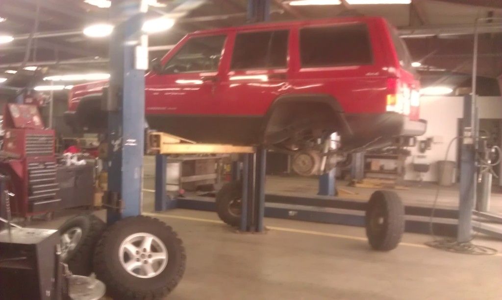

Got it up on the lift

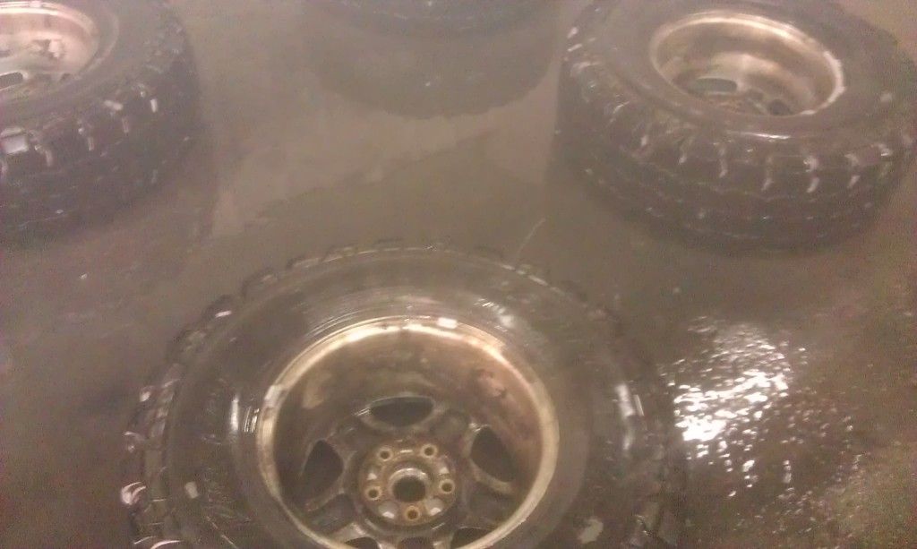

Got the rims real clean
The backs of the rims were coated with black grime. I sprayed acid on them to try to get them as clean as I could. I'm not really concerned with them since their on the back and no one ever sees them, but I figured why not clean them while I have the wheels off. I just did one quick rinse with acid, so its nothing perfect, but its a huge improvement.
From this
To this

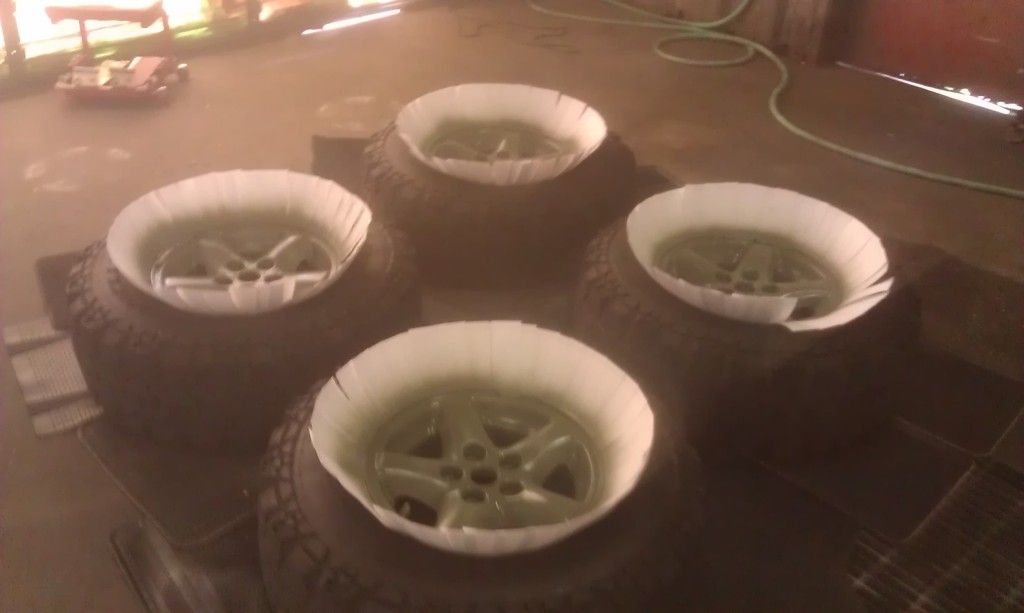

Then I prepped them by giving them a light sand, and sticking index cards between the rim and tire. Then a primed them with a self etching primer.

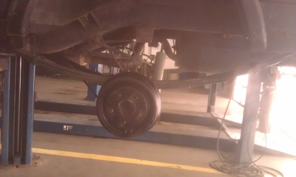

While I was waiting on the primer to dry, I painted my brake drums and did a little touch up painting in my wheel wells.

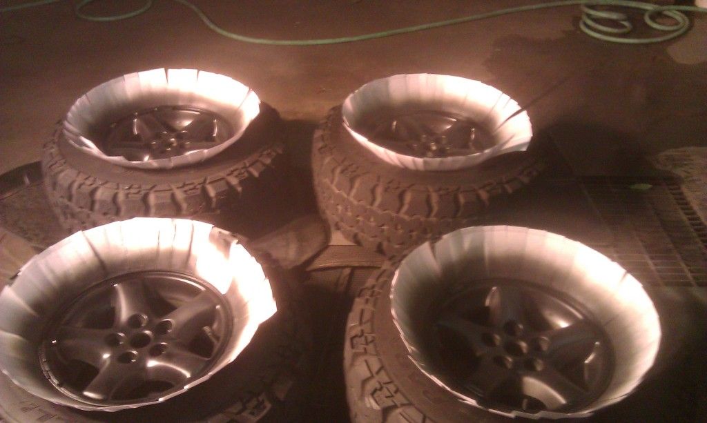

Then I started spraying on the bedliner.
This is a terrible quality picture of the somewhat finished look of the rims. Picture quality is terrible, I know :/ These are still a little bit wet in the picture so their not going to be glossy like in the pic. I'm letting them dry overnight in the garage then I'll mount them tomorrow. I'll post pics of the finished product on the Jeep tomorrow.

I ended up having to drive back out to work because I left my phone in the breakroom, and while I was at it I decided the rims were plenty dry to mount. They've still got to cure overnight, but heres how they look!
I love the new look! But what about you? Any feedback and suggestions are appreciated!
