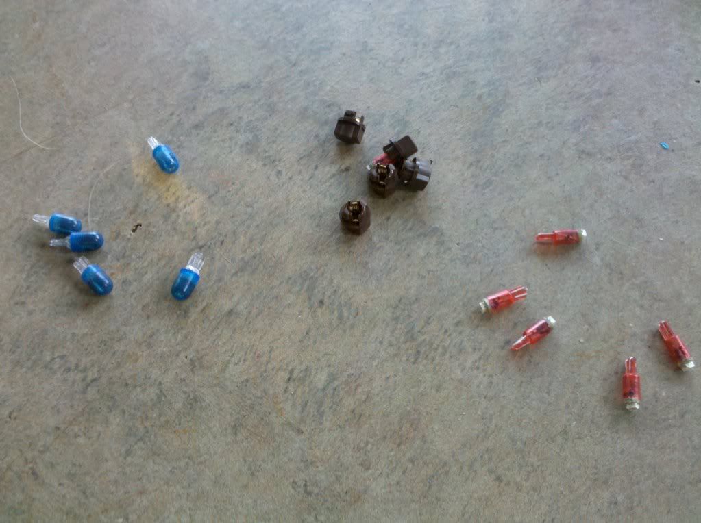

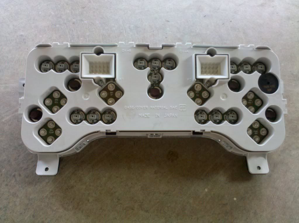

My latest small addition was LEDs to my gauge cluster. I didn't get to take any pictures of the gauges with the LEDs because my camera doesn't show the red light very well, which I guess is because my camera can't pick up the LED wavelength or something, but I'm not really sure. But anyway, for anyone with an XJ that wants to know how I did it, all you have to do is order 5 #74 LED bulbs in any color that you want, take the gauge cluster out, and put the LEDs in the place of the old lights. I got my bulbs from http://www.superbrightleds.com/cgi-b...%2F74-xHP.html . I know that that is the size bulb you need for a 99 XJ, and I would assume its the same for an 00-01 as well, but I'm not sure so check before you buy your bulbs. I got mine in red but you can get them in other colors there if you want a different color.
These are the only pictures I got from the install
Old lights on the left (blue is because of the filter type thing on them, dunno why that was there), holders in the middle, LEDs on the right.
The 5 brown caps are what you have to twist out to get to the lights, then just pull the old lights out and replace them with a LED, and then put the cap and light back in
