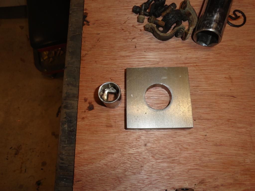

did make myself a handy 'tool' to remove the u joints with a BFH..
1/2 steel pad with 1.25 hole, made for a nice cavity to drive the joint into, worked better with BFH than with clamp.

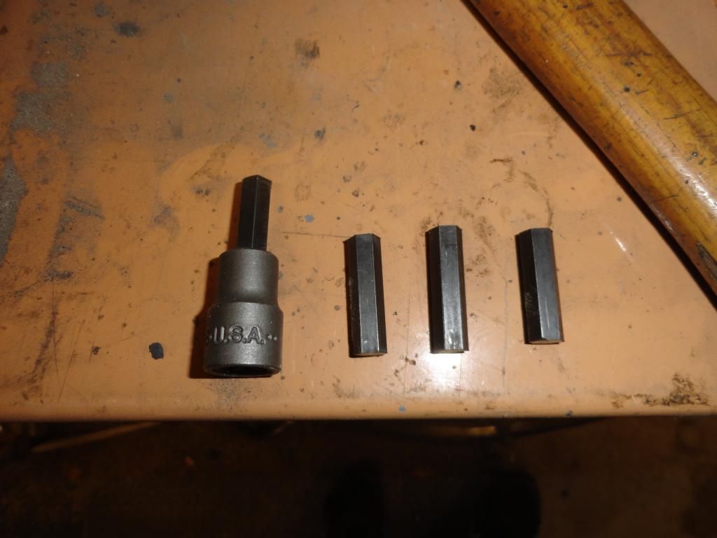

wanting to drop skid plate, and tear into tc, tranny, and clutch...skid plate is bolted up with rusty bolts that require allen wrench to remove...
not working..
still not working...
all those are busted as well.

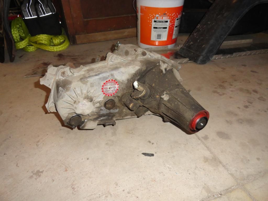

So, a little update, haven't gotten much done in the past few days, the wife has been working during the day so I've been watching daycare kids, and the only time I get a chance to work on the Jeep is when I get off of work at midnight or later.
Now I know, transfer case removal is a minor job for most, but for me it has been the pinnacle so far. I was very reluctant to try, but I went for it, and it wasn't as bad as I thought, thanks to the JF and all it's members. Now that I have it out, time to research what to take apart on it, and see if I can identify any parts that need repaired/replaced.
Might have to give my mechanic buddy a call, have him come over and walk me through some of this.
