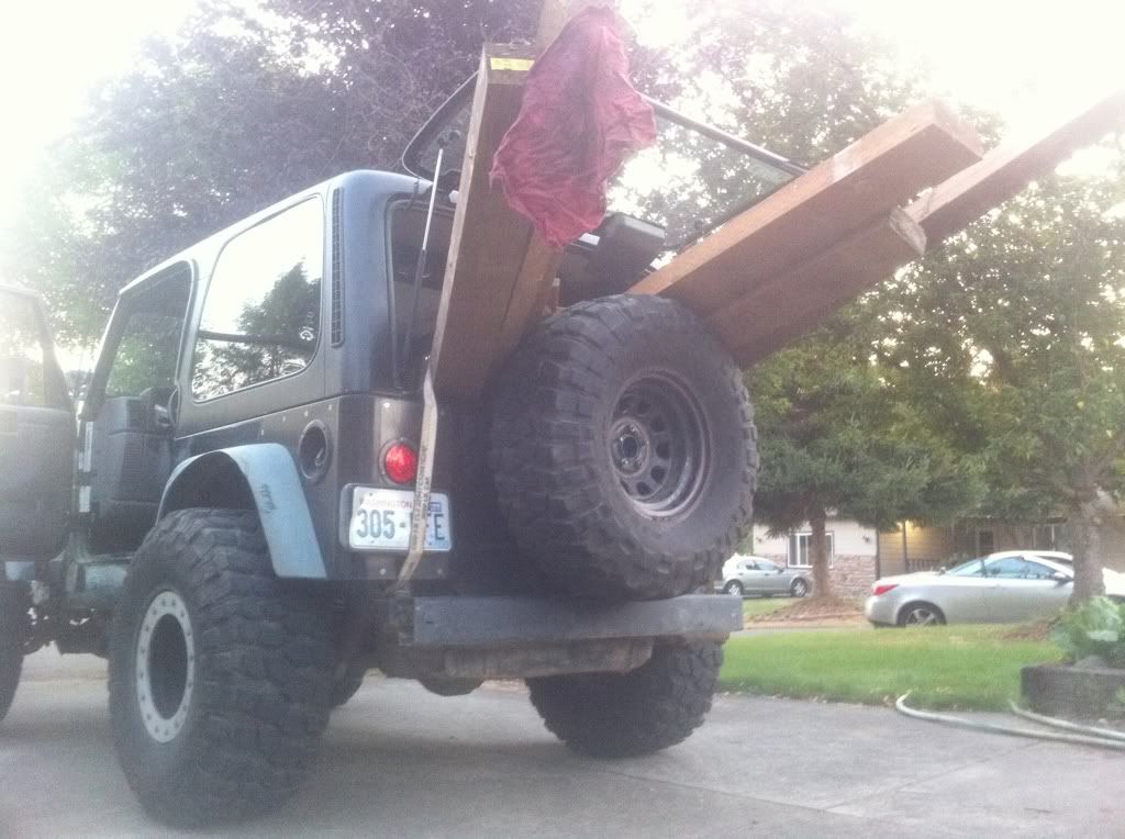

Found some pics from a local guy in the club...
in the background
Those mini tank traps look like a fun place to do some wheelin'!
ibjeepin95 is offline
post #108 of 683 Old 07-27-2011, 06:38 PM Thread Starter
gtxracer
Location: olyWA
Posts: 434
Yeah they're a lot of fun when it's wet or snowy!

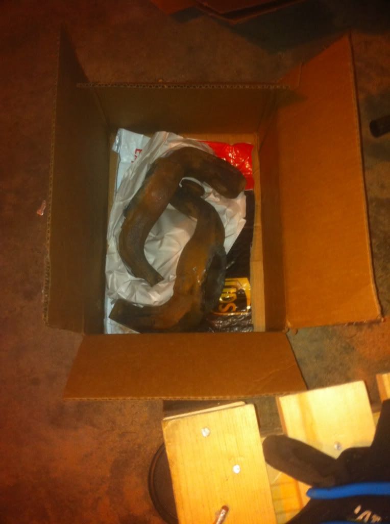

Got these in the mail today, girlfriend took the pic for me

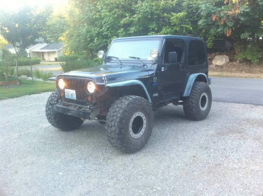

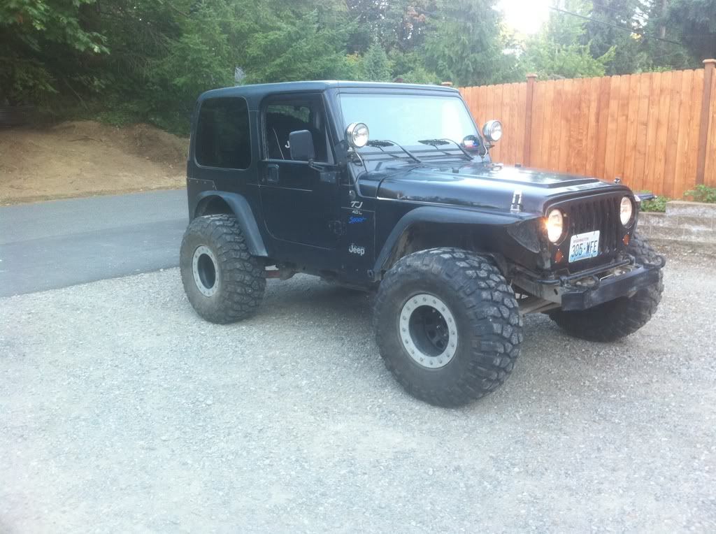

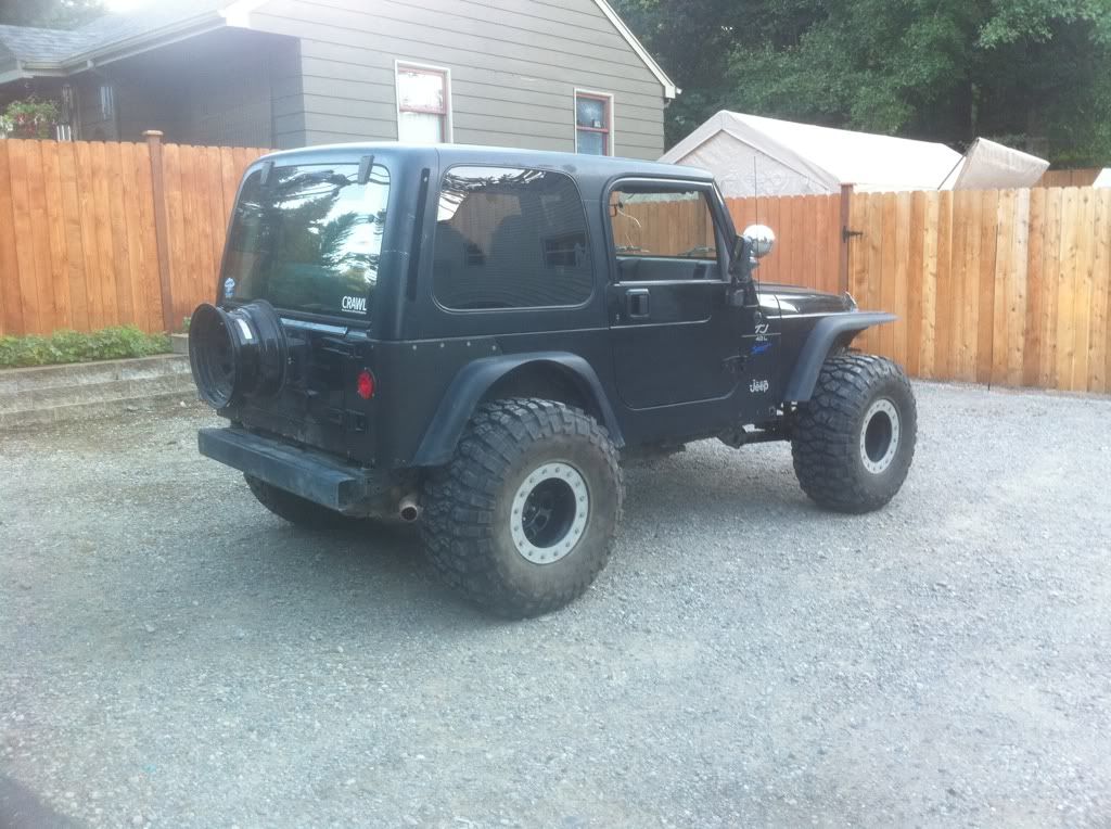

Found some beadlocks on craigslist that I couldn't pass up-
Made the krawlers W I D E but even more stable. I shouldn't need spacers up front now but I might use them to get even more steering out of it. We'll see.

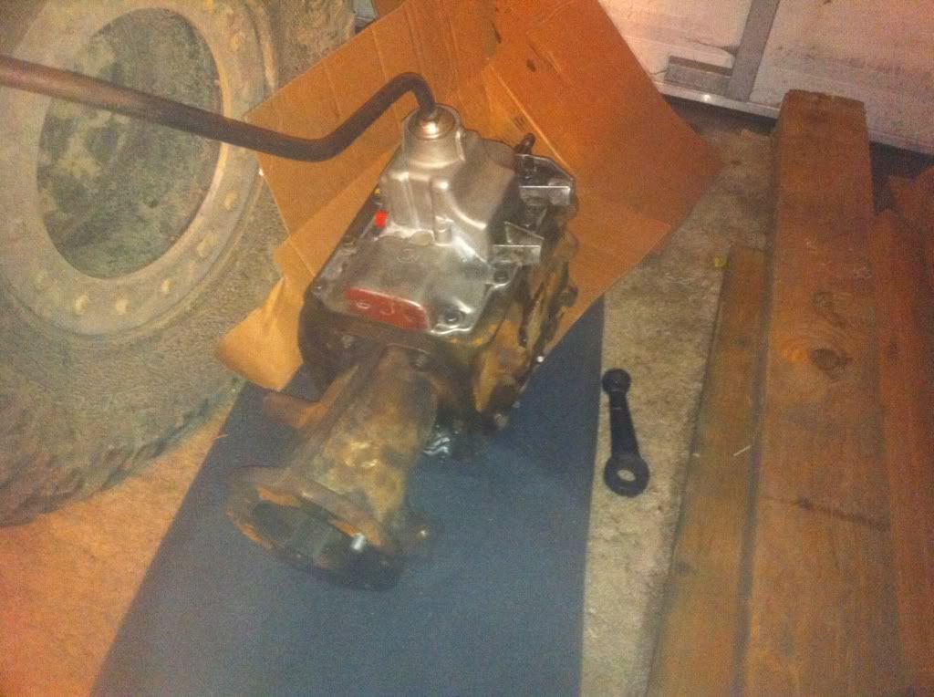

np435 and dana 300 with AA adapter and shaft

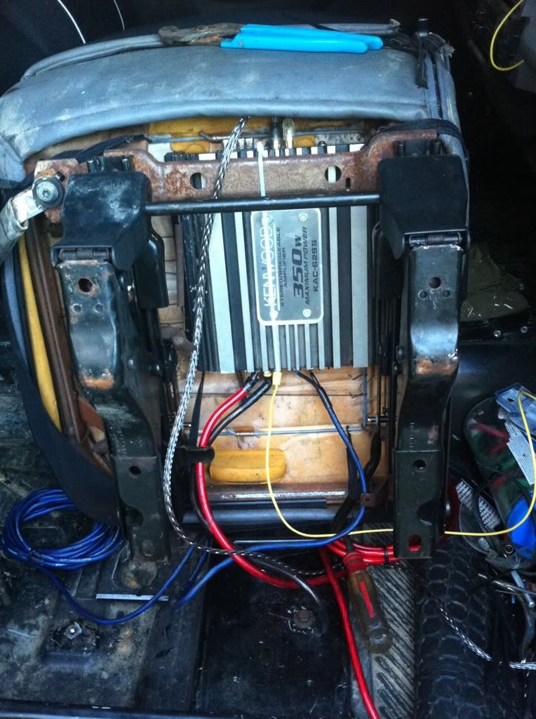

mounted a 10" sub in a box in the jeep and put the amp under the seat

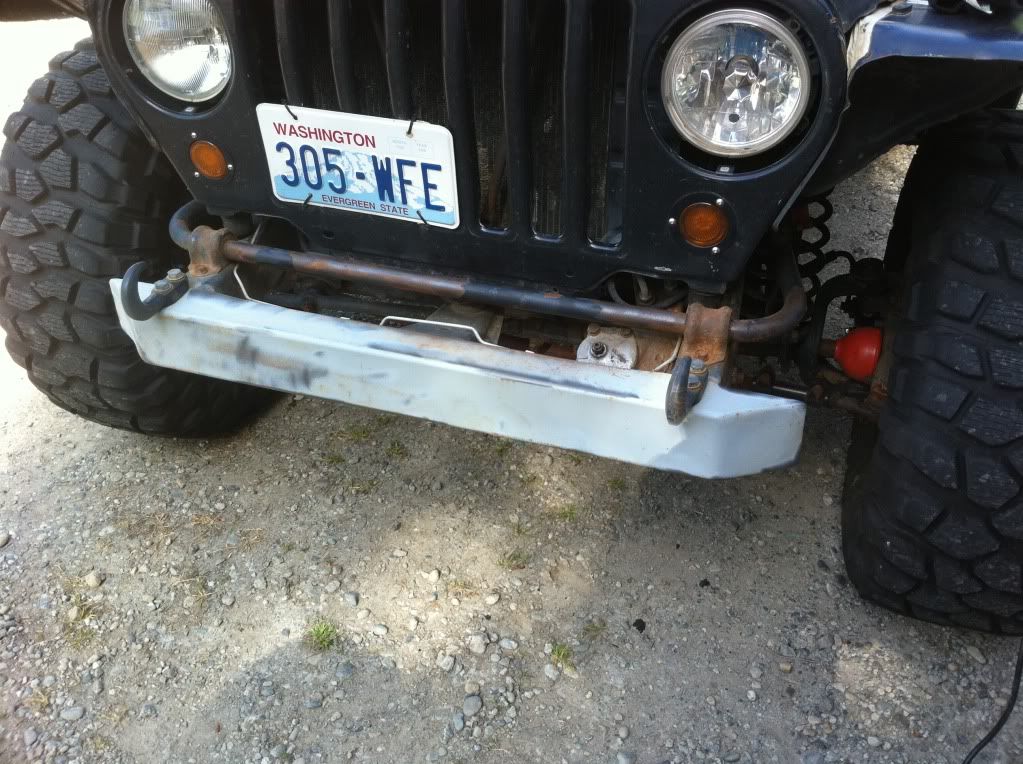

cleaned up the front end

spare np435 since the one I got has a cracked case and top cover, waggy pitman arm too

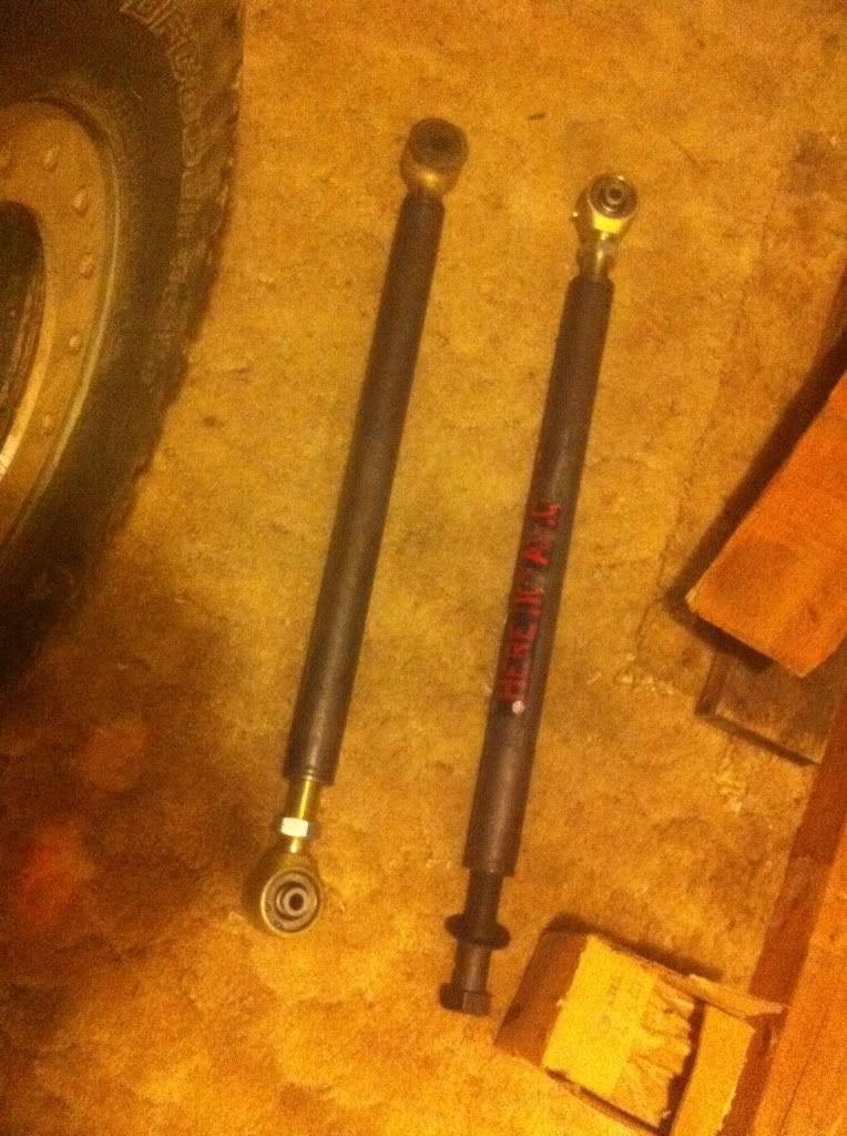

4 heretic fab 4340 lower links

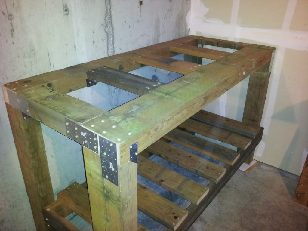

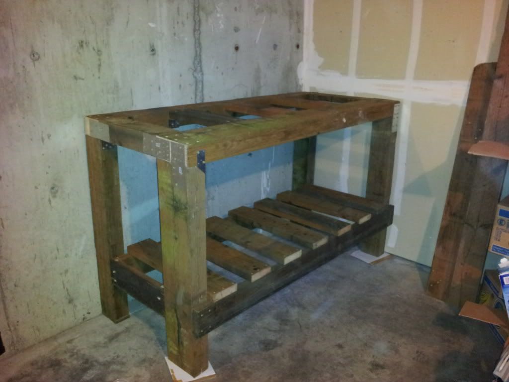

Built half of my workbench with free lumber
