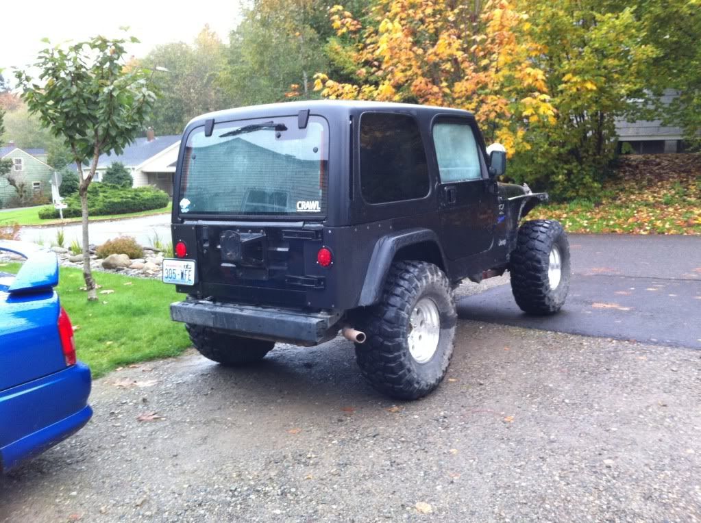

Thanks! Actually the rear has a built in 1" lift from the 8.8 axle tubes donors slightly higher than the front. This is why I want zj coils up front but right now some minor trimming will be more than enough to clear the krawlers. I'll take pics and write that up too.

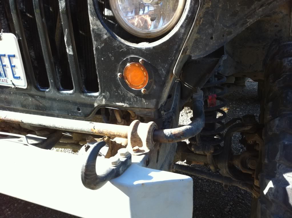

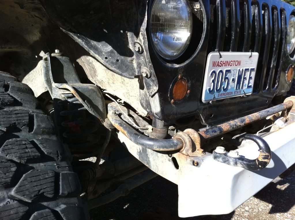

First off, I can't stress enough - CUT YOUR HOOD FIRST! And make sure it's straight. I need an entirely new front clip, maybe not a grill, but everything else is too tweaked. Oh and don't even try to crimp a lip on the hood, just cut it and make sure you measure 15 times before you cut.
So, I have a very loose front end and wanted to make sure it was secure. I made some extended front body "bumpers" by taking off the stock ones and adding some leftover body mount pucks and making their holes bigger to put a bolt through. There's no nut on the end, they're held in place by gravity and the frame. Oh and drilling out the bumpers takes some patience and technique, it will take off the finish from any black drill bit-

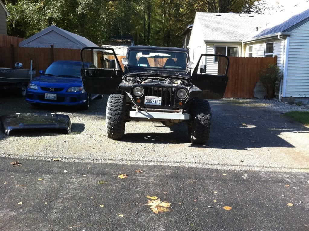

Then take the hood off since you didn't cut it first
I would show the measuring and taping process but mine didn't work correctly and I had to eyeball it and trim, test fit, trim, test fit, etc because I didn't cut the hood first then build the fenders off it. So, that's another reason to cut the hood first AND while it's on the Jeep....so much easier.

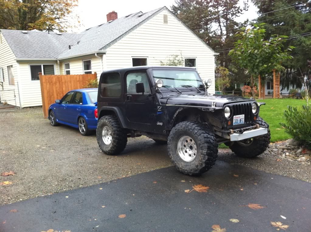

Today I parked on a hill next to a TJ that is similar to mine but mostly stock in the lift/tires. Overall mine is only about 3-4" higher even with a hard top.

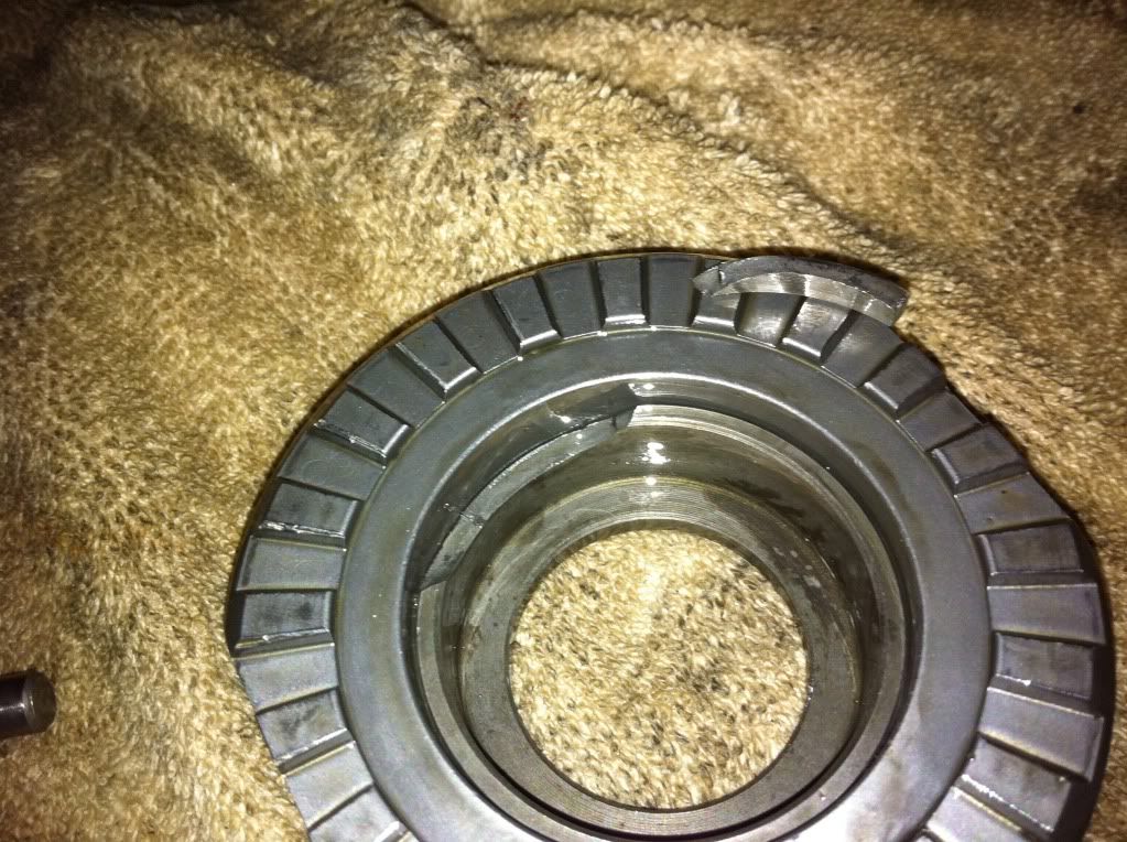

So I replaced the springs and pins in the front lock right the other day and found this-
Whoops. I put it back in after I removed the chunks. It was still working, just had the clicking action, so I think it should be fine. Gonna run it til it explodes I guess.
