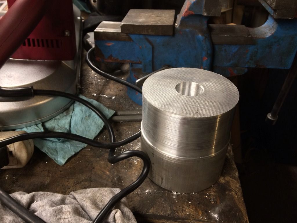

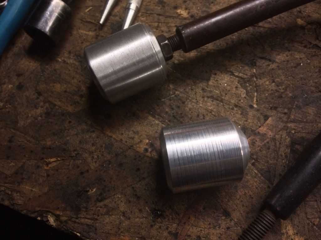

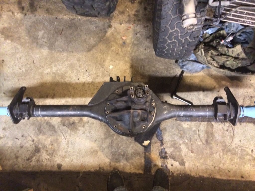

Ball is rolling now, axles are all torn down and alignment pucks are done for the third. Just need to make the two pucks for the axle tube. Spun up two shift knobs out of aluminum for the transfer case shifters.
Couple cool factors about the Eaton axles:
Housing is symmetrical
Third member bolt pattern is symmetrical
Thirds can be flipped and run in reverse
Link mounts can go right on the housing, it's mild steel
14 bolt shafts and locker can be swapped in
SRW hubs make it a 65" WMS axle, DRW makes it 63" WMS

getting better at this whole "machining" thing
"flipped" third bolted in the housing in factory location
knobs

They're a very cool axle. I have less than 1k tied into my front and rear axles so far. That's 3 Eaton axles, a Dodge D60 front, spare Dodge UBs and stubs, 2 5.14 thirds, 1 Eaton No-Spin locker, 1 14B locker, 1 4.10 third, two disc brake kits (brand new), and all the alignment junk.
If I were building traditional Ford D60 and 14 Bolt, I'd easily be at $3k+ already and a 609/9 setup would be $4k+ for similar strength With custom axles I'll still be well under what it would have cost to buy and narrow a D60. I'll have drop out thirds, factory 5.14 gears, easy to obtain and swap out lockers, and plenty of spares. Plus the Dodge knuckles are pretty much high steer oriented from the factory and I have a plan for those too.
