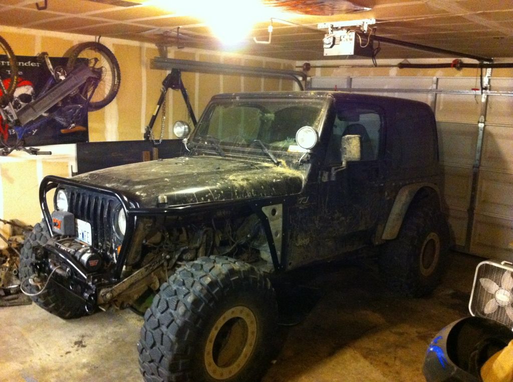

I am really enjoying the CTD, its fun to drive and I have always loved the sound of a diesel!
Got a couple hours shop time today. I was supposed to have 8 full hours but I had to do some school work. Still planning to pull the factory cage and dash on spring break to build a full cage!

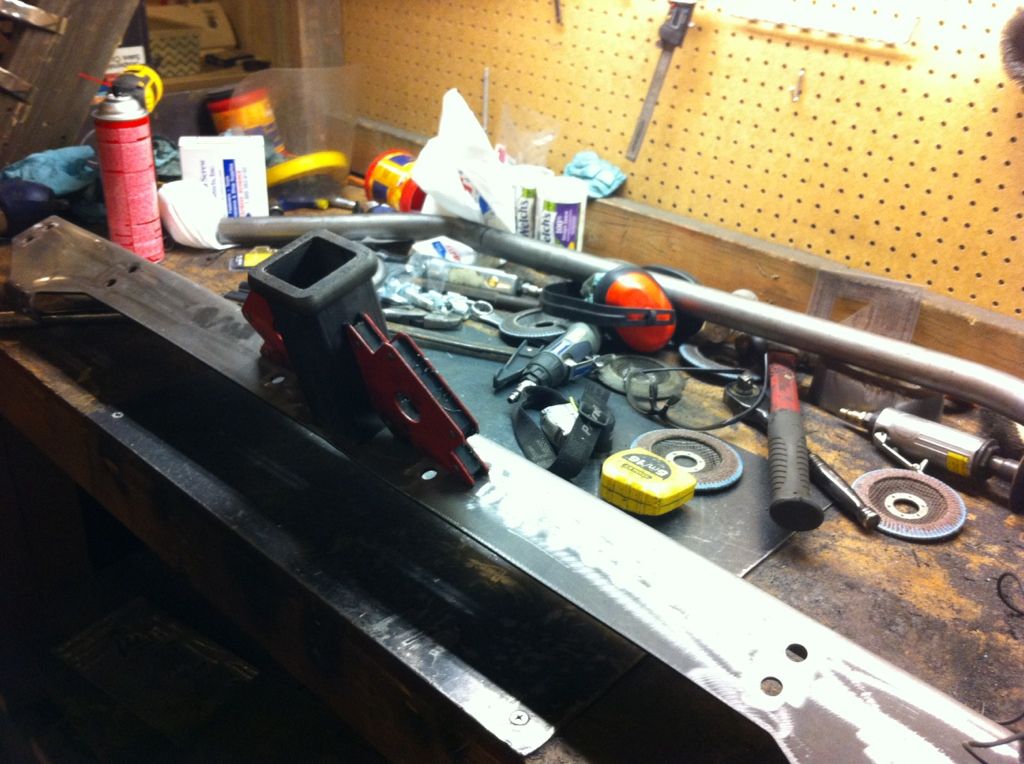

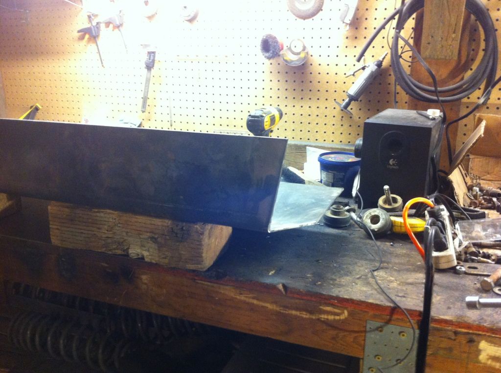

Bent the plate for the driver's side fender, then bent the tube to the same angle as the other side. I bought some D rings on Amazon, they're less than $8 each and can handle the weight of the TJ and then some. I'll have to give it a little more bracing so it doesn't rip off the 3/16 plate. I tacked them in place, nothing is fully welded yet. I think I want to do some small tweaks still before I glue it all together.
Link to the D rings, great deal, especially if you have Amazon Prime like me
Curt Manufacturing 83750 18800 Lb Cap 5/8 In Forged D-Ring W/Bracket : Amazon.com : Automotive
I also ordered one of their 2" receiver hitches, 6" long, for only $15 to add to the rear bumper. So I'm also ordering one more D ring to put one on each side of the rear bumper also. Hopefully this will help someone with their cheap bumper build.
Amazon.com: Curt Trailer MFG. 2x2" Receiver Tubing: Automotive
Pictures of tonight's progress:

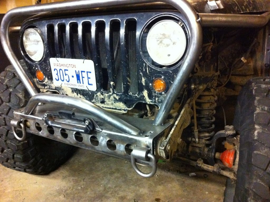

Well I'm supposed to go wheeling on sunday so I guess I should start working on this again

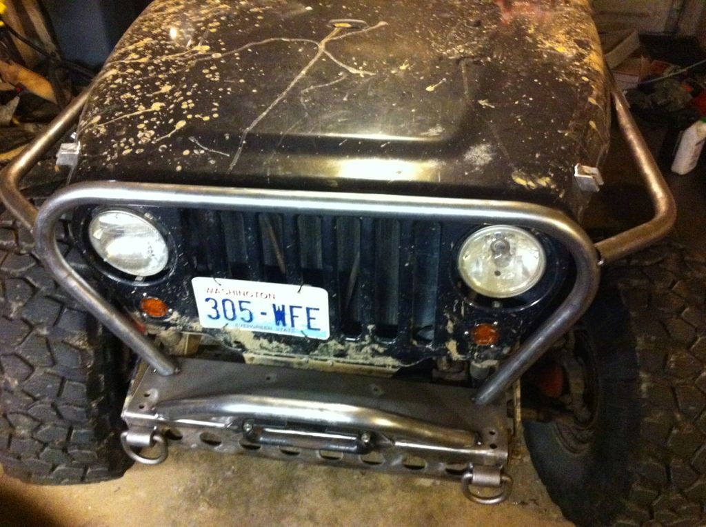

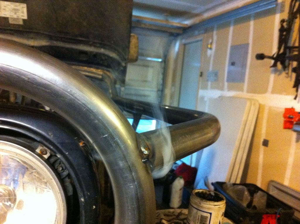

I adjusted the driver tube then burned everything in

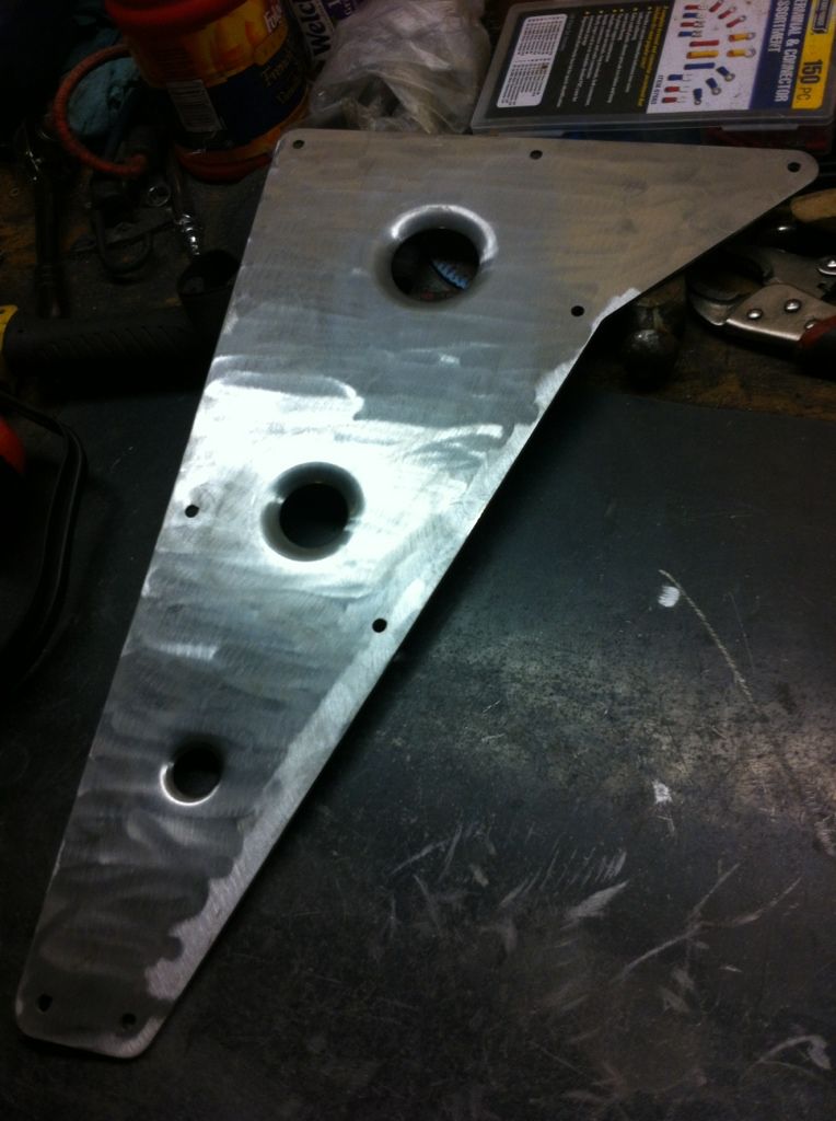

And dimpled the fender inserts
Also wired up the CB finally, replaced the front diff cover bolts, and a bunch of other little stuff. Still need to shorten the clutch rod and finish painting the front tube work. Then mount the winch, wire it up, etc. Still haven't finished the rear bumper or mounted the sliders.

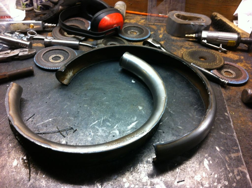

Started on the rear bumper, bent it up and tacked it together.
Since I ordered the hitch, I wanted to run a tube across it for strength, but don't have much 1.75 DOM left but have a whole stick of 1.5 left over...but how to bend it? Hmmm....
Its a sleeve for the tube bender die and runner, so its essentially an adapter to bend 1.5" tube.
Works well!
I bent up both sides and tacked on the hitch but ran out of time and forgot to take a picture, I'll snap some tomorrow.

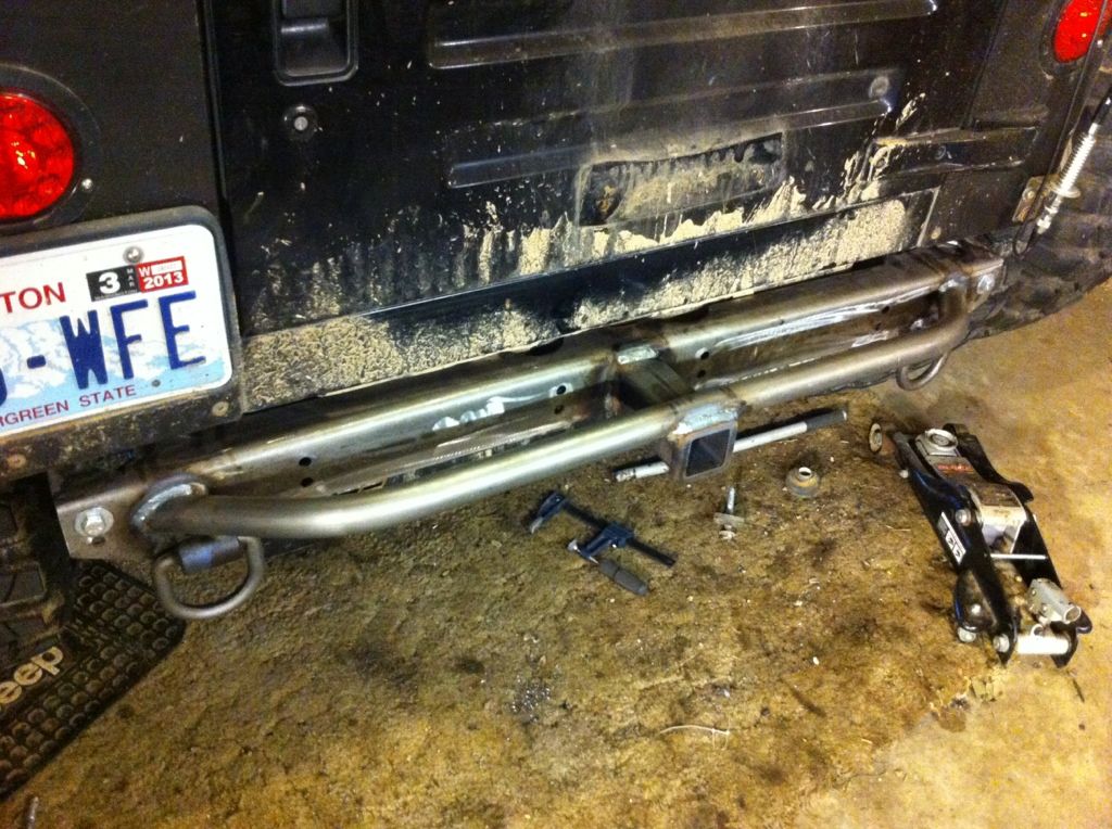

Lining up the hitch

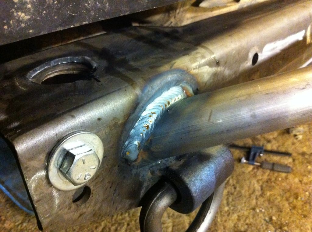

I didn't take pics after I notched and fitted the tube but this is how it turned out. Some welding porn for you guys too.

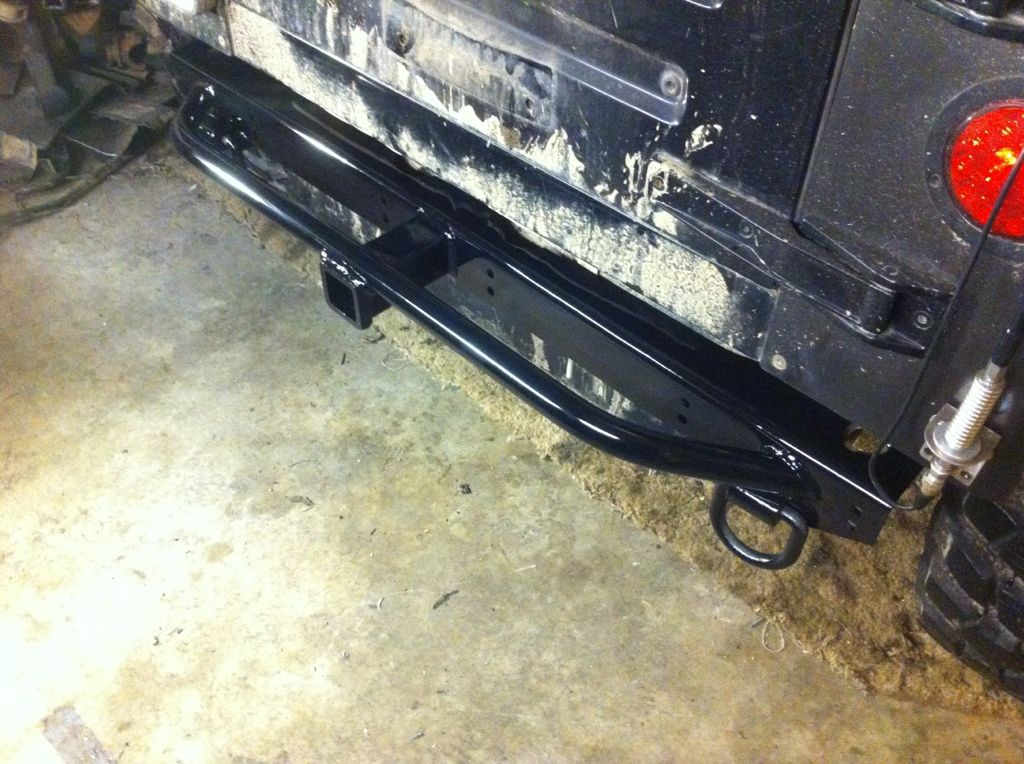

Fitted, clearanced, and ready to be painted. Has 12 bolts holding it to the rear crossmember and it also ties into the body mounts. Hoping it doesn't go anywhere!
Painted up

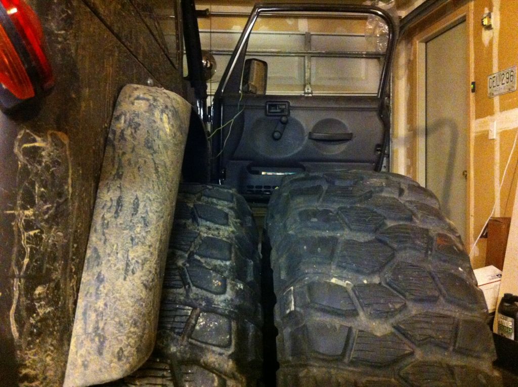

For those curious - both 35 Krawlers, one with a 15x10 beadlock and the other a steel 15x8 wheel
