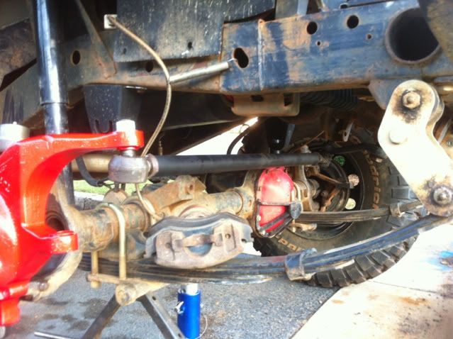

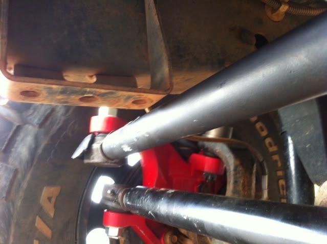

Carrier bearing mount finished, ready to put in place. The plan for this came together well, the opening I drew happens to be in just the right spot for the bolt to pass through
stubby short shaft of the 2 piece driveshaft
corners, my fantastic girlfriend drilled the holes, what a sweetheart!
The clutch safety bypass, took out the connector and made the circuit complete. Starter works most of the time, feels like the computer or solenoid is fighting the wiring for control over the starter.

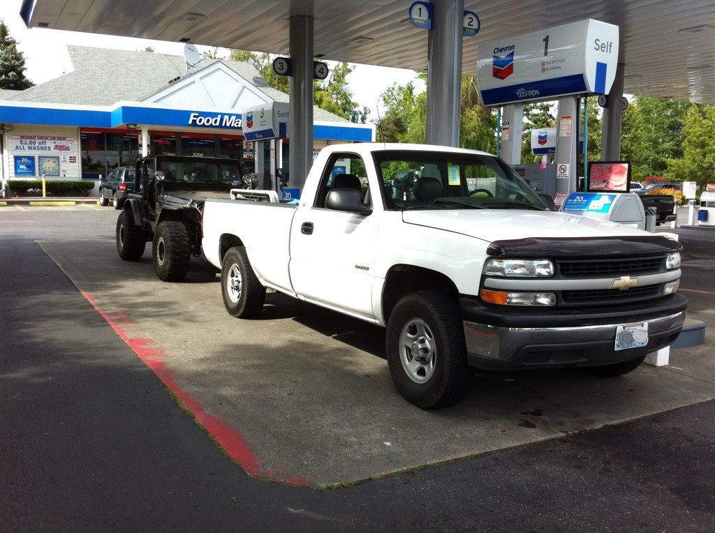

I picked up a HF tow bar and magnetic light kit then made my own mounts that bolt to the factory bumper mounts. It's all 3/8".

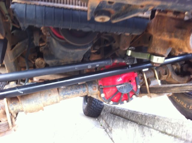

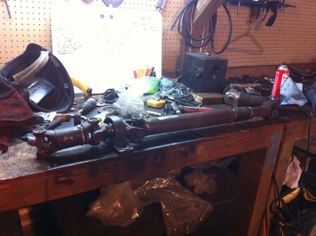

Here's the total pain in the *** 2 piece shaft
The couple days before the wheeling trip are a blur. I was in the shop no less than 14 hours each day, throwing things together, drilling, welding, etc. I got most of it finished to go to the shake down run but didn't get to test the front shaft. Then the front locker wouldn't disengage :shaking: So I had to pull the shaft from one side in order to flat tow.
Filled up and heading out
Had to take the pass in order to get to the trail

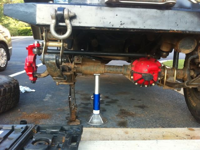

After settling in I tore apart the front end to see why the lockwrong was acting up
I had the damn thing apart for 5 hours and rebuilt the diff but it still won't unlock. Springs are pretty fresh, I replaced them a few runs before the rebuild.

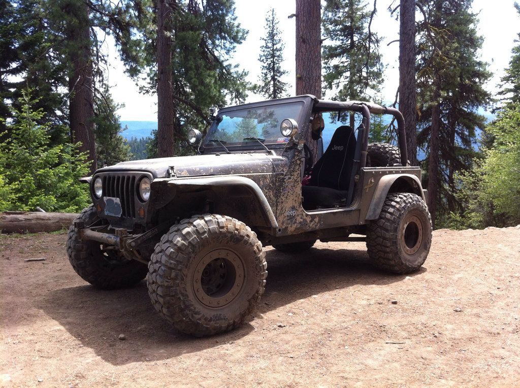

Side shot, the wheelbase felt great
Onto the wheeling...
Couple things to note - I didn't have FWD. Front driveshaft wouldn't stop moving, more specifically, the carrier bearing wouldn't stop moving inside it's mount. I couldn't get the damn thing to stay in one spot and the angle was too much. I wish I would have had more time to test it but the front locker put me out of the game anyway. It's hard as **** to drive a spooled front end - unless you have twin sticks. Wanna guess which cable shifter broke the other day? Yeah, the front stick. haha
So, screw it, I'll wheel in RWD. Air'ed down to 6psi and hit the trails. Only ONE hill denied me and I almost made it! I got it on video, I need to do some editing though. I also got a GoPro Hero 2 from my fantastic girlfriend so I got footage there too.
I'll get the vids uploaded as soon as I can. Overall the Jeep kicked ***! The suspension felt MUCH better than the stock junk. I didn't get a chance to really test flex but I need longer shocks up front for sure. I knew this already since they're only 9" travel but I'll need to have a lot more seat time to know if it's really needed. The np435 was great, low gear is great to have. The D300 is actually a good case despite it's inability to hold fluid.
I'll be redesigning a few things and hopefully have a regular CV shaft up front instead of the time consuming 2 piece and the heavy mount. I'm also ditching the cables and converting to a regular linkage shift for the D300.
