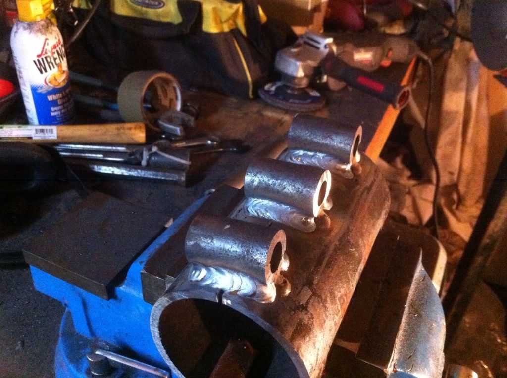

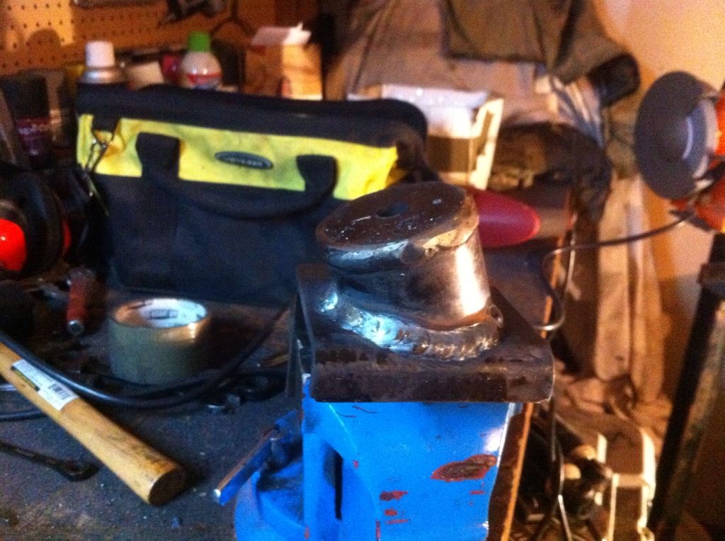

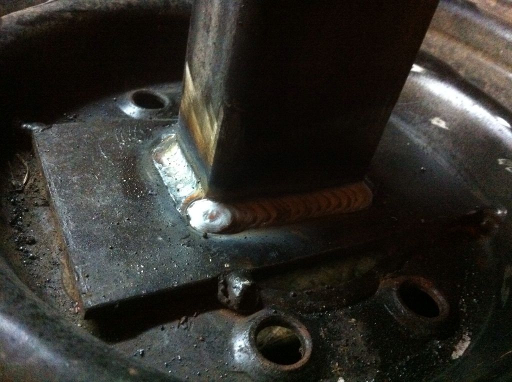

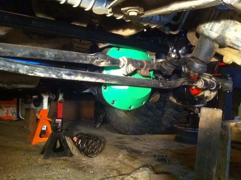

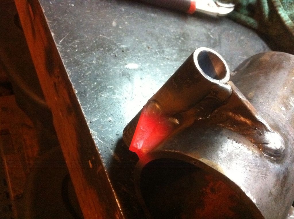

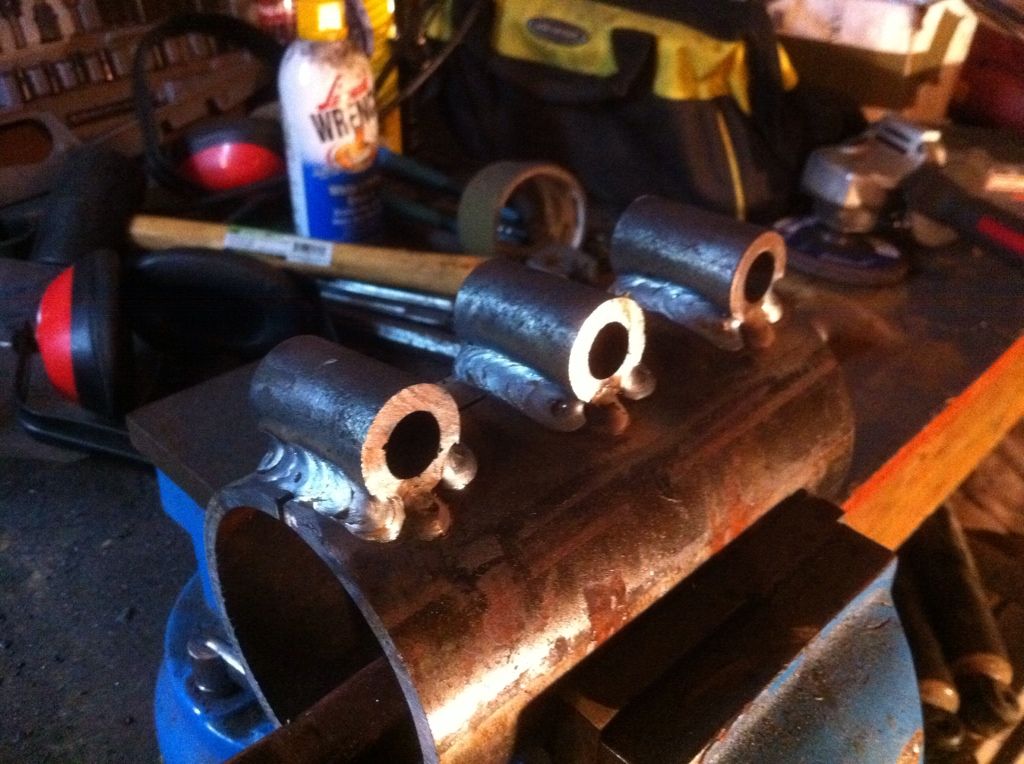

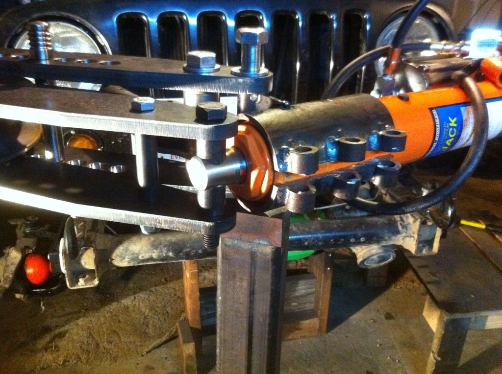

Snuck out to the garage tonight so I could finish up some things from the weekend. Got my HH187 back up and running and burned together the coil retainers and tacked them on the frame. Going to try to get the suspension together and done before the end of the week (Friday night). These aren't as nice as I would have liked to make them but I see a backhalf and coilovers in my future so I didn't want to spend too much time on them.

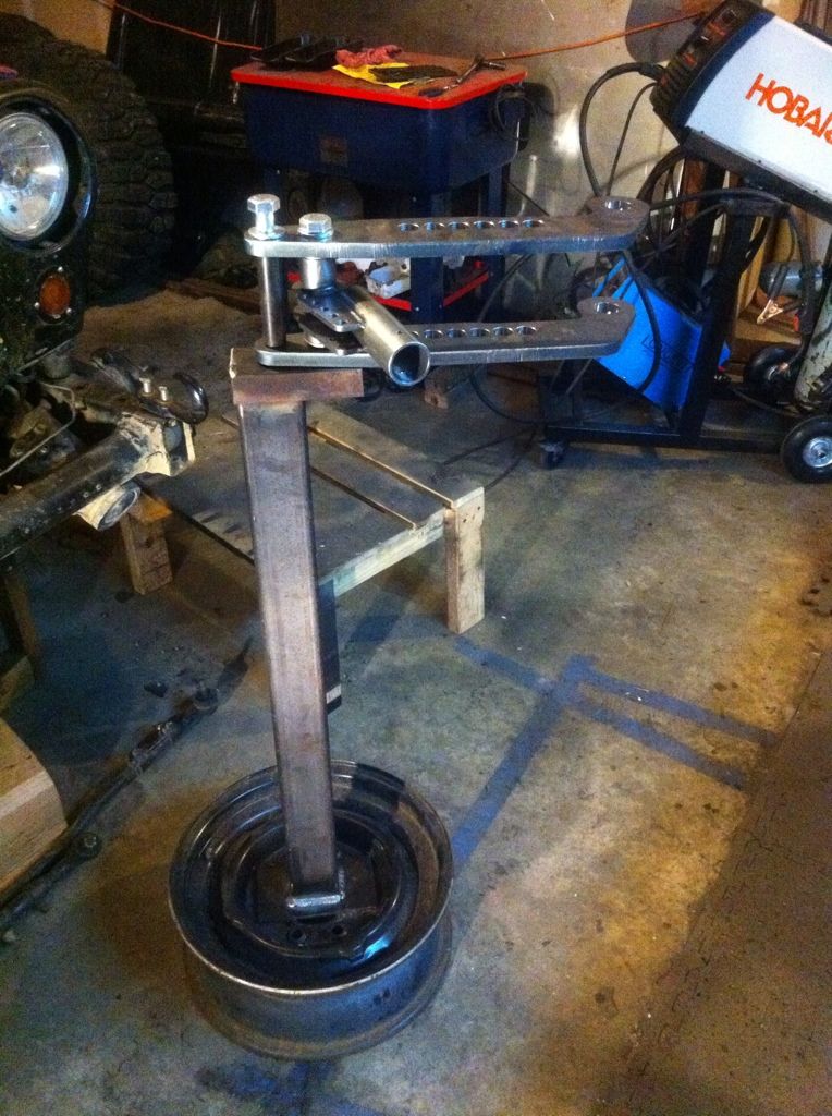

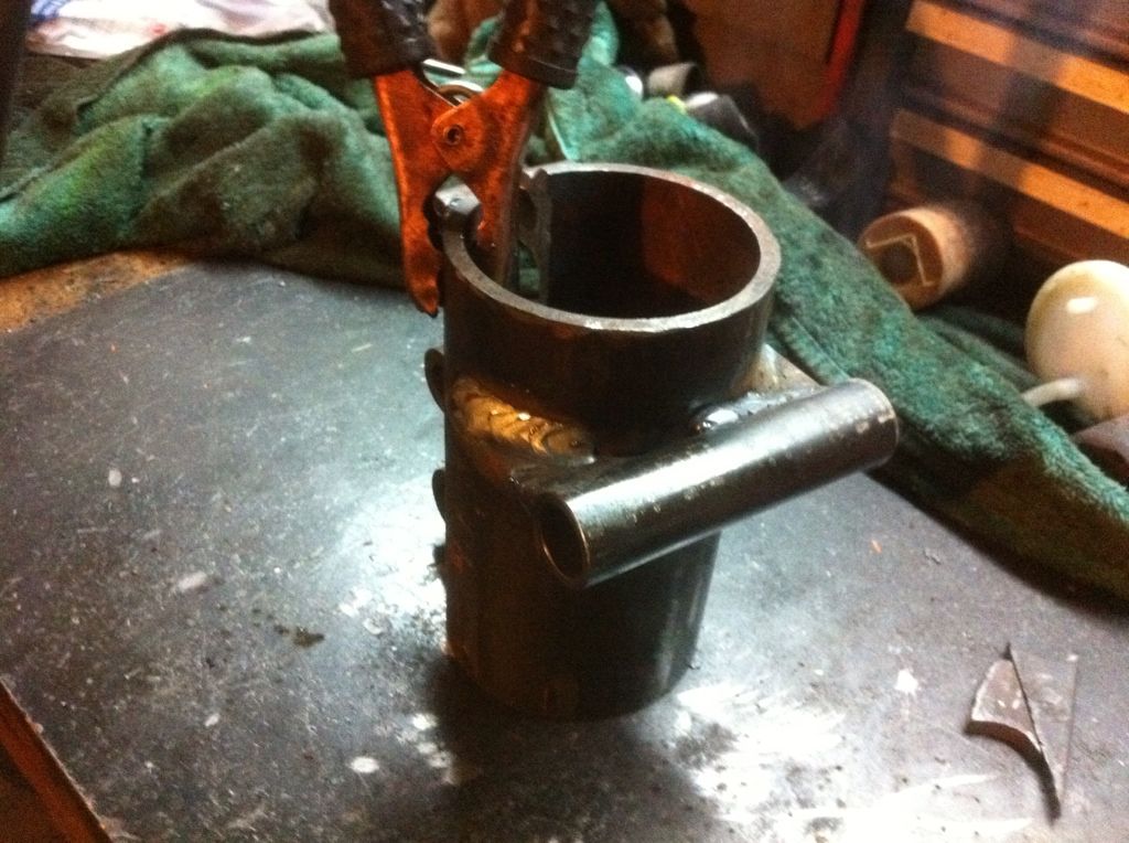

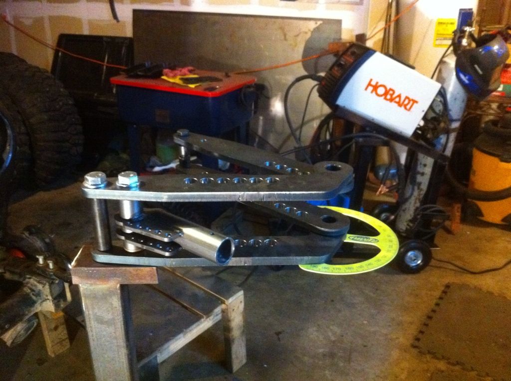

Then I got started on the bender. I've been researching and planning for the past few days and made a final plan the other night. Made a materials list and picked up all the goodies yesterday. I had some of it already so it came together well. I will be making a write up for it but here's some pics-

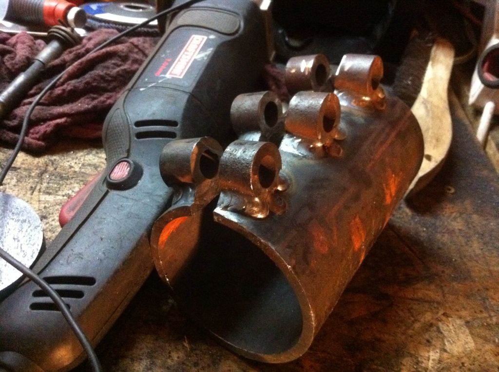

what is the purpose of the big tube with the three smaller pieces welded on?

Clamps the ram in place and mounts it to the bender. I'll snap some better pics when I have time to get back in the shop and finish it.

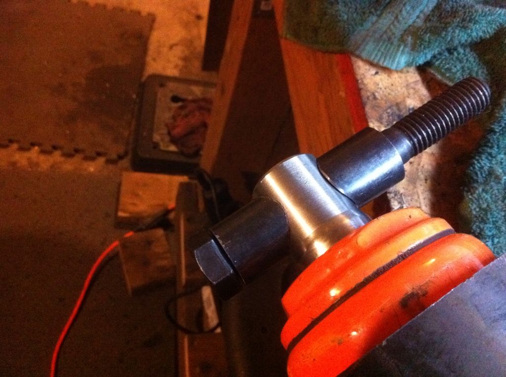

Tonight I got the bender done

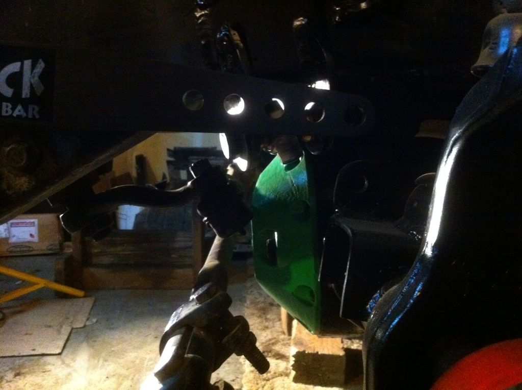

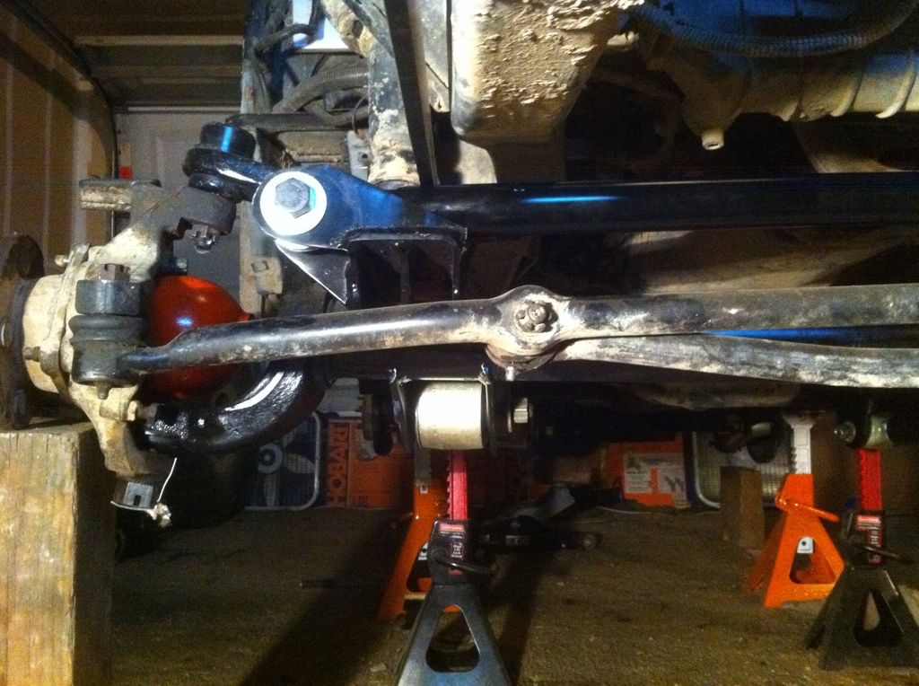

And I got the front suspension cycled for the last time and done. Can't use the stock pitman arm after all, but it's just barely hitting. If I limited my uptravel just a little more it would work.

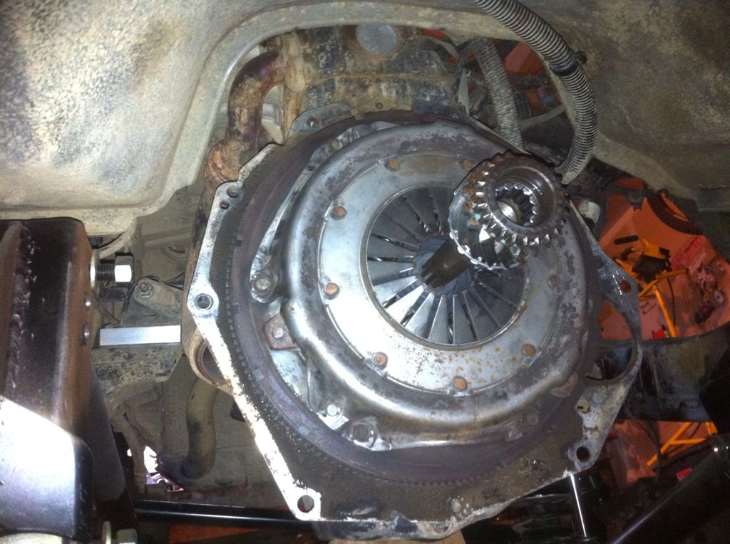

used the bread method to remove the ax15 pilot bushing
used some aluminum foil on new (Novak) pilot bushing, I think my crank is a few thousandths off
used the spare np435 input to align the new clutch Ford/CJ clutch and pressure plate (AX15)

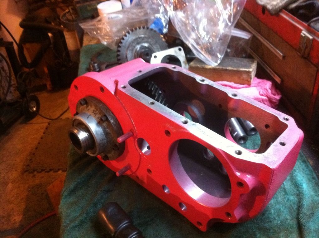

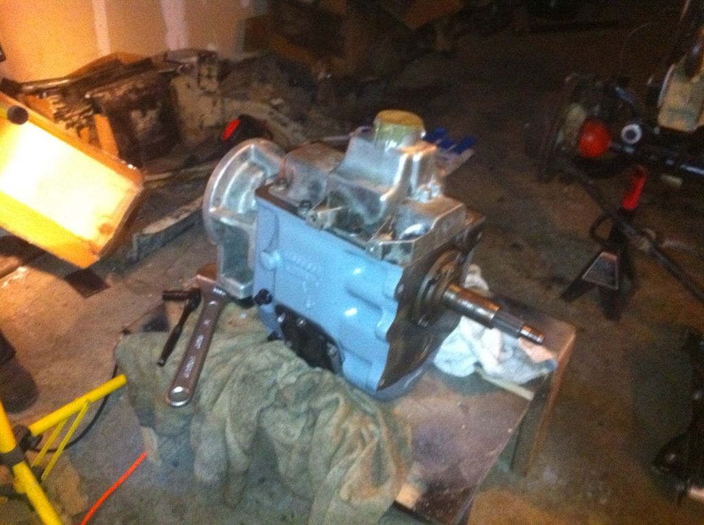

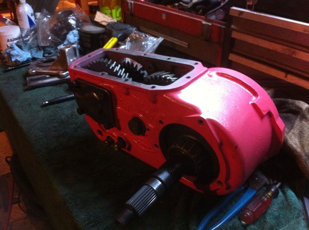

pulled out the trans, slapped on the adapter

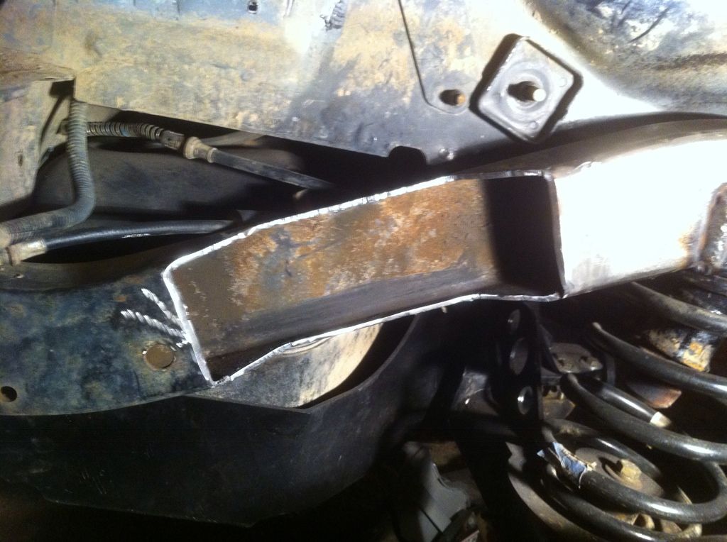

welded the rear spring retainers, they're meant to make contact on full bump. rear uptravel is right at 5" right now but the tub and tank skid may not like the last 2"...haha!

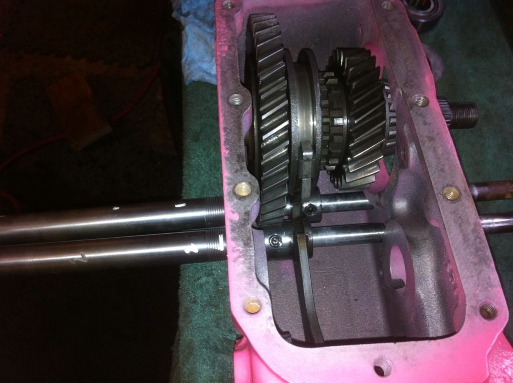

Found the neutral spot in the np435 and put on the top cover, then tested the shifting - all good

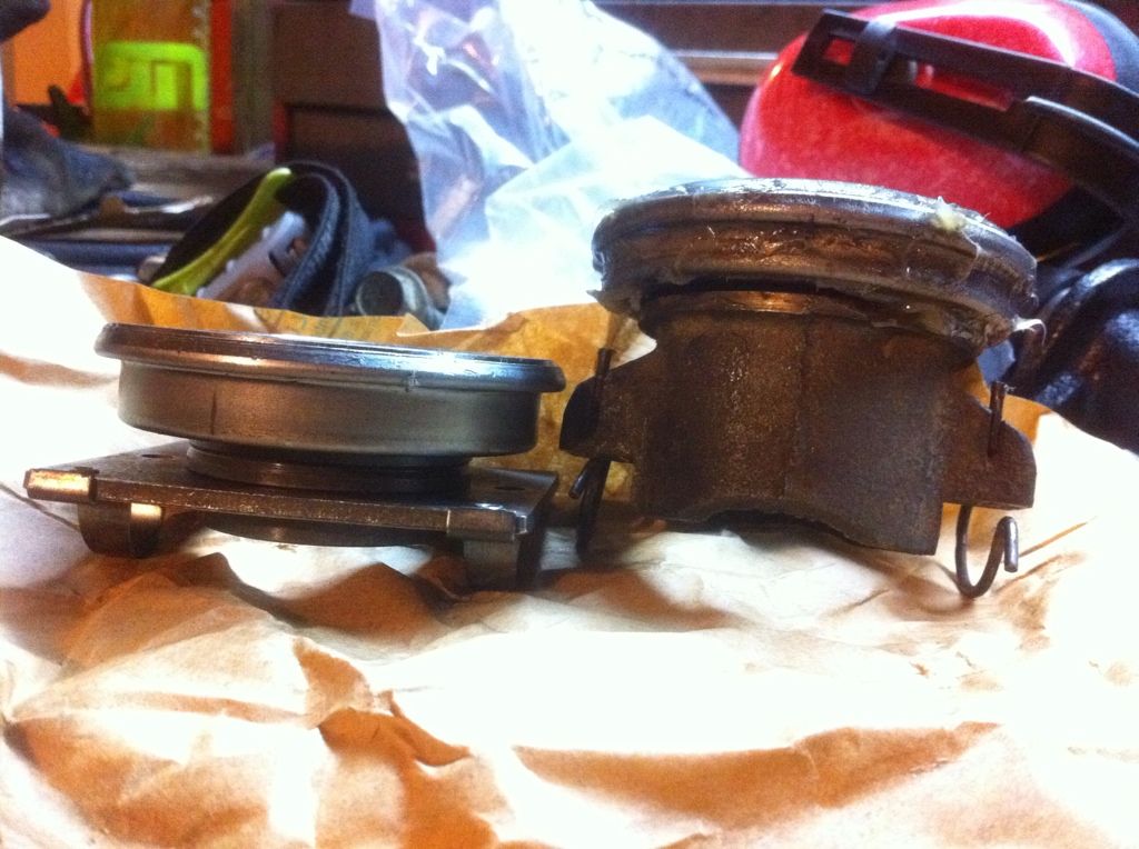

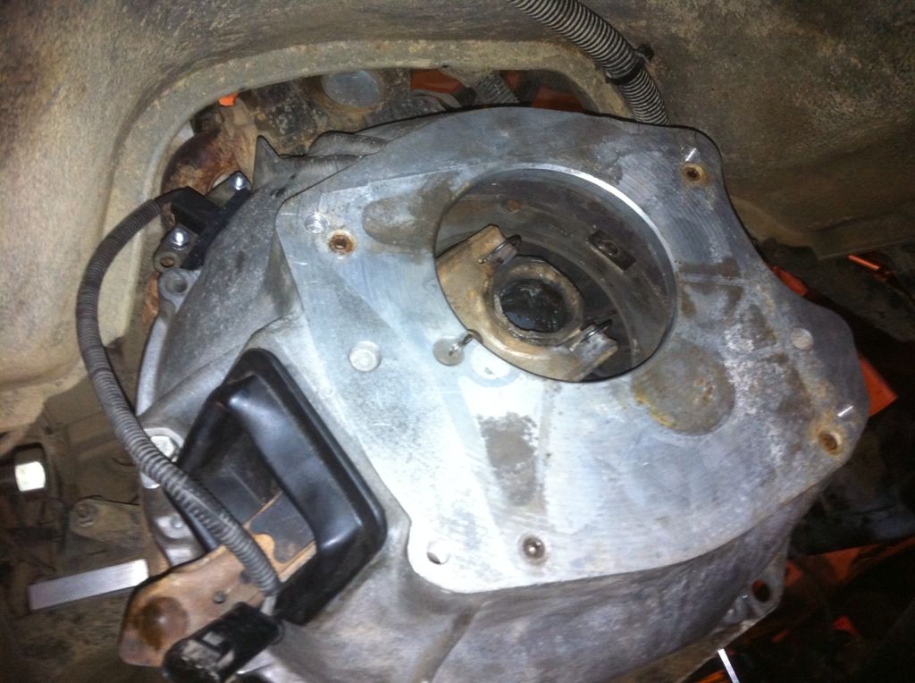

installed the AX15 clutch release bearing (throwout bearing) and it will NOT work, too thick
Here's why, contacts the pressure plate-

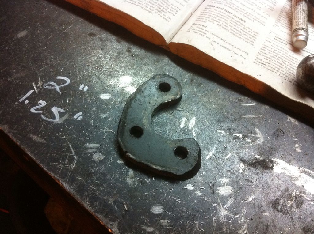

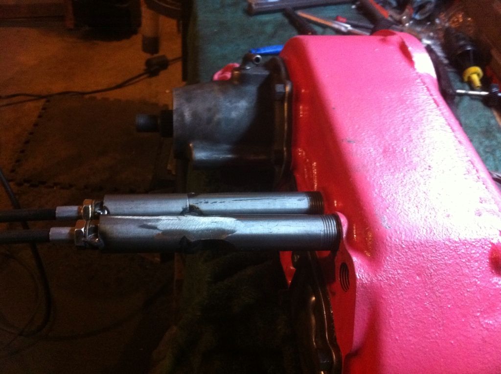

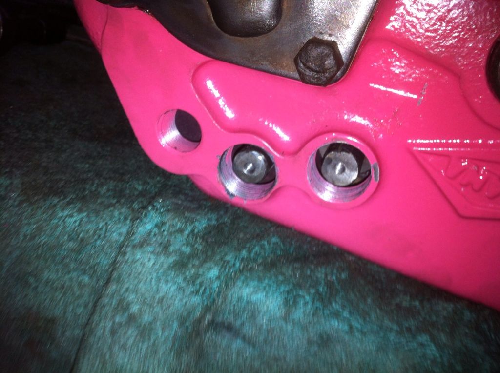

D300 twin stick setup went well...except when I decided I was too smart to remember that the cables have to shift OUT and had to weld on the 2.25" I cut short

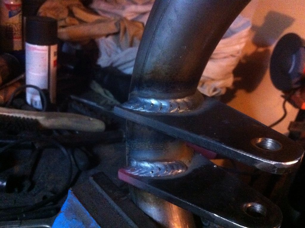

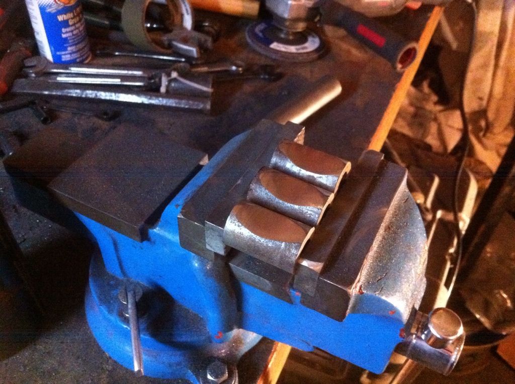

Takes us to today, I'm almost finished with the rear shock hoops...

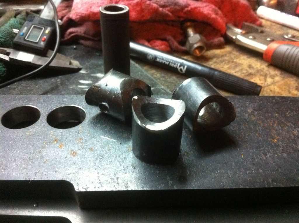

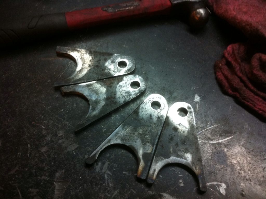

bent some plate, made some traces, cut off some side tube, and some corner mounts-
cut out the shock mounts
bent the tube...didn't snap any pics but the HF ram has been a pain in my ***. I made two 150 degree bends manually pumping the jack...took me about 10 minutes per bend instead of 2 and I was dead tired! haha.
Burnt in the shock tabs, I'll snap pics of the rest of it tomorrow.

swapped the ax15 throwout bearing for a 80 cj7 4.2 unit

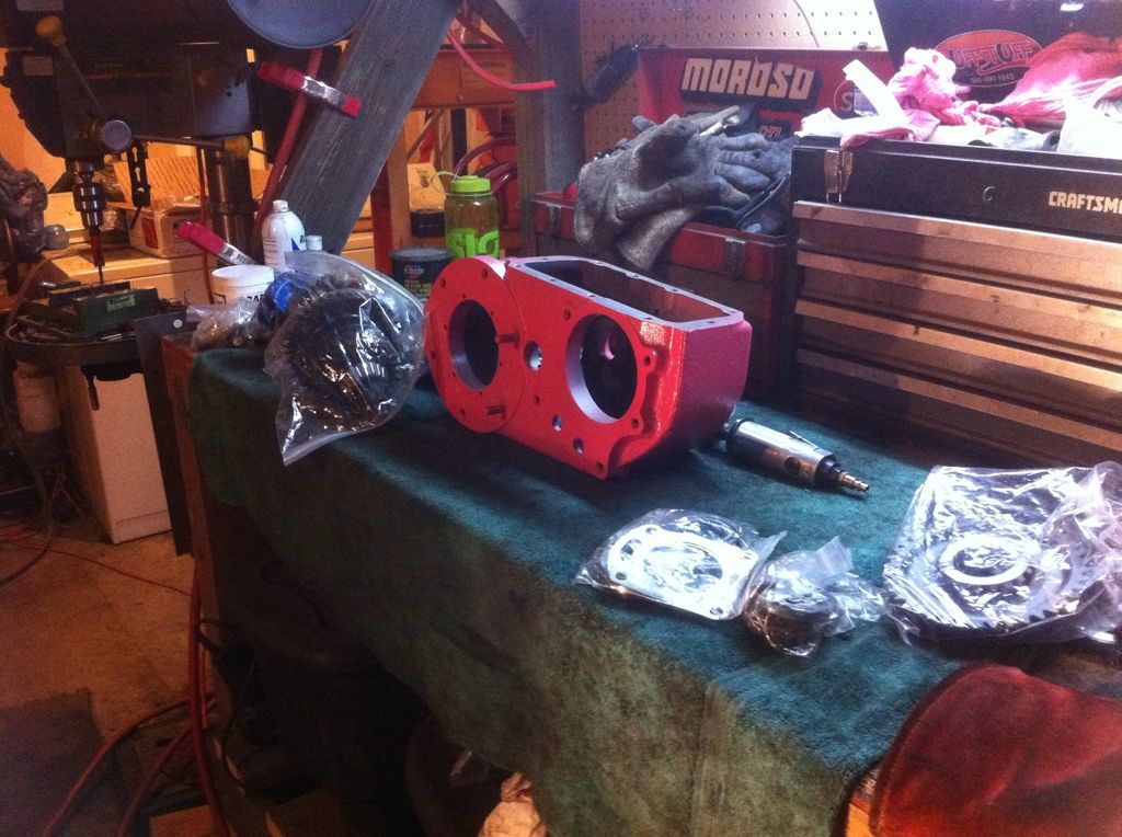

d300 is assembled and put in some fluid to make sure it's sealed

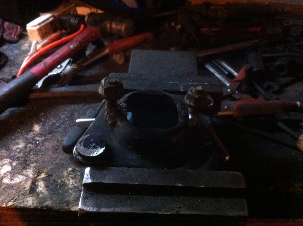

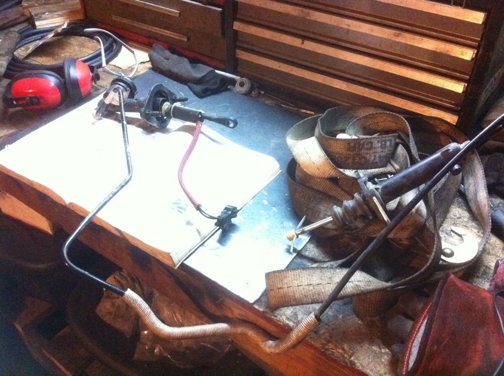

Here's how I adapted the CJ7 master clutch cylinder to the TJ factory master housing, just welded some studs on the housing (bracket) and gave it a little massage so it would fit.
CJ7 4.2 clutch release (throwout) bearing, the short one, versus the taller stock ax15 4.0 unit

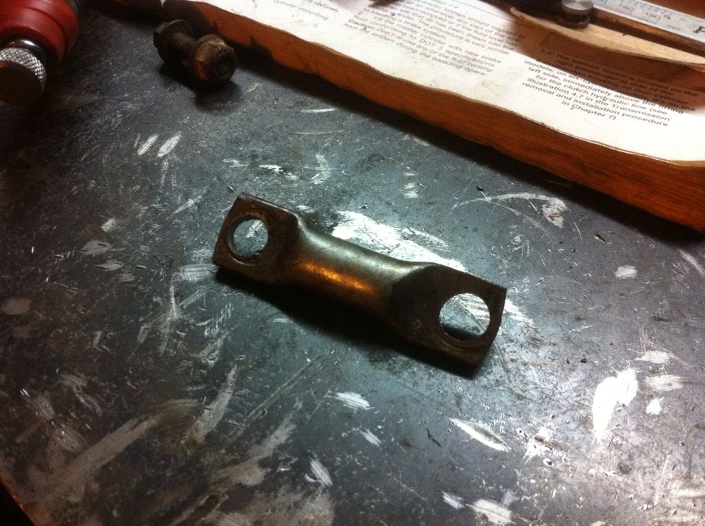

This is the bar pin that I modified to extend the CJ master cylinder push rod to the clutch pedal. Might replace it later on but this was quick and easy. One hole is 1/2" the other is 7/16" for reference
Here you can see the relation of the new CJ master and the CJ slave cylinder, you'll need about 45" of line but 50-52" is what can work. I used a off the shelf line from O'Reillys that was already flared and ready to go, part number PA-451.

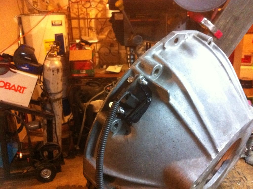

Stock master system has the sensor on it for the clutch (red wire insulation). If you don't want to have to push in the clutch to start the 4.0, just cut off the end that goes over the push rod and splice the wires together. Let's the engine think the clutch is pushed in. Previous owner did this for his wife when she had the jeep and it's convenient and also it's difficult to adapt the sensor to the CJ master.
