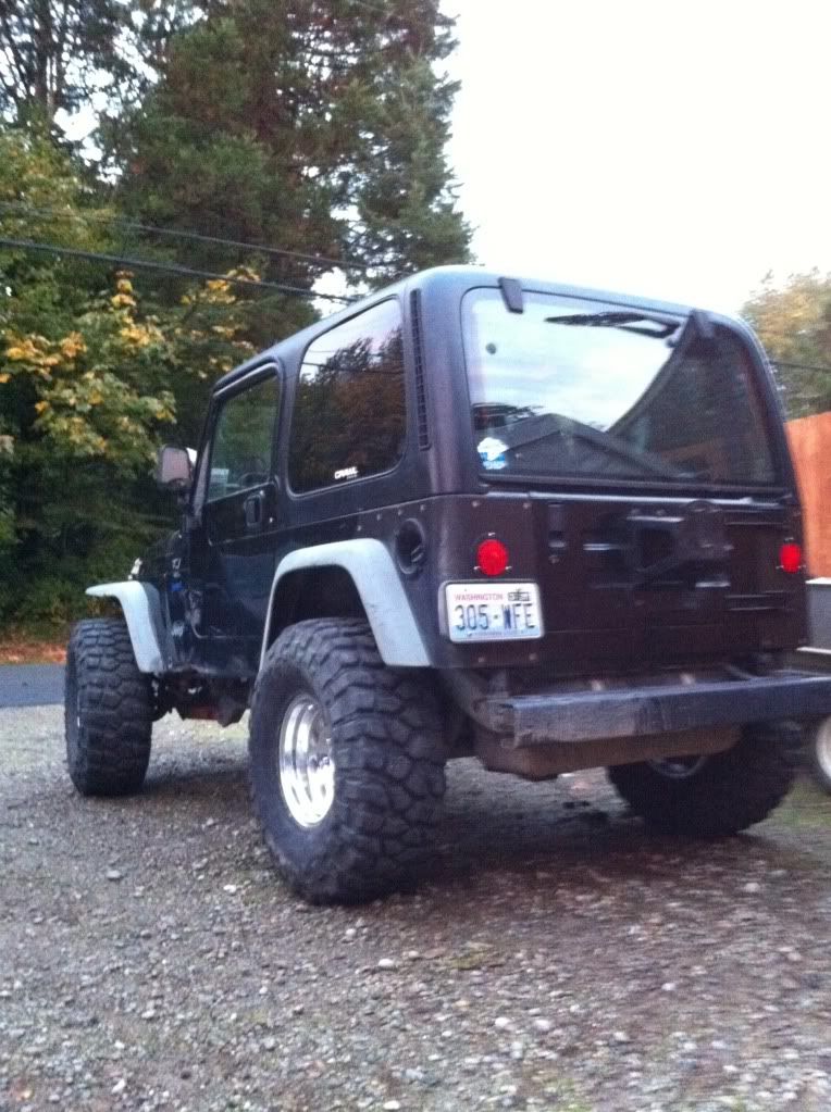

Another shot of the rear corner, came out great!

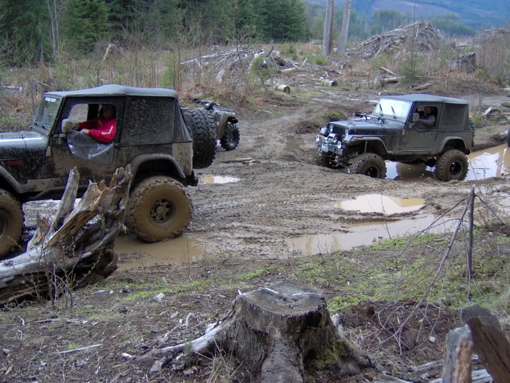

After this I wanted to wheel it a little bit, so I did that
Entrance to BusyWild. I won't be doing this trail until I get a winch and more armor. I also want it to be a little less wet, haha. It swallowed a CJ on 38s, a stretched YJ on 36s, and even tore up a Toyota front axle to the point where the 4 studs holding on the steering arm sheared off.
This had RCV axles in front....nice Rubi

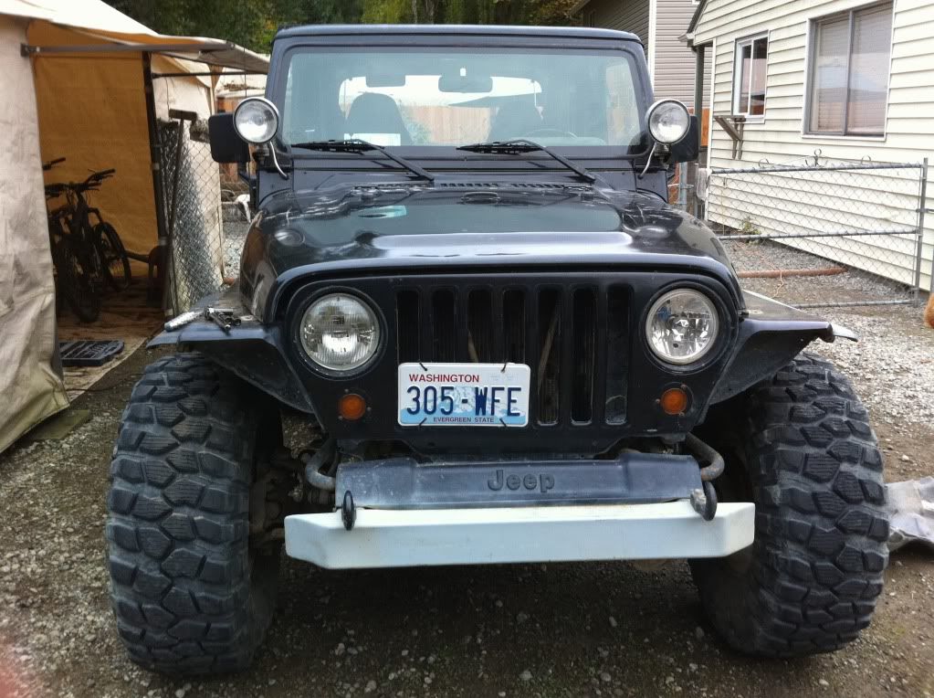

On one of my many trips out wheelin this year, I bent one of the body mounts. I tried to bend it back best I can but it needs to be cut off and a new one welded on.
Body lift removal....1" vs the 3" that came off. Yes, I just cut the pucks
Jack up the body with a block of wood, cut each mount individually and put the long bolts back in. Like this-
Don't forget the front puck, it matters!
Then let it down slowly, one side at a time. Remember to check the gas tank extension, steering shaft, both shifters, and other parts that come down the body but are connected to the chassis. I had no problems and everything works better than it did before.
All down-
Replace with the new, 2 inch shorter bolts. It will sit real low, like this-

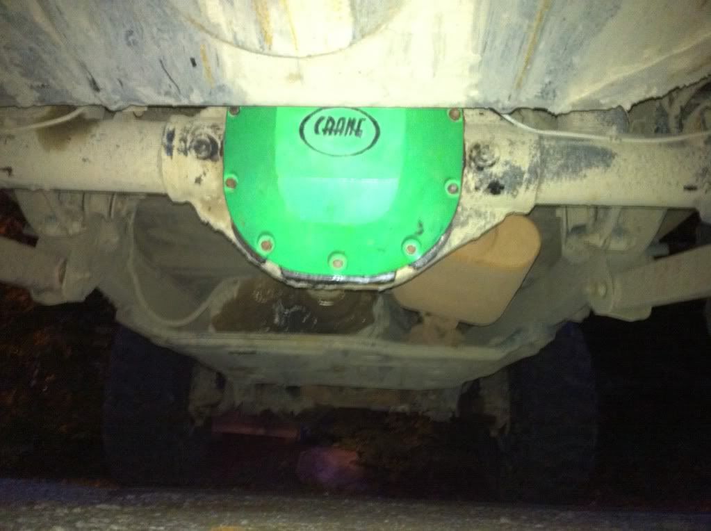

Almost forgot, 8.8 got some armor too-

Posts: 434
Obviously this is too low to be useful, so we need to do something
take out the battery and battery mount
next, the fender
gives you a blank slate
Move it up a lil bit, where you want the hood line to be now
gtxracer is offline
post #29 of 683 Old 10-22-2010, 09:24 PM Thread Starter
gtxracer
Location: olyWA
Posts: 434
A high line hood and fenders also means either modifying the hood latches or mounting hood pins...guess which one I chose
Those are billet so they're heavy and I don't think I'll be messing with them again...however I like the Jeep feel when you unlatch the hood so I might find a way to keep them.
