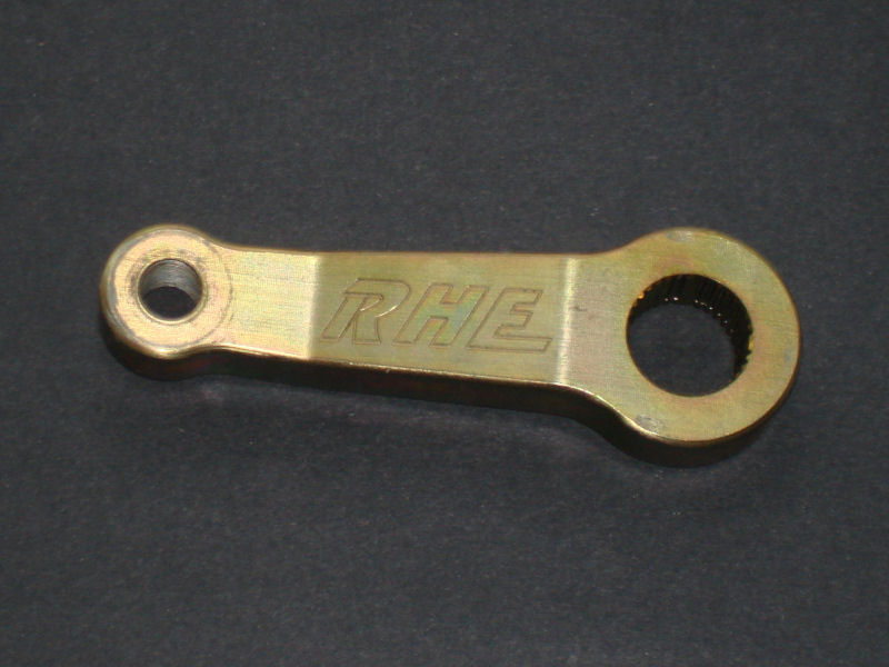

Got a chance to do some work today. Just ordered one of these-
http://www.hipoparts.com/products/NA...ering-Box.html
The TJ pitman arm is about 5.25" center to center, maybe a little bit more. This new pitman arm is beefier and 5" eye to eye. Should clear up a some room but have very little affect on my turning radius. For reference, the waggy pitman arm is 6" eye to eye but I would have to move the steering box. Maybe another time if I decide I want more steering.

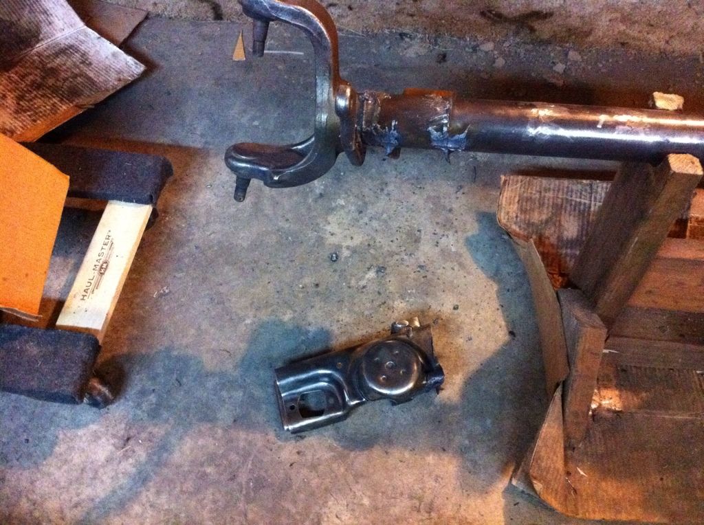

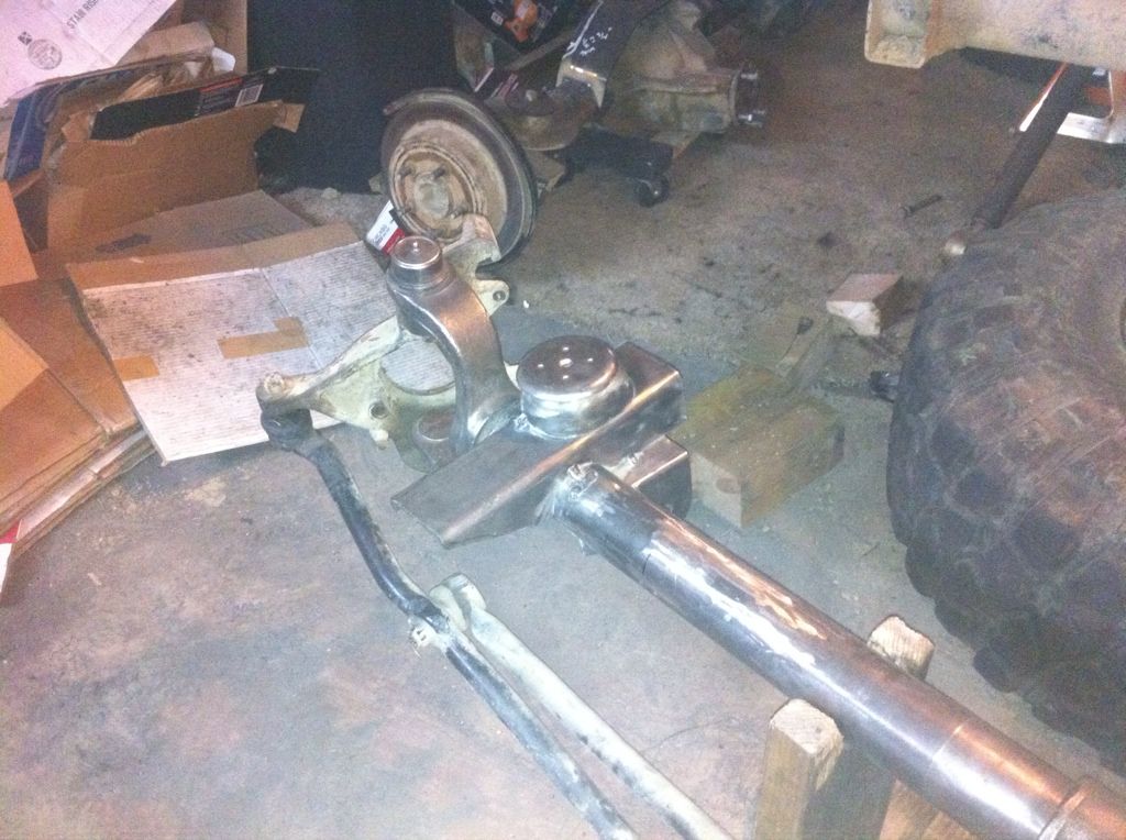

This thing fell off...
And then I made the tube smooth
Then bud light made an appearance
It was a bit tall, 1" to be exact. This would have built in a 1" lift to the axle. I decide I didn't like that and took it down 1". Made some gussets for it while I was at it.

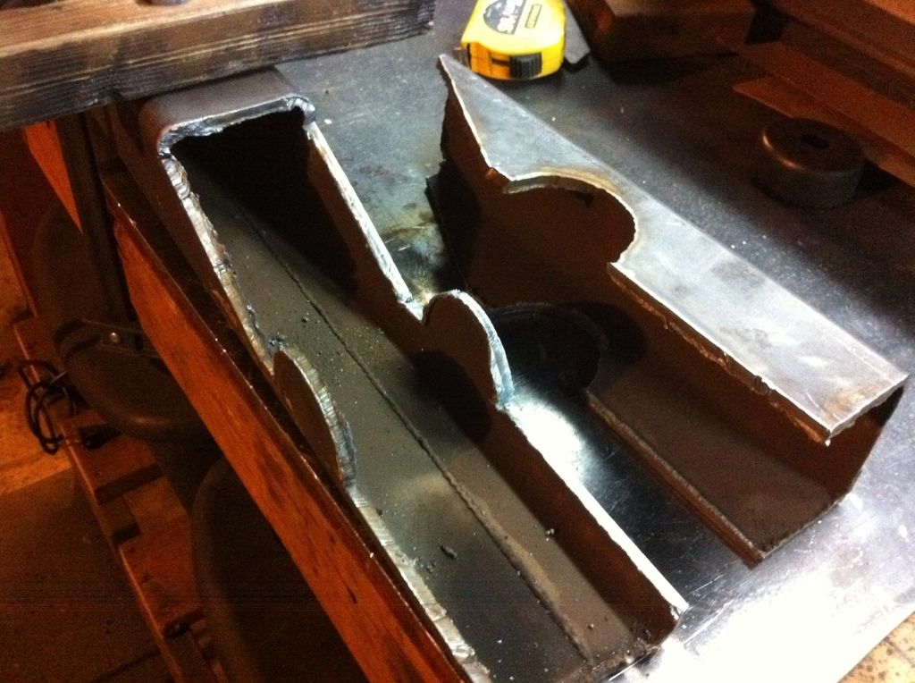

Cut it out with some plasma action
Cut out the spring retainer from the stock coil bucket
Lined it up, tacked it on. I want to shift it more to the outside before final welding since it will try to drive in when articulating
Then cut out the other one...

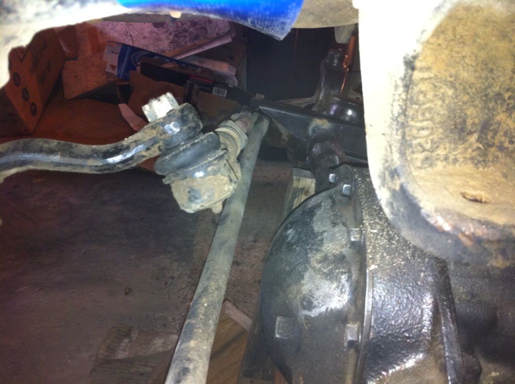

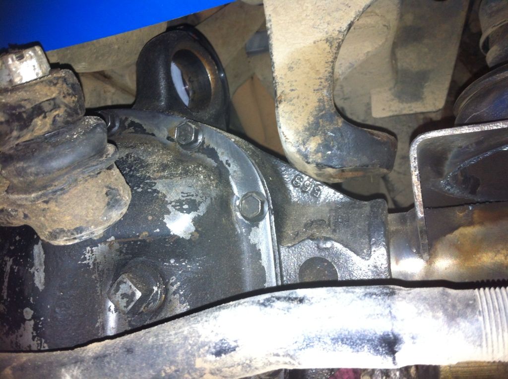

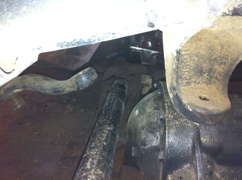

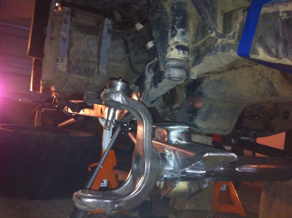

Today's update - bear with me, these pictures suck due to lighting but they show what's going on.

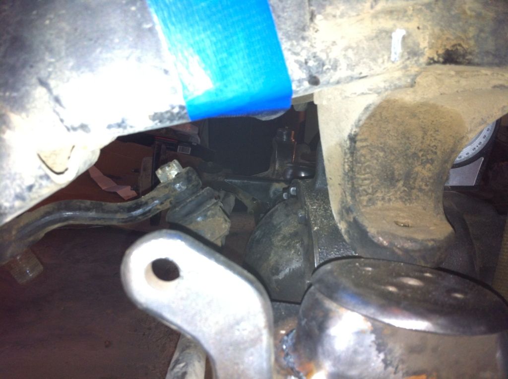

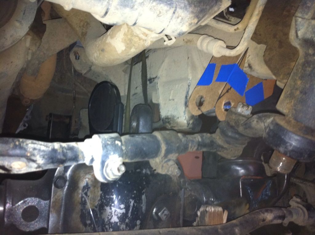

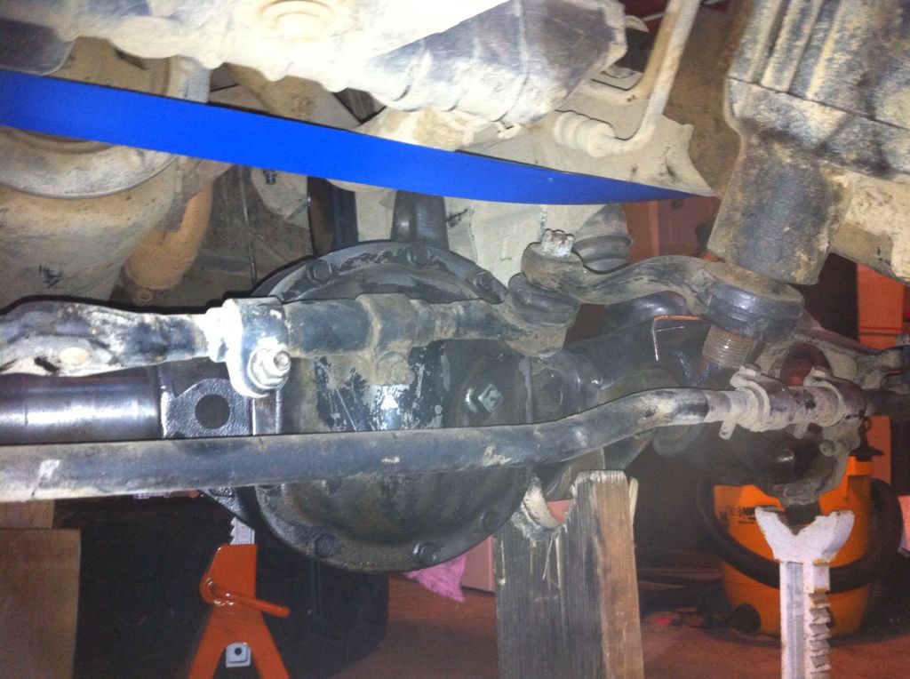

Bolted up the steering and stuffed the suspension to show what happens and how tight it is in there. Lucky for me I have some tricks up my sleeve for the track bar and pitman arm.
steering at ride height
stuffed, notice the stock track bar mount = has to go

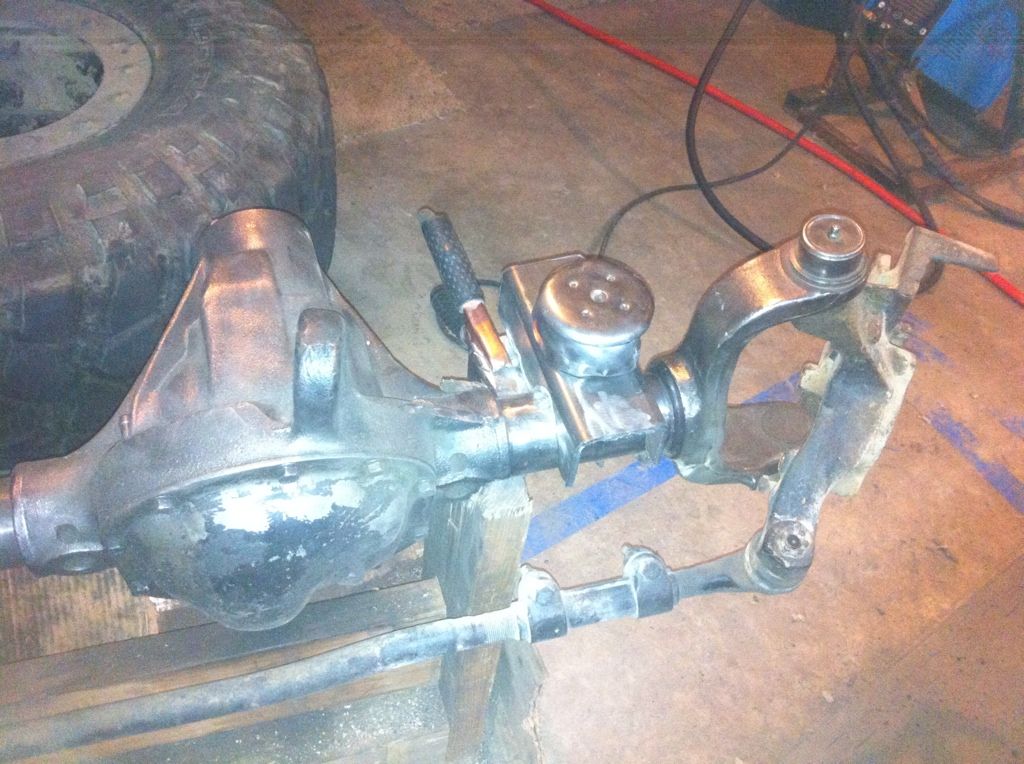

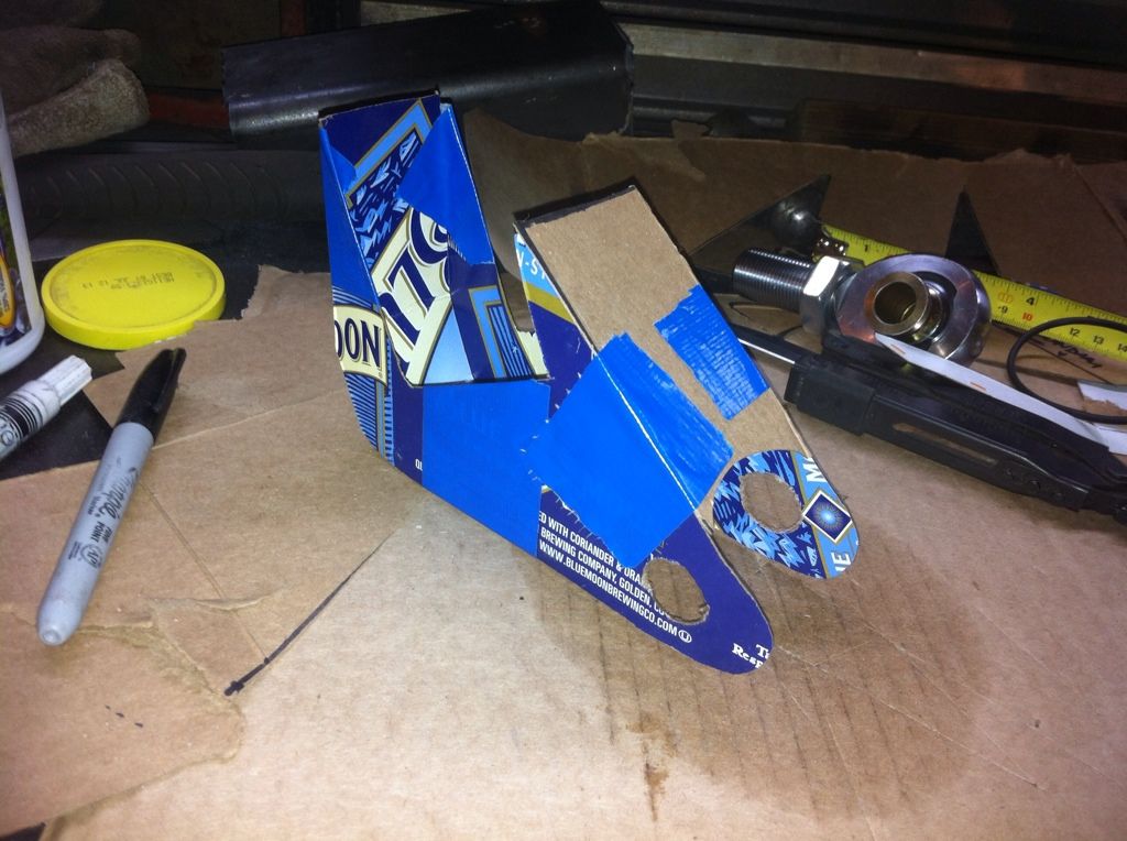

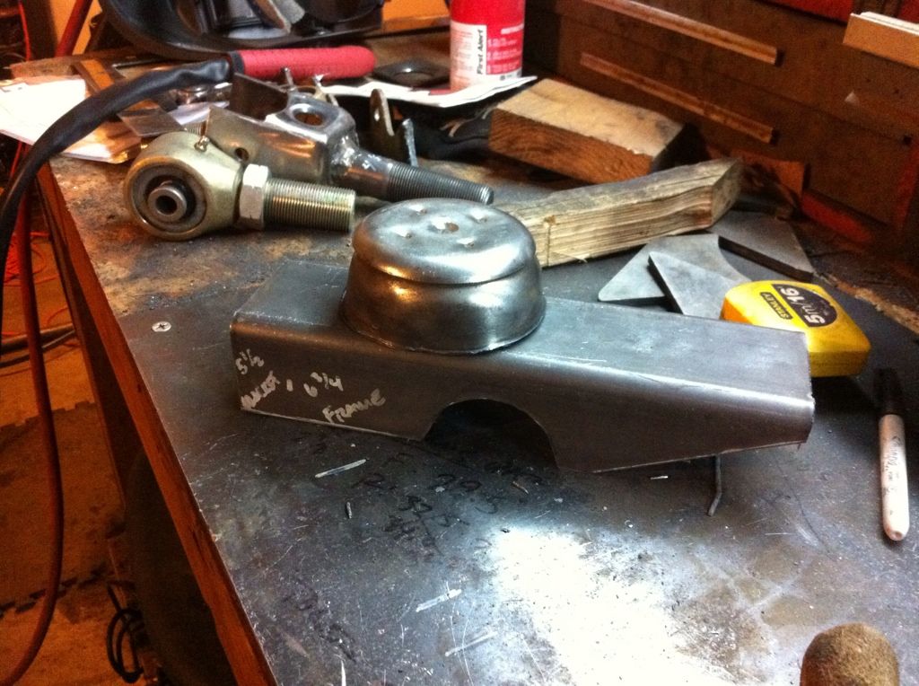

Started making the new track bar frame bracket. The track bar will be about 32.5" long for anyone wondering.
Came out like this so far. Today's sponsor is Blue Moon.
Mocked up. Came out well but I want it lower and think I will plate the frame at least on the outside and bottom. If not I'll design it with the same material I used for my suspension frame brackets.
Hacked off the other coil bucket on the axle and it took forever without the plasma. Took some pictures from the side so you can see why they were cut off. Overall, much easier to do it this way as long as you have a plasma cutter.
Some overall thoughts and observations from today and recently:
#1 - The rear track bar is a gigantic heartless *****. It's off...but I hate that damn thing. The stock track bar frame bracket can eat me as well.
#2 - The passenger coil mount is perfect. It needs a little trimming but then the steering will clear it completely. The shocks will mount on the back of the new coil buckets and should come out very well.
#3 - Because of the "kick" of the pitman arm and steering box, it shoves the steering right into the track bar basically. This makes getting a billet pitman arm a very good idea. A billet arm can be bent on a press safely to have the steering pointed straight down instead of kicked back.
