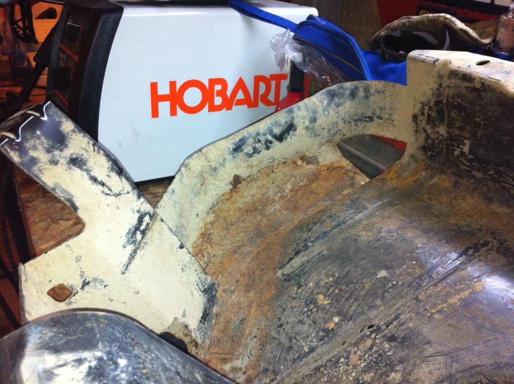

Then I took the tank out of the skid and scraped all the gunk off of it. Wow.

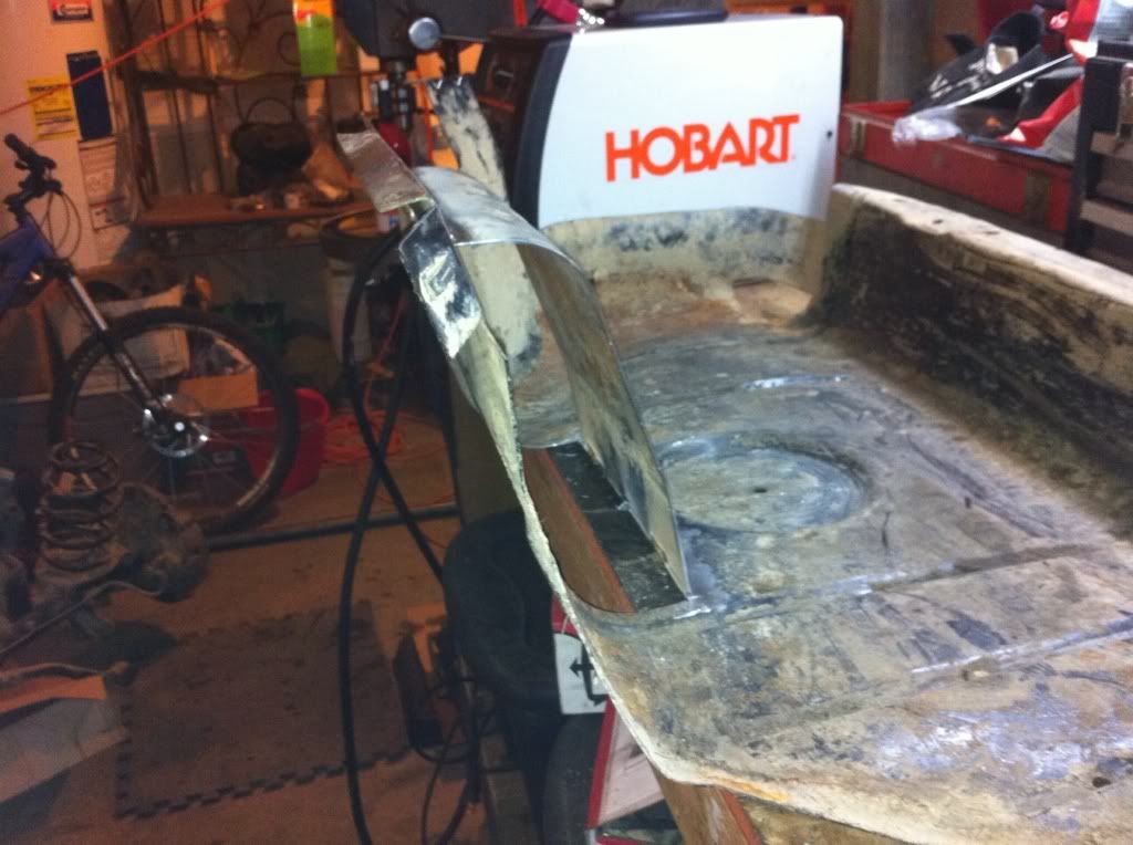

Made some cuts to clear the pumpkin. 8.8 cover is only about 3" deep so there was no point in making it more than 4" clearance. Need to grind out the welds and redo it tomorrow.

Really? You're actually gonna re-use that piece of cardboard ****? I hope you're at least plating the bottom or something.
Probably I have some 10g I can plate the bottom. I might raise it 1" and put some plastic on the bottom if I wanna get crazy.

This skid is trashed. I'm not going to try to salvage it, I'll just upgrade. A local guy, about 3.5 hrs away, has a warn skid for cheap but I don't wan to drive 7 hrs. We'll see if I can get it somehow.

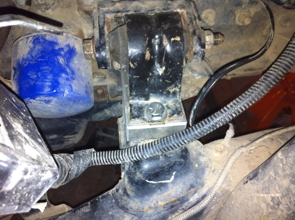

Got the motor mount lift installed, it's from Rough Country. Not a bad piece of machined aluminum, the finish was great, everything lined up well, and the instructions were well written. Very happy with these right now.
Started removing the stock brackets too. I hated these on my first jeep...and I hate them even more now that I smacked my hand with a hammer. Ouch.

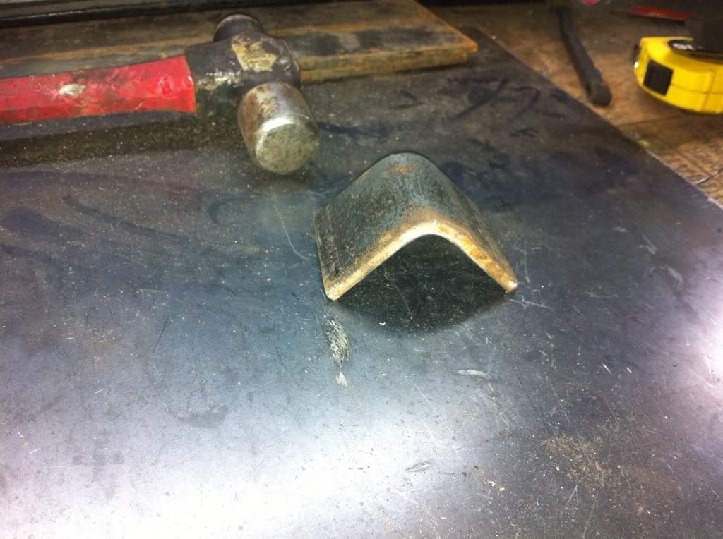

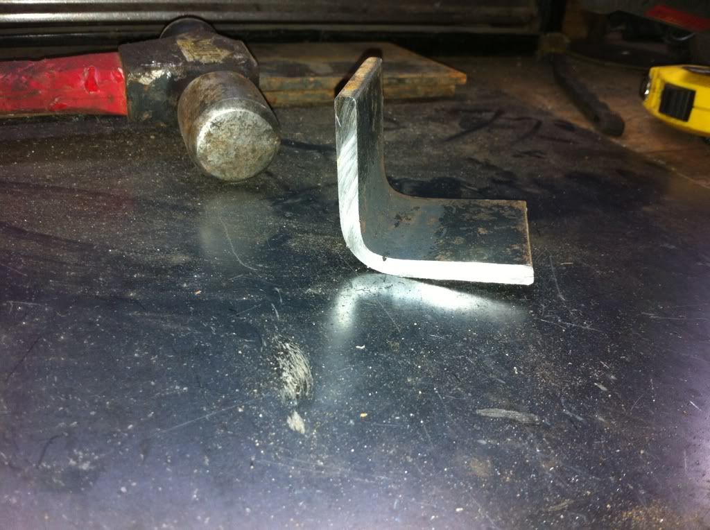

Got my swirl ring finally and couldn't resist putting it in the torch and making some test cuts. One thing led to another, the girlfriend had homework to do, which meant she was currently disabled from giving me....let's just call it "attention". Yeah, that's what we'll call it. So I dove into the deep end of plasma cutting utopia.
First up were the axle tube ends of the truss plate. Tried a hole saw but 20 minutes of holding down the drill press handles only to get 1/2 way through caused me to give up and focus on other things until today:
Marked it for the bends
Still needs some minor trimming and clean up but damn it came out good
