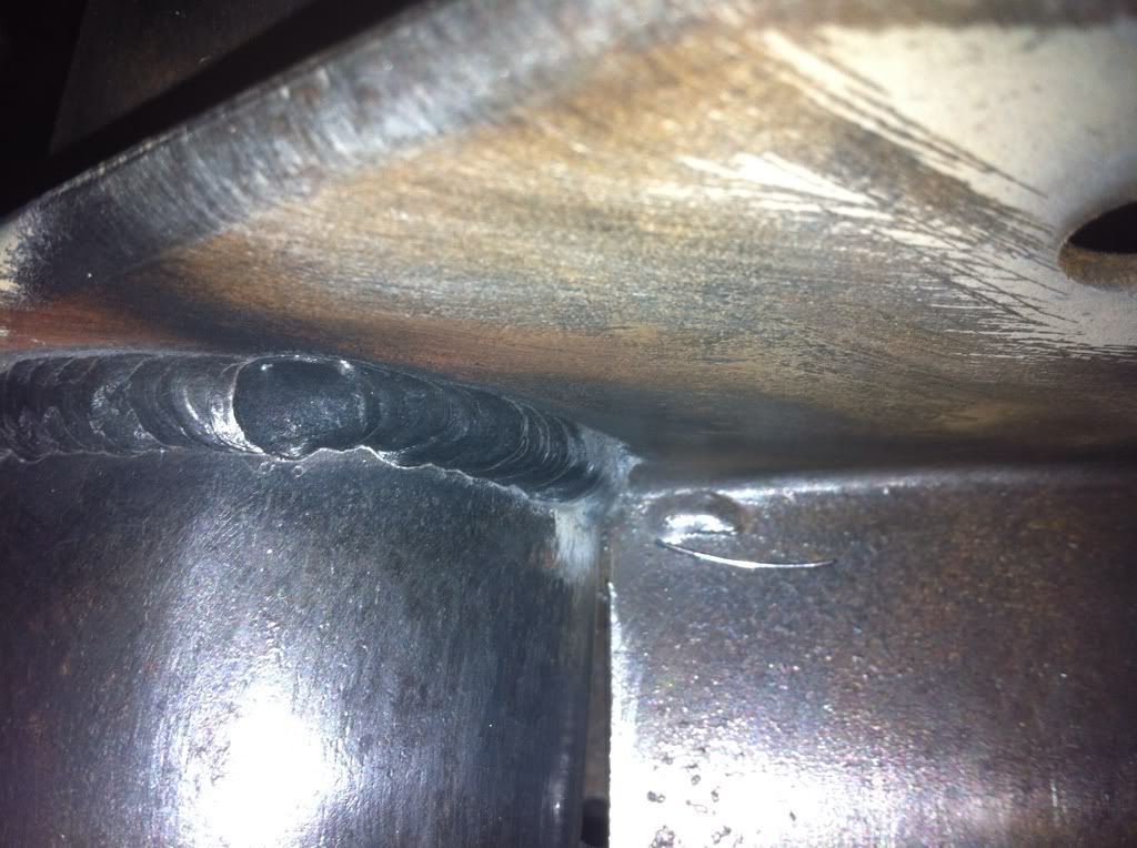

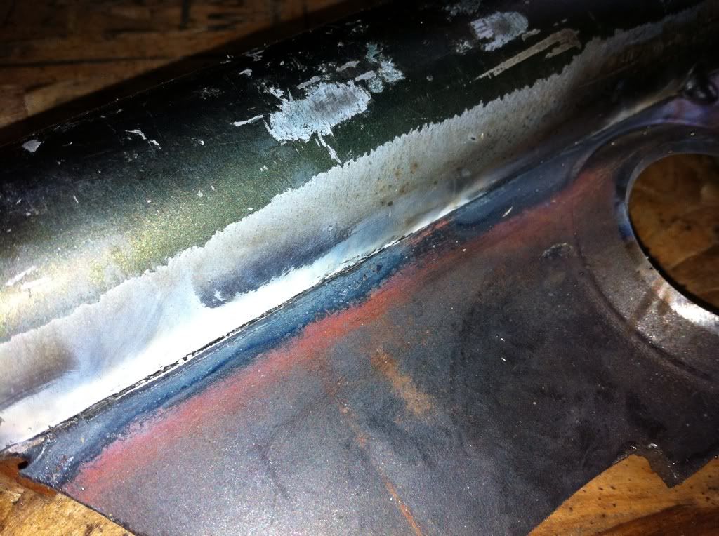

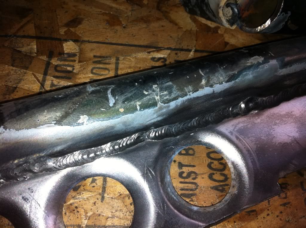

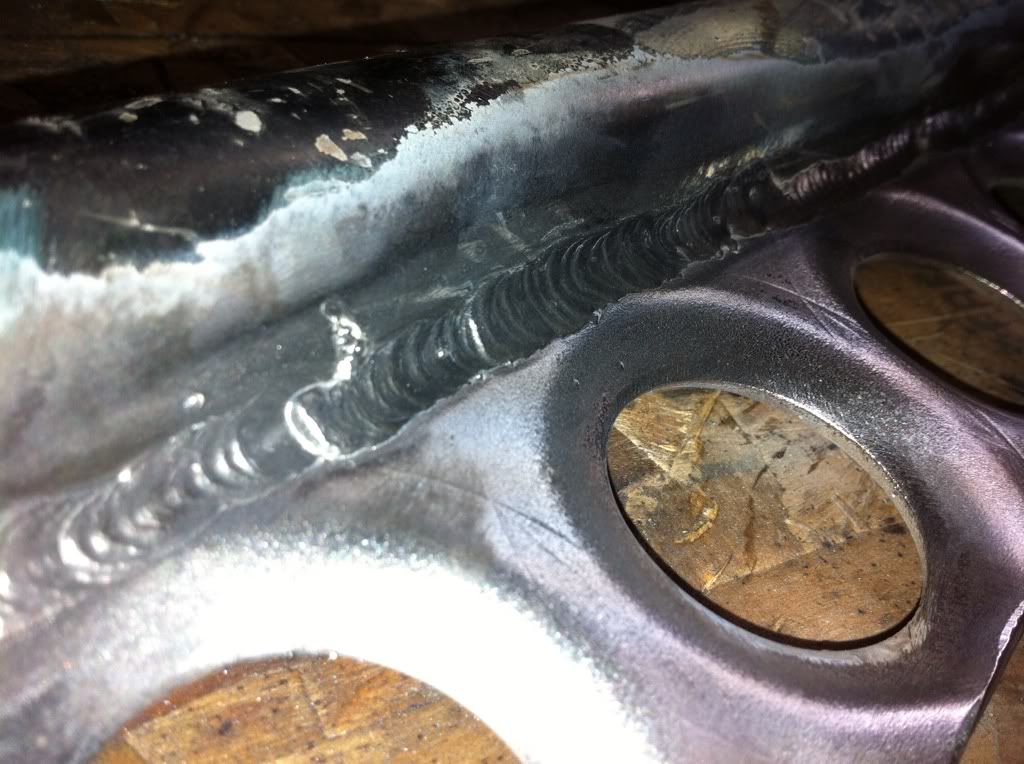

I started off by welding the filler plate to the tube. I don't think I got enough penetration but it will work for this application. I'm still getting used to the mig and what it can do. Here's some pics, they're not pretty but I'm getting better.
Heat from the other side
Speaking of the 30, this thing is filthy and I finally cut off the stabilizer bracket. The factory track bar bracket will probably come off later.

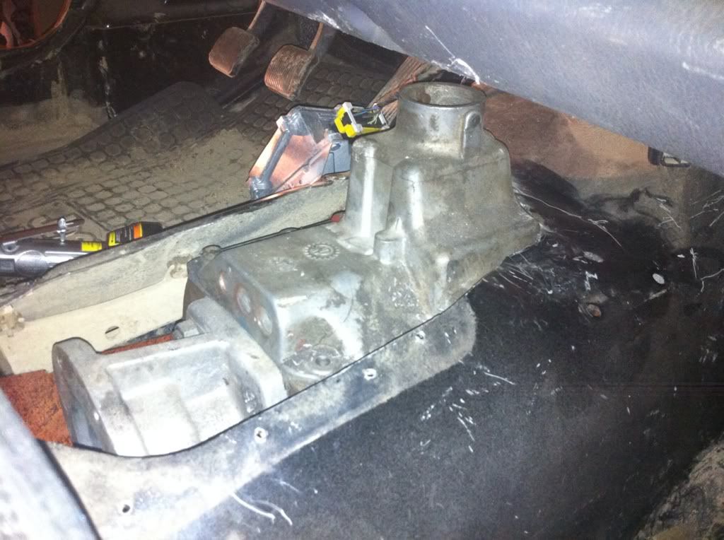

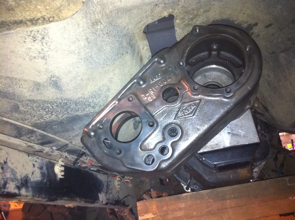

Then I started mockup of where I want the drivetrain to sit. As you can see, it's much different than the ax15 and much taller too.
However, I was able to get it mostly flat. I will need a 1" motor mount lift, which I'm ordering tonight. I was gonna go with a JKS kit unless anyone has other suggestions.

Here it is tucked in the frame rails
And squeezed tight in the center of the tub
Obviously the shifter will have to be bent at an angle but I have a linkage setup in mind for down the road

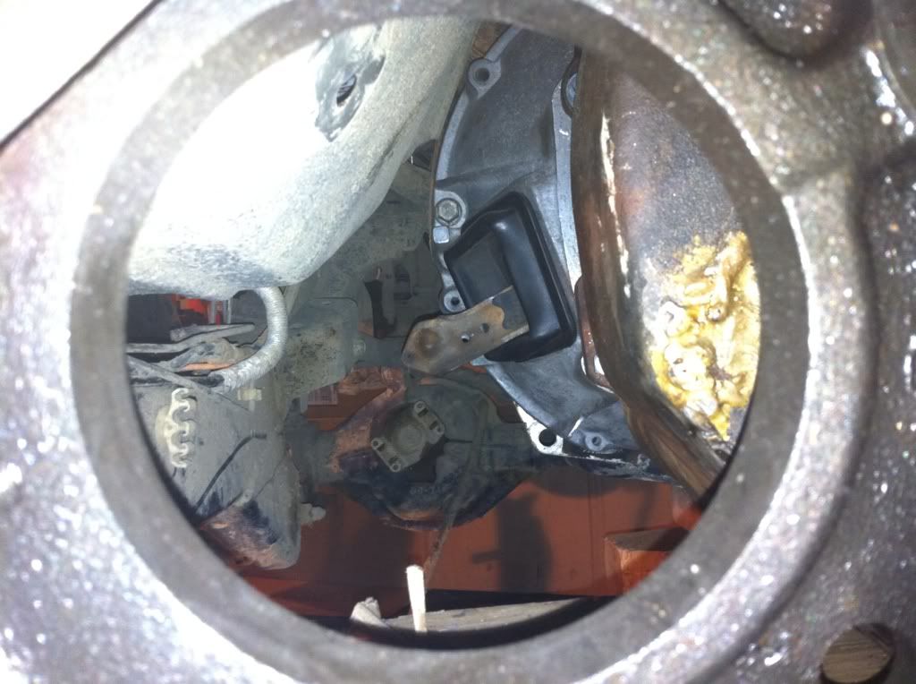

If you were the dana 300 front output shaft, this is what you'd see. Also why I need a 1" MML
The d300 won't need to be clocked as of right now. Hopefully this will be all it needs.
One last shot from the other side. Airbag module will need to be relocated.

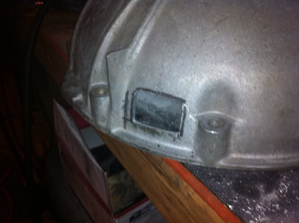

Got the CPS cutout marked
and cut

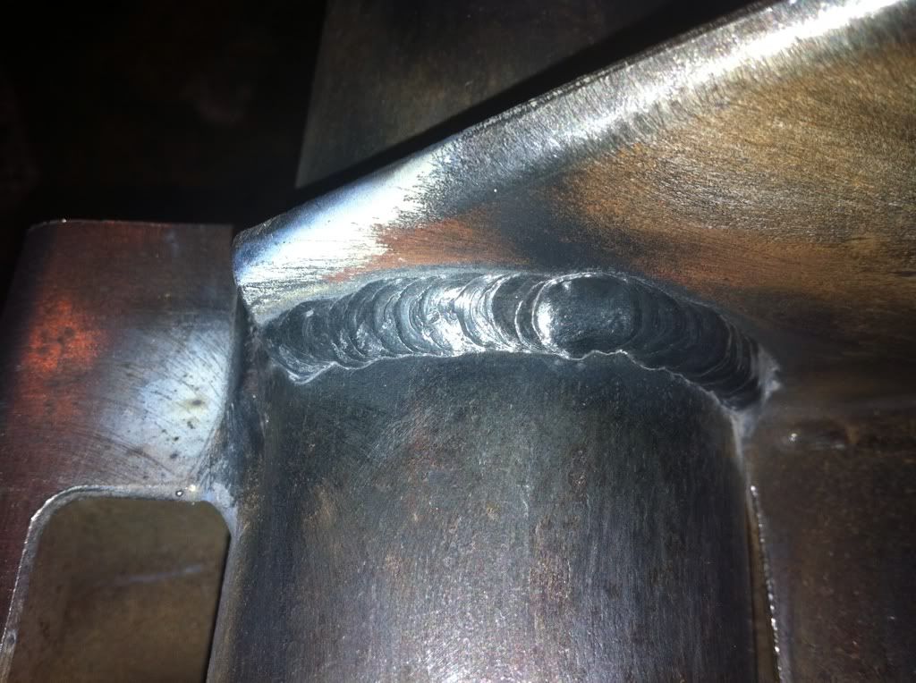

Welded the inside of the LCA mounts on the hp30. I wanted the extra strength there. I might plate them too, we'll see. My welds are getting better:

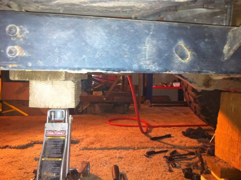

So I worked in the shop for 6 hours today and got the Jeep and garage prepped for complete teardown. The front is completely stripped and the jeep is fully on jackstands now. Had a scary moment when the jeep wasn't balanced well and I didn't have enough stands. I'll be picking up some 3 ton stands from HF soon since they're $20.

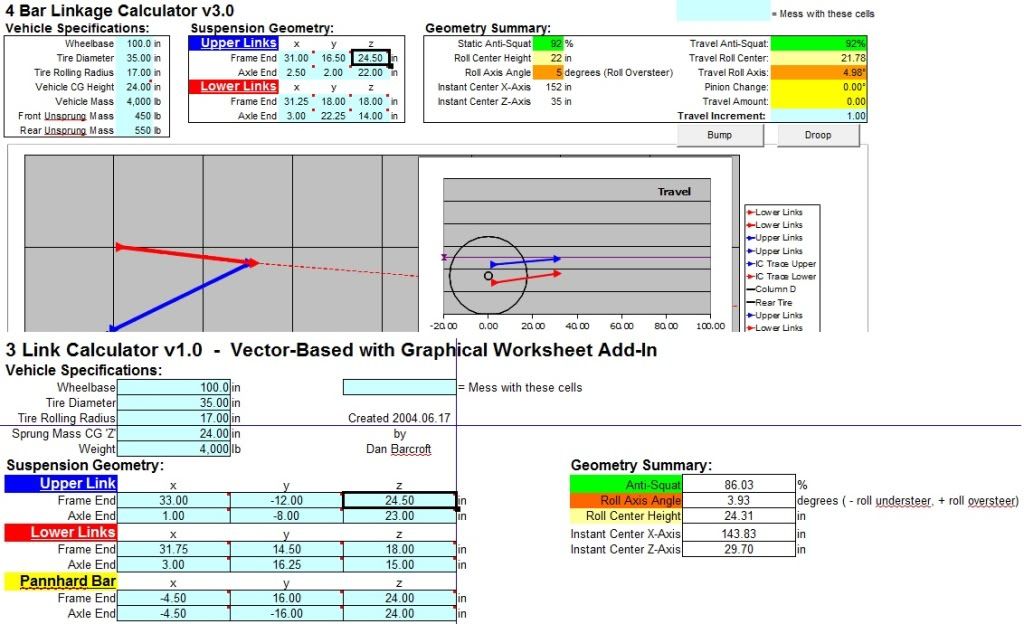

Updated my link calculators to reflect more realistic data and measurements. Needs a little more tweaking but it doesn't look bad.

Got another set of jackstands my tires/wheels under the jeep for more peace of mind.

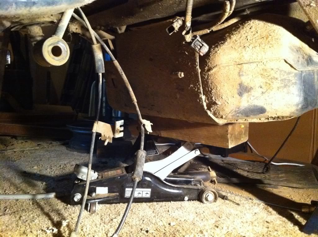

Then I released any pressure in the fuel system and started pulling the tank
But I broke this little Y...need to get another one
That's pretty much it for tonight. I didn't have much time but got a lot done. I can start cutting and modifying my tank as soon as I get it emptied, it still has about a gallon of gas in it. Anyone have tricks on how to get that last gallon out? A lot more work will get done as soon as the plasma is here. Hopefully I can get the drivetrain hung (when my mml gets here) and hopefully have the suspension tacked in place before I leave for 5 weeks for work. I think I'm about 1/2 way through this build and the last 1/2 will be all technical time consuming stuff.

Those supsension numbers look pretty good. Little adjustment to get a better roll axis but AS looks great! Keep it up. Can't wait to see it finished.

Thanks mallard. The AS should be more adjustable if I can stuff more separation in there. Not sure if I'll be able to get more roll axis or not. Still a good setup.
