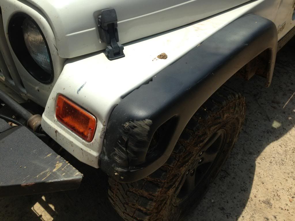

I got some PIAA 520's mounted up a couple weeks ago (I got one of them for $10), just now took a picture of them this weekend while I was doing a little posing while on a ride. I'm also including a few pictures from the trip. My only damage was a crushed fender flair.
