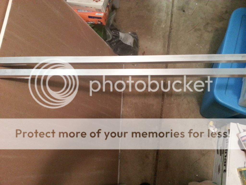

Picked up some aluminum today, to make alignments easier....measuring these will be much easier than measuring the tires. I think mrblaine posted the trick, or someone. Whoever posted it, thanks!...but I think it was Blaine

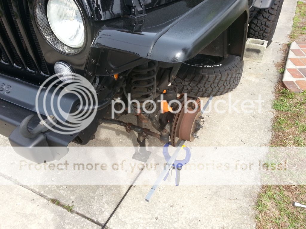

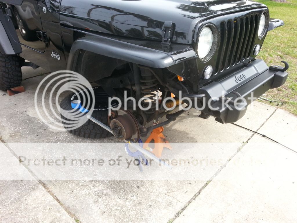

Did the alignment today; it was at just over 1/4" toe in...I'm glad I checked it
