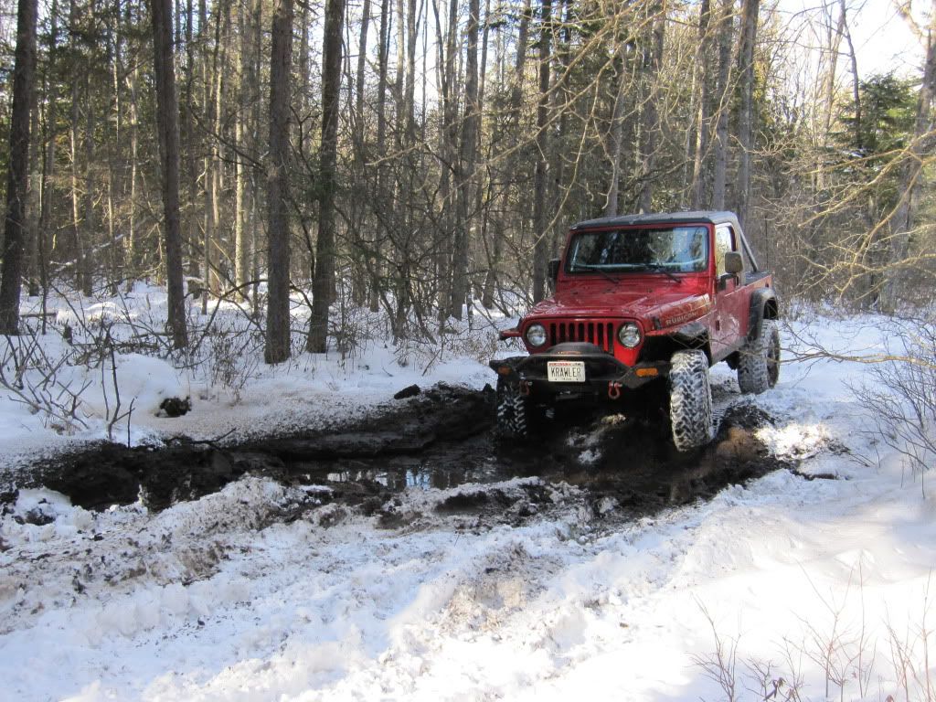

Did a little winter wheelin in Upper Michigan last weekend. Hard to believe we had mud when it was about 14 degees outside.
