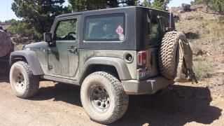

I decided to start this thread as a place for me to keep track of my progress on my Jeep build. I really do not anticipate too many comments (it's a fairly boring build). Constructive comments/suggestions are welcome.
Build goals: My goal for the Jeep is to make it a little more expedition-capable than it was when stock. I sometimes do some rocks, nothing extreme, but would like to get over an obstacle (or few) within reason. I've decided to keep the 33" tires for a while and mostly add to the comfort of traveling/driving. I'd like to be able to build shelves in the rear for my gear and someday a frige, as well as get a roof rack bracket set so I can transport my kayak. Primary goal now is to get it ready for the Rubicon Trail in Sept 2014.

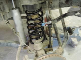

Installing front springs/shocks (effing hated that bolt up there):

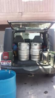

Rear cargo area with goodies from Brown Santa!:

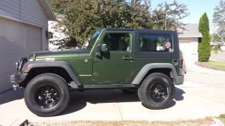

Before the lift (top) and after (bottom):
I netted about 3-3.5" of lift from the spacers and JKU springs

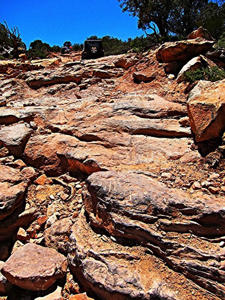

Top of the World, goneMOAB 2014
Random scenic photo from Top of the World, Moab, UT.

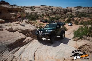

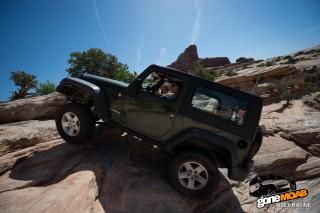

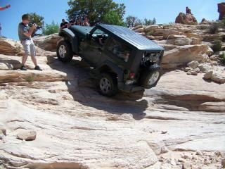

Wipeout Hill, Seven Mile Rim, goneMOAB 2014**
**Note this was my first foray into off road driving in my newly learned manual transmission :-P

Bought the Jeep March 2014.
Installed the lift end of April 2014.
Took it wheeling in Moab May 2014.
Finished installing Polyperformance brackets and brake line extensions end of May 2014.

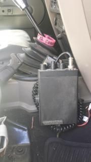

Also installed CB. Ran the coax cable through the pass side on the floor, under the front seat to where my CB radio is mounted on the center console by the stick shifter.
CB mounted inside cab

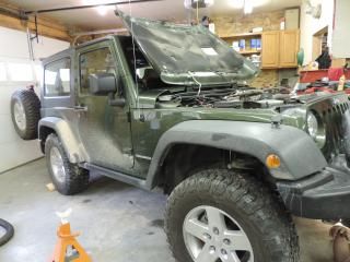

Lift install
Front is lifted. Still need to do rear:
Installing rear parts: shocks, springs, spacers

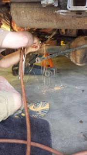

Cutting to install rear track bar bracket
Note to the wise- when installing crap, try to remember your safety glasses. Wearing sunglasses instead sometimes sucks. Derrr...
DONE!

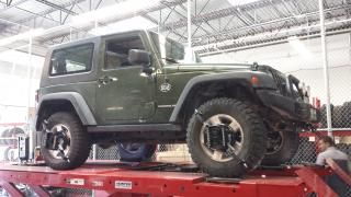

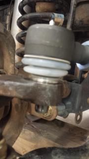

Well, I took the Jeep in to the dealership for an alignment after I finished installing all the lift components.
Lo and behold, the dealership ended up breaking/cracking the tie rod adjuster:
(bad photo, sorry)
Next day, when I took time off of work to pick it up, they tried to charge me for parts and labor for the adjuster. *sigh*
Reason #A LOT as to why I try to avoid working with the dealership.

Had my SES light come on yesterday. Jeep idles pretty rough and shifting/accelerating has also been rough. Went to O'Reilly auto parts to use their code reader (found out theyre one of the only places around that still has a code reader).
P0302: #2 valve misfiring.
I did some research and found it could be a variety of problems. I checked the wire clips and wires inside the engine bay to make sure none are getting fried. They looked good to me.
Next step is replacing #2 spark plug. Now, i dont know crap about engines, so i had to look up plug order and how-to on changing the plugs. I also made sure the gap was correct on the new plugs. It was .045, so we widened it to stock .050.
If replacing that doesnt fix the problem, i'll move on to the fuel injector. Hopefully it's not an expensive fix.

Replaced #2. CEL/SES went away. We'll see how long it stays off. If it comes back, I'll replace the rest of the plugs and check the connections.
