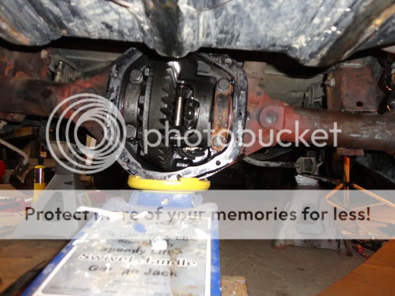

Well not much is new beside my Yukon pile is getting larger
Alloy USA 760 with 3 year warranty and full circle rings
4340 inner and outers

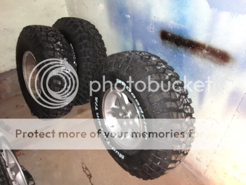

33x10.50 km2 was a spare tire so I'm just going to pair it up with 3 new ones

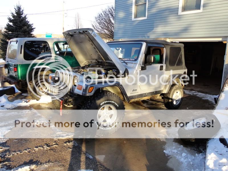

So I installed my front 2.5 springs and shocks up front, but took the spacer out because I didn't want it to be too tall. Well It barley lifted t so I'm pissed I have to take it all back apart to reinstall the spacer. I think for starters I'm going to install the rear springs and shocks and go from there. Measure and decide what spacer i ned up front to level it out. I plan on doing that this weekend.
Because I either have really tall factory rear springs or my frames bent, either way it still sucks monkey dick.

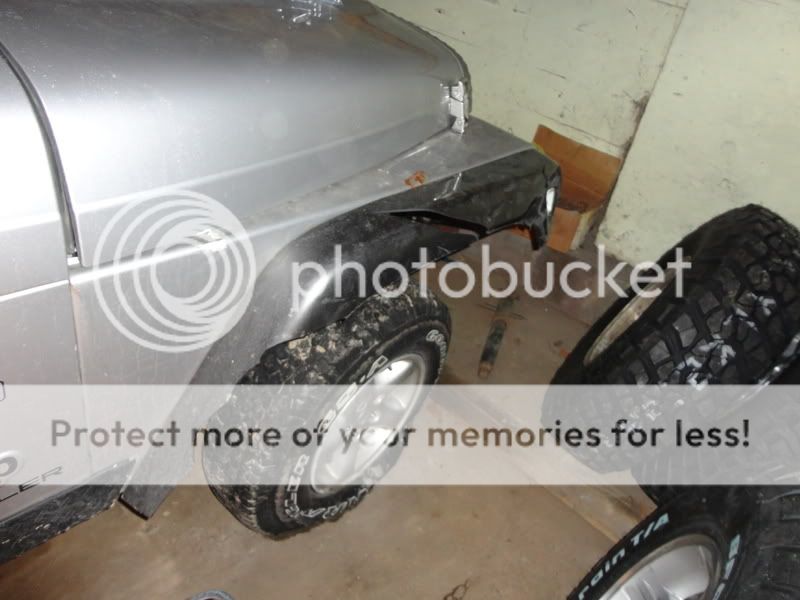

I wrecked it pictures later today
Well I should have left it in 4wd but I didn't. I was on the highway and hit a bump. Got a little squrrily and got it about corrected and bam passenger rear hit the wall and broke the axle and spun me around as I watch my rear tire in the distance. Should have never happens but it did I blame it on my self, stock tires, and mainly; one of the rear shocks that is disconeccted because of a broken bolt that was/ is getting fixed this weekend.
So the damage, to me it appears the body is unharmed, both passenger flares shattered, passenger axle snaped off at the drum, pealed a rim up like a bannana, and a tire got a hole in it. So it appears this axle swap is happening tomorrow. I'm heading down to work to regear it and get it ready.

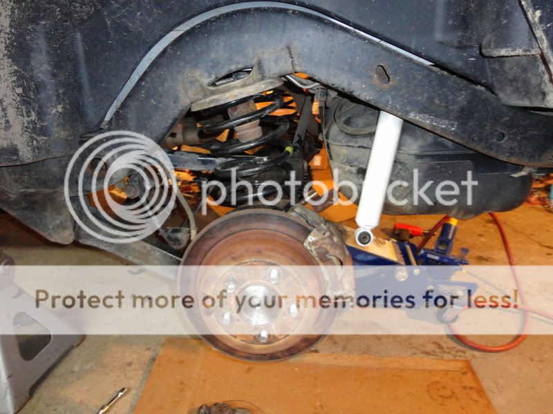

Got some work done today but just kind of kept getting stuck with the rear axle. First off went I regeared it at work nothing went right, couldn't find the right bearing kit, couldn't find the right thickness of shims, and pinion seal wasn't right in the kit and no parts store in town had it so off to the jeep dealer. Got the right seal and bearings installed. Also I found a ubolt yoke at work so threw that in too.
The main reason I was thinking all day is because I'm putting rear disk on a drum brake housing I think, anyways I couldn't figure out how the outer axle seal was held in. Basically just a **** show. But I got it figured out had the axle retainer flanges on backwards so I pressed the bearings back off flipped around and added a washer between the brake backing plate and retainer plate to make up for the dust sheild that I'm missing. Its working so far.

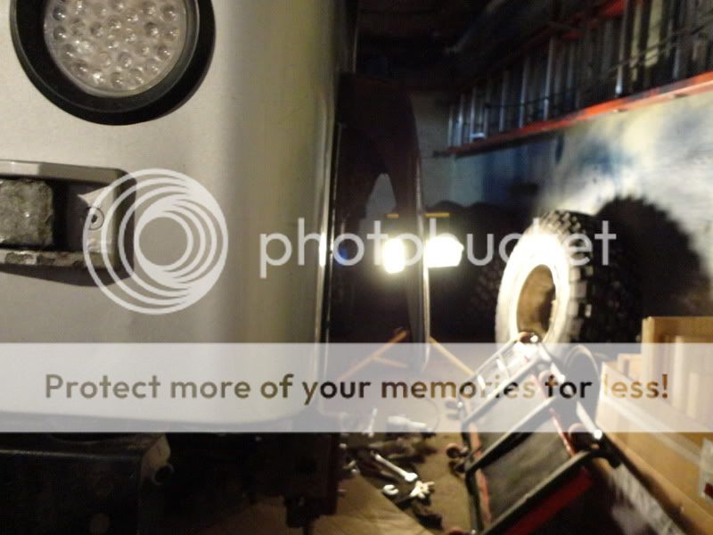

Picture of wreck from my pod
