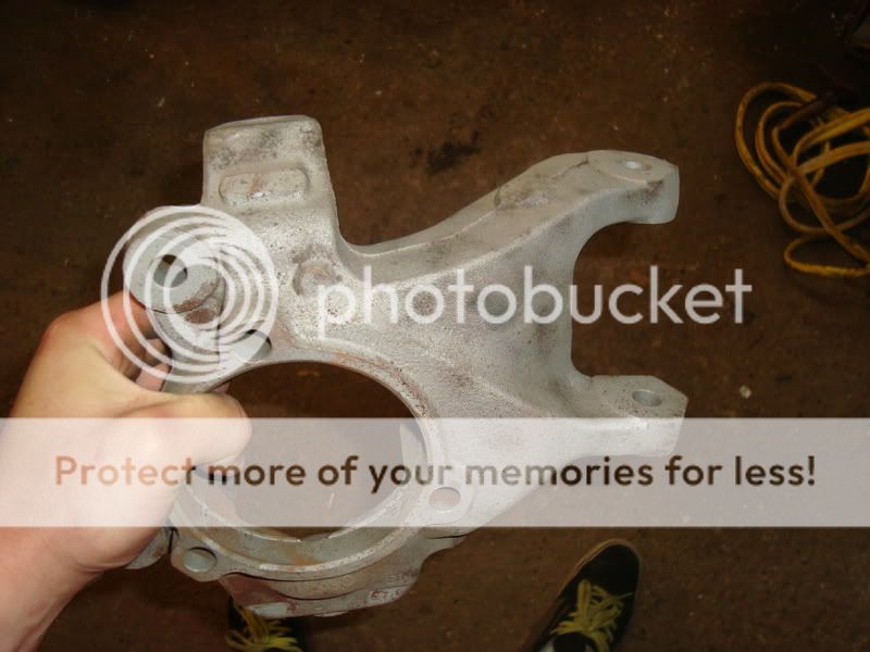

The front:
Dana 30 hp from a cherokee = Free
Used hp 30 3:73 gear set = ??? havent found one yet
wj knuckle swap. Wj knuckles,calipers, steering, and rotors = $50
truss the inner C's and truss some axle brackets too = free steel
new ball joints and axle joints = ?
wheel bearing spacers = $36 for both sides
Rear:
04 tj dana 44 = $50
needs to be retubed, 2ft of 2 5/8 od dom $86 :O
3:73 gear sset with trac loc = $200
Chromoly axle shafts = $230 to $250

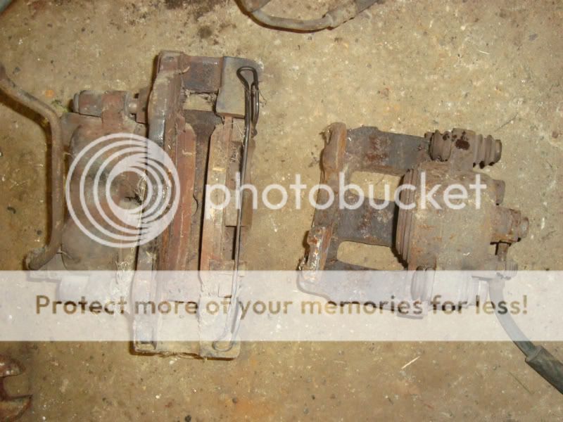

rear disk brake conversion with parts from grand cherokee dana 35 = included in the kunckle cost
Rear pads and rotors = ??
Still undecided on steering, i would like to do a tie rod flip with 1 ton tre and dom tubing. but who knows. Here are some pictures to keep you tied up
Another reason for the swap built in high steer, not like i need it but its always a plus

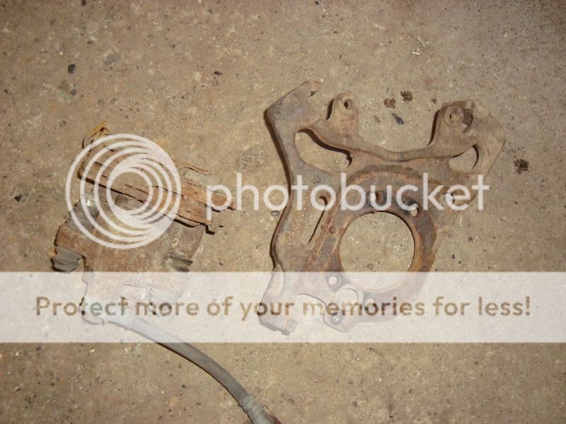

Here is the rear caliper and mounting bracket for disk brakes
Here is the main reason for doing the wj knuckle swap :0 the huge dual piston brakes

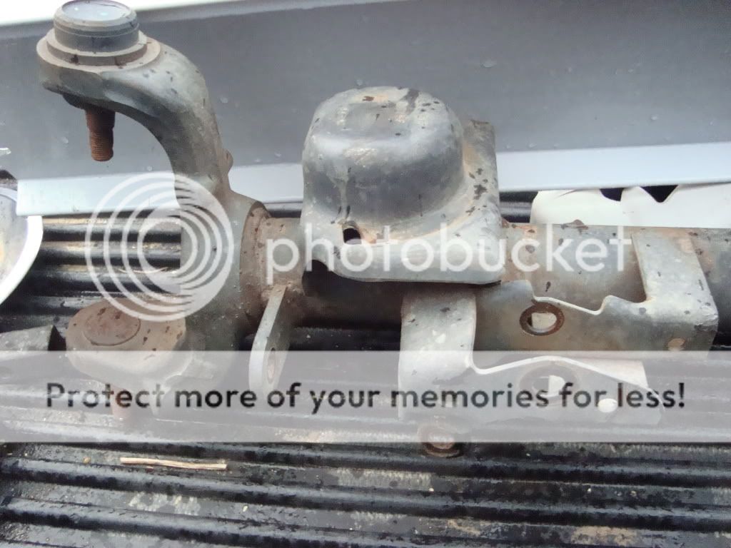

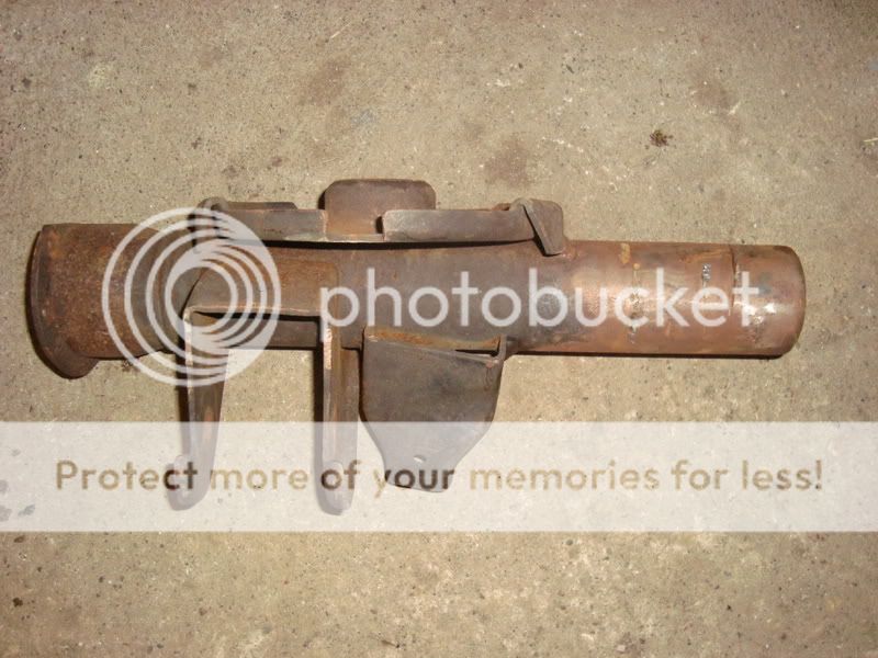

here is what is left of the passenger side tube. i just dont have the housing at my house right now

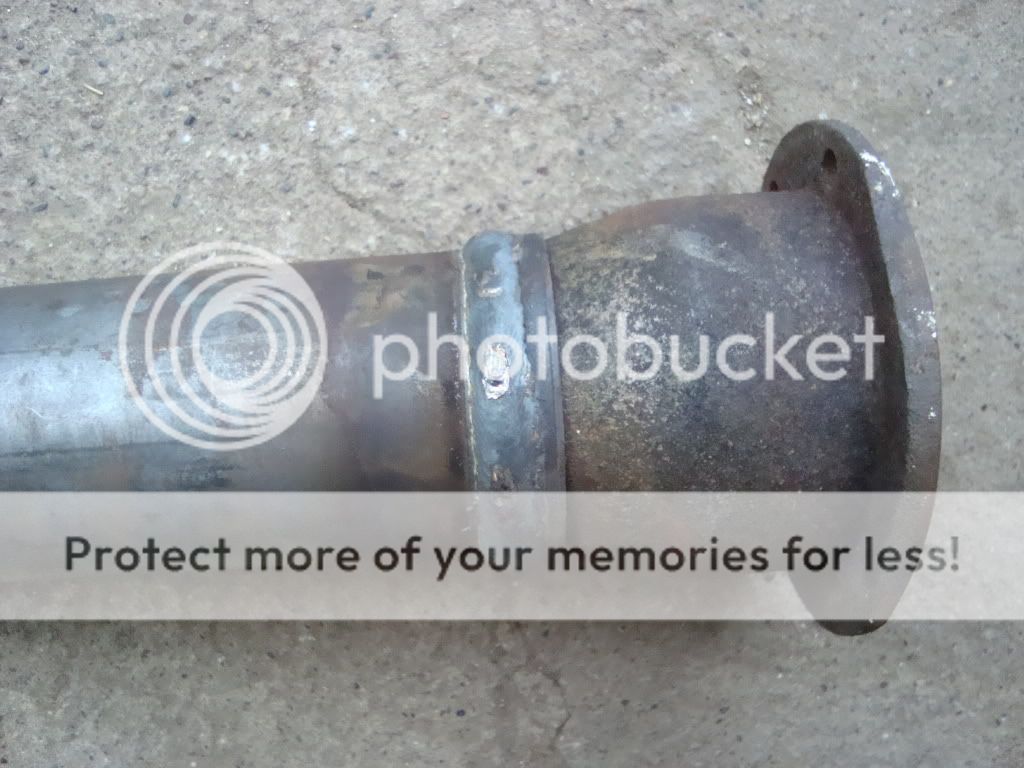

And here is the flange welded on the tube for the 44 :rock2:
