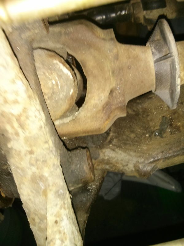

Then I decided to attack the 12pt hub bolts on the "new" d30, been blasting them for a week. came out moderatly easy. didnt think I could apply enough force with it on sawhorses to pop the hubs, but I used a trick to wedge a bolt between the C and the outer axle yoke thing and turn the wheel. since theres no wheel I turned the BFH and they both popped easily! Turning out to be a great afternoon in the frozen garage.
One thing I noticed is the axle yoke is way different on pass side than the driver side, much thicker. (the inner one) is this normal or maybe it was from a donor?
Drivers side, thinner
Pass side, beefier
