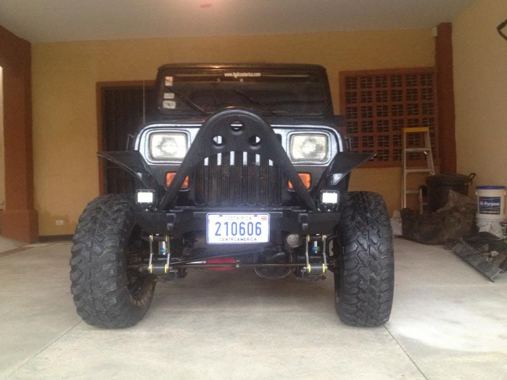

I wanted cloaks until I realized its 500+ another 250 for the outers! right now I have 31 mudders that i plan to run at first until they wear down or they look absurd, then i will sell them and get nothing more than 35, settle for 33 too.
there was a post in wdydtyyjt awhile back, some guy in costa rica with an orange yj who did the only good trim job ive ever noticed on the stock fenders, been looking for that post.

Finally found the post of the guy that cut the fenders and made it look good, posting here for reference. looks better than flatties IMO

This is how I cut mine.

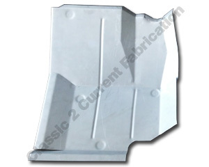

after days of wrestling that crappy "folded" floorpan,
new one
and my mistake of trying to buttweld such thin metal with flux core, I said F it and ordered the nicer stamped one today. I will drop it in with a small overlap and plug weld and seam seal it. its not like me to give up, esp when its money down the drain but I guess thats why you call it trial and error :O
Plus you can see on bottom right the black one has more coverage up that hump, where I had a gaping hole to fill with old pan. seen here
