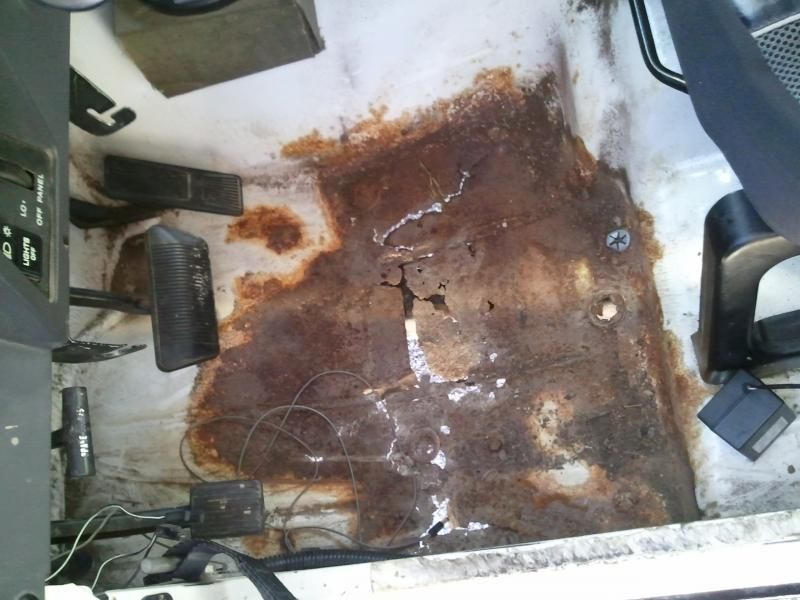

Not too much going on. I pulled the carpet this weekend so I can get to work on the floor. driverside has a new pan on the way, rest isnt too bad.
The sad part is when I bought it last year that rust was only half that size and I parked it over the winter to keep salt off! I think the carpet is what causes this, wet shoes on it and it stays damp under there. the rust is from the inside out believe it or not, underneath it only looks half that size.
