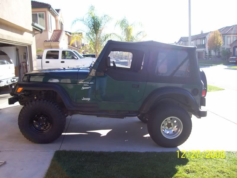

My 1st, 1997 TJ 4'' lift (pro Crap) and 33's. Deciding which wheel I like better:

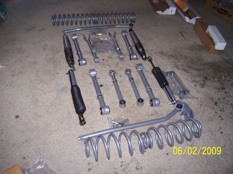

This taught me I had to have a lift. I knew I wouldn't go long arm due to the fact I wouldn't be able to bring myself to cut off the lower control arm mounts. I mean they only made 1000 of these things. I decided I wanted a Rubicon Express short arm 4.5'' SF with 3.5'' springs. So many people spoke so highly of it, I had to have it.
I scoured the internet for the best price, talked to Jason at 4x4 group buy and dozens of others. When it came down to it, the lowest price I could find was 5 miles from my house.
The complete kit (w/adjustable lowers) delivered with all California taxes was $1100 + $275 for the monotubes. I added an adj rear trackbar & bracket for $180, upgraded to adjustable lower control arms & added a TW DS.

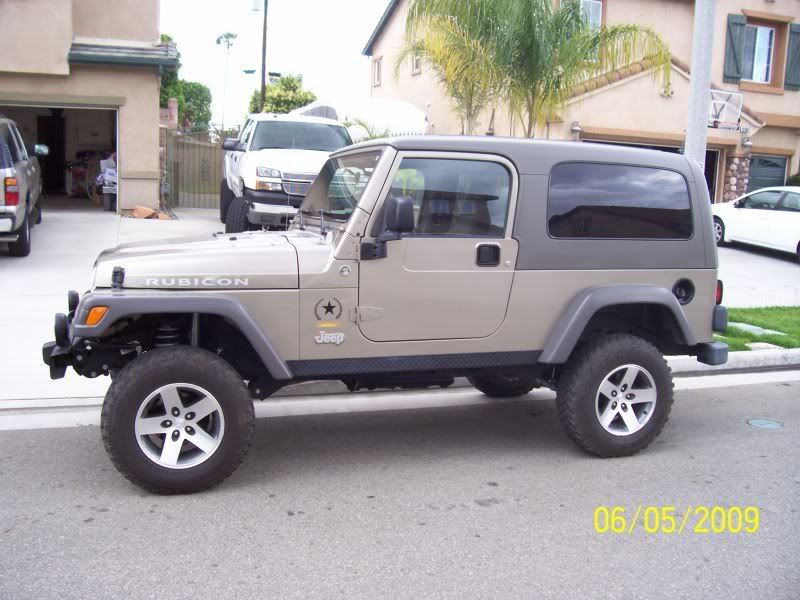

Picked her up from the shop this afternoon.
Before:
after
Currently sitting 5" higher than stock all the way around. This with the Rubicon Express 3.5'' springs. Only time will tell how much it will settle.
The lower adj control arms are set at 16'' on center and this still leaves the rear axle slightly forward of being centered in the wheelwell. Here's a picture looking straight on at the rear opening:
Going to put some miles on it before I make any adjustments to the arms. The stock 31's are looking pretty minuscule.
Ride impressions. Very firm. I expected this, especially with only 20 miles on the suspension. Seems to follow the crown of the road more than it did. Took it up to 75 mph on the way home and not a vibe to be found. The TW driveshaft is awesome and the shop must have done a stellar job on the front end alignment. No complaints. Now just need to get out and flex it so it settles. It's pretty high, could probably fit 35's right now without a bodylift.
Marco
