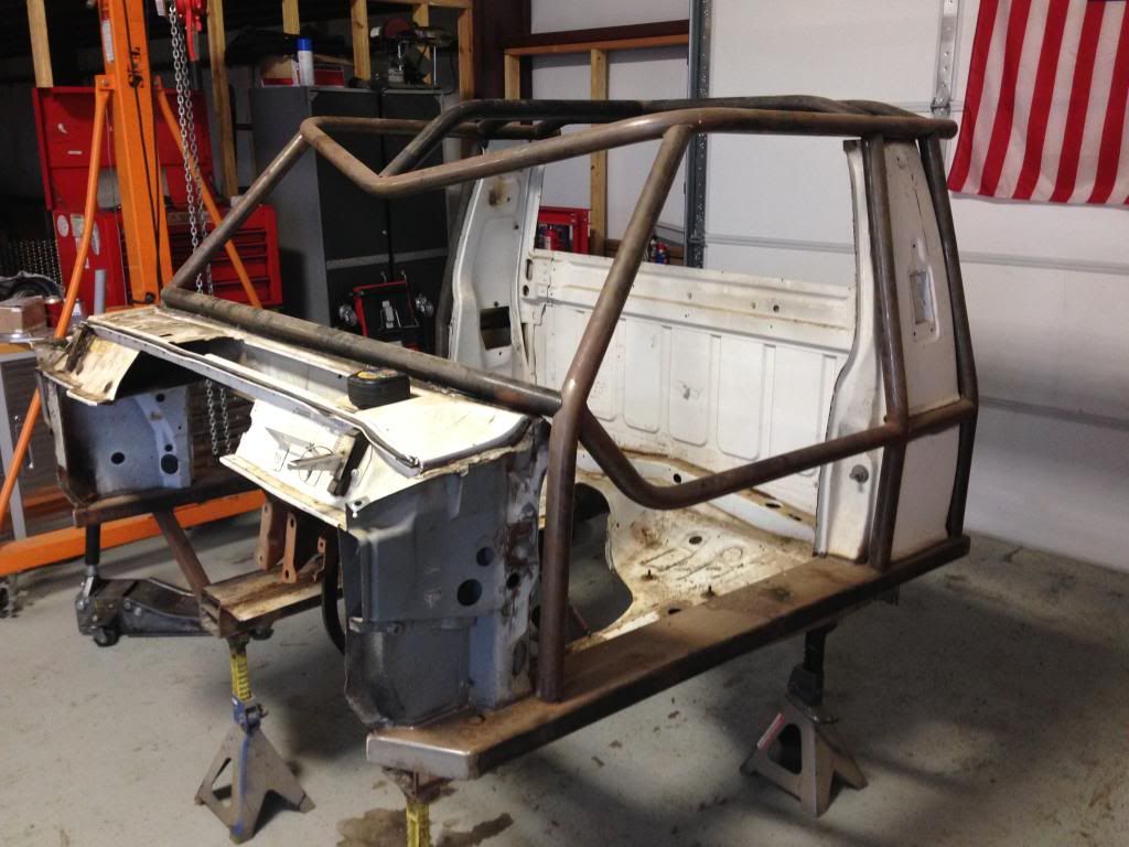

and the current sad state of the MJ...

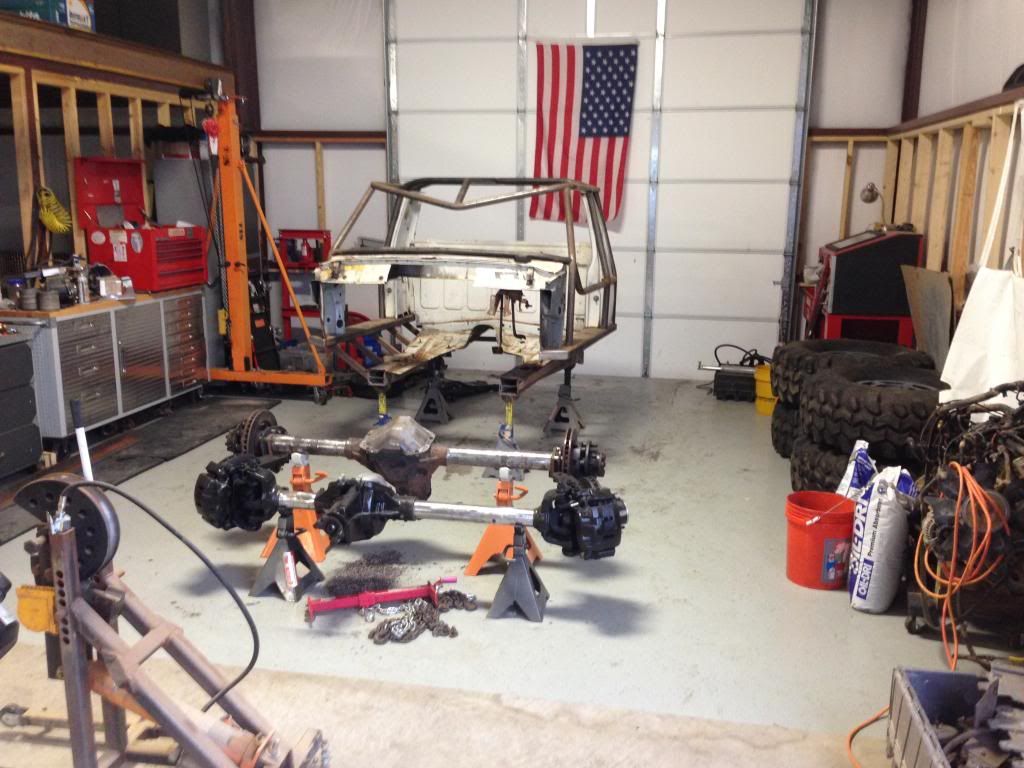

next i got the axles moved out of the shed and cleaned up, a year of sitting had rusted most of the parts and the chickens had crapped all over em. The 60 had been completely stripped prior to my "hiatus" so i blasted all the parts, primed, painted and reassembled the outers and ground the tubes again
The 14 bolt never got fully stripping so out came the torch again and it got the same treatment

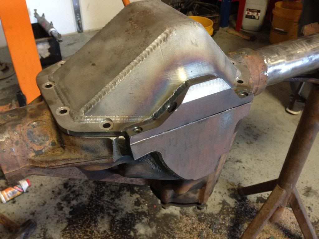

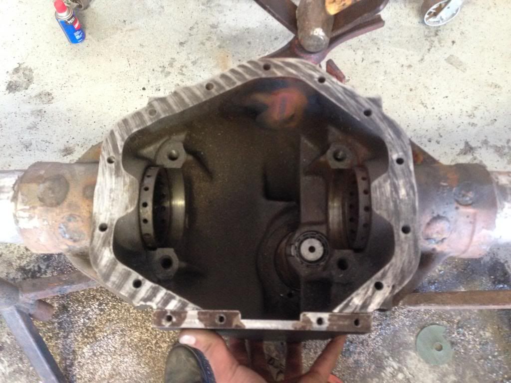

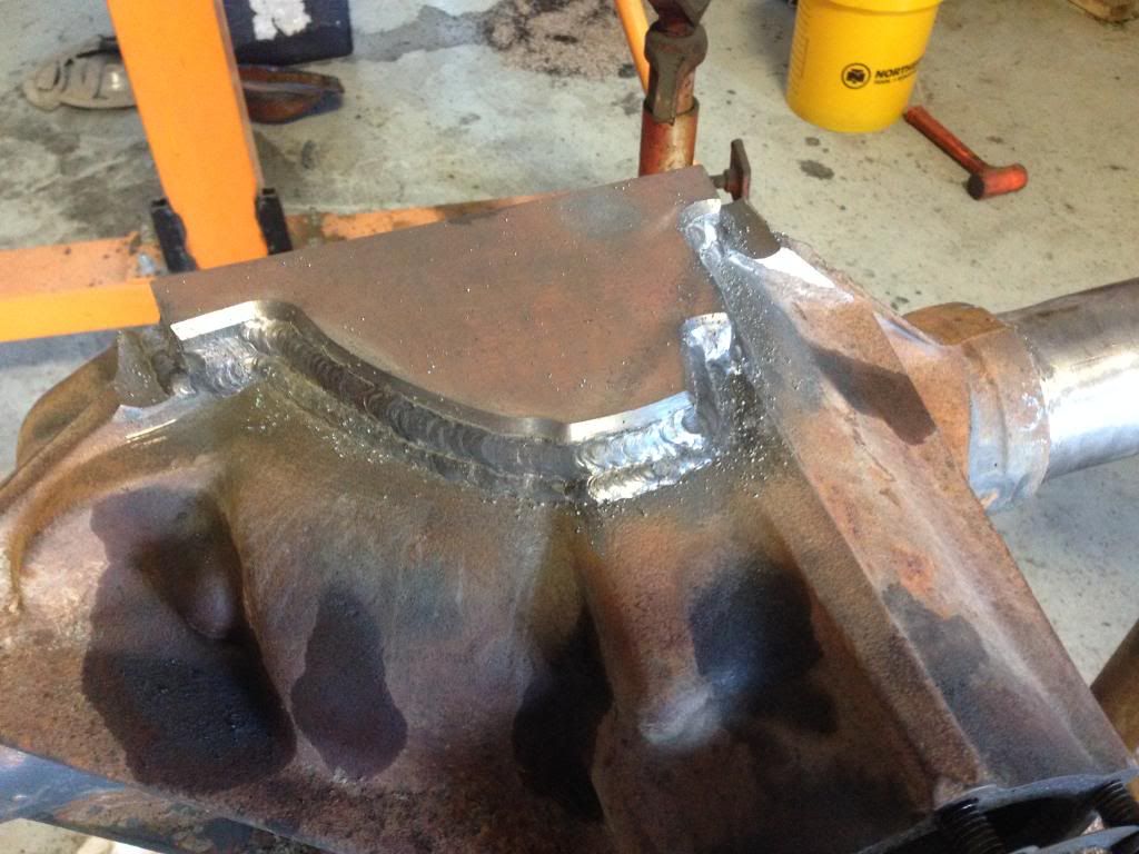

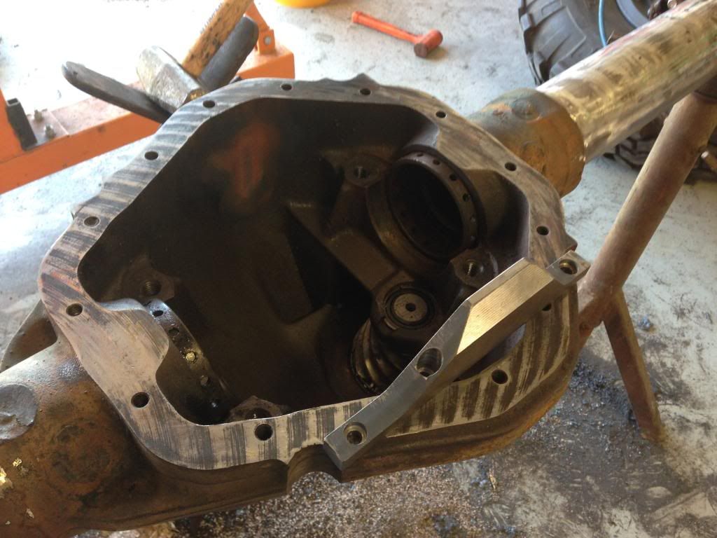

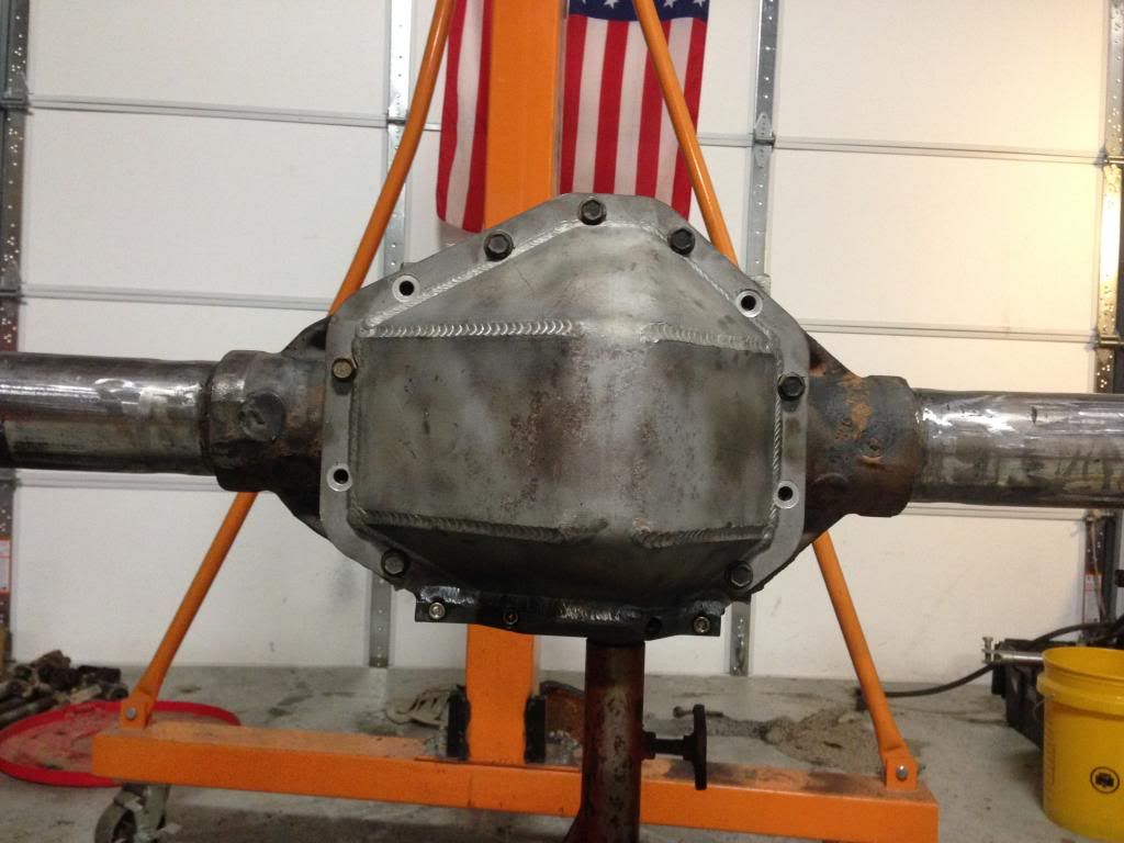

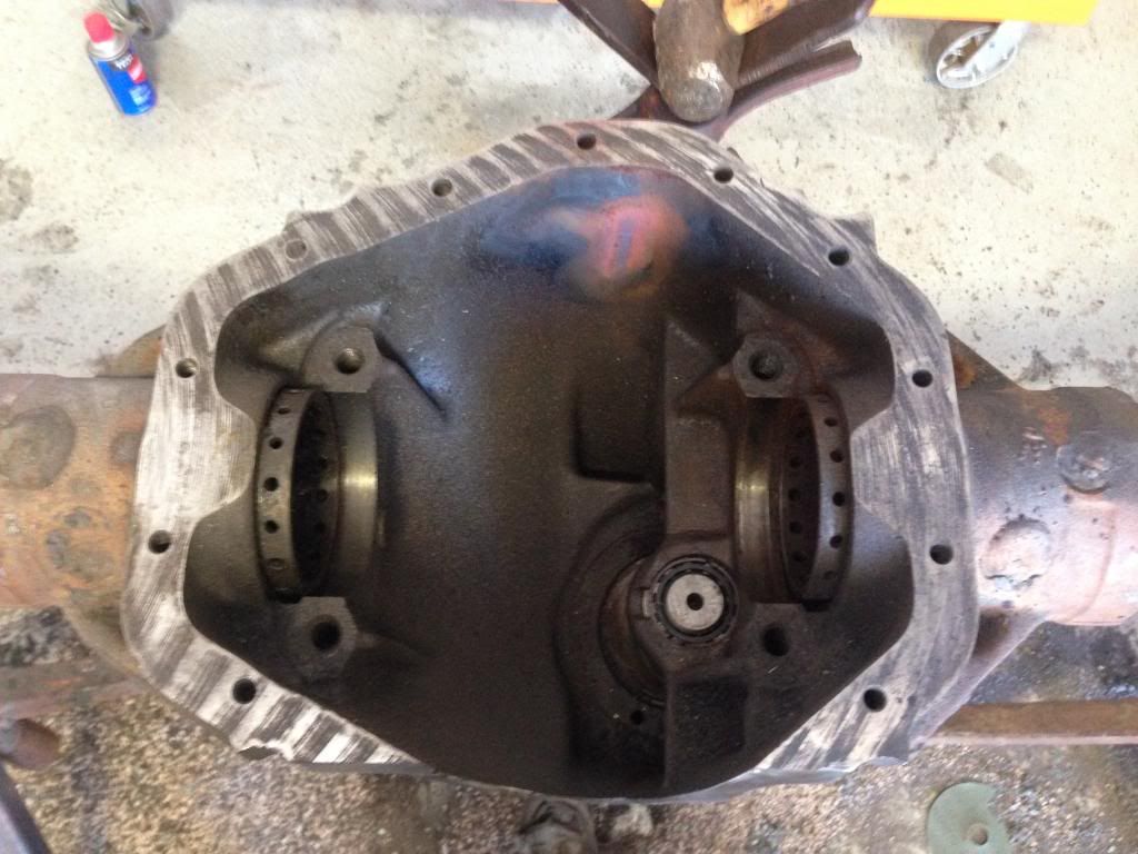

once the 14 bolt was stripped, it was time to install my TMR 15 bolt shave. this kit is awesome, and totally worth the work!

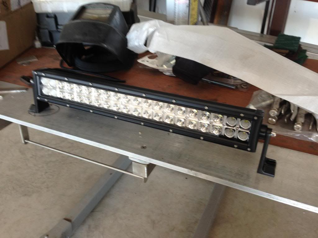

while i was ordering new orings and wheel studs of the H1s i ordered a 20" Trail Series from TWF for the front of the MJ. I was blown away by the light output of these light bars at KOH and had to have one!

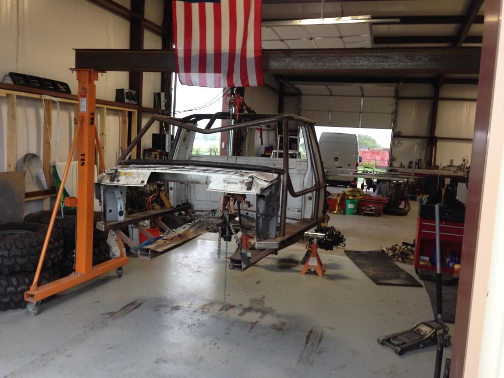

and finally moving day! I was super stoked to get the MJ into the new shop, didnt even care that it was raining!
Got a set of FOA 2.5" remote res 16" travel coilovers

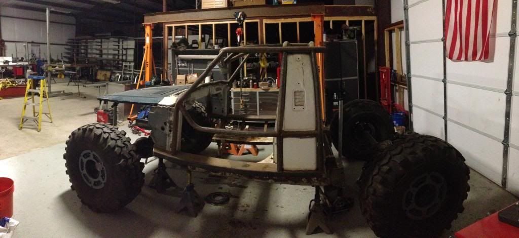

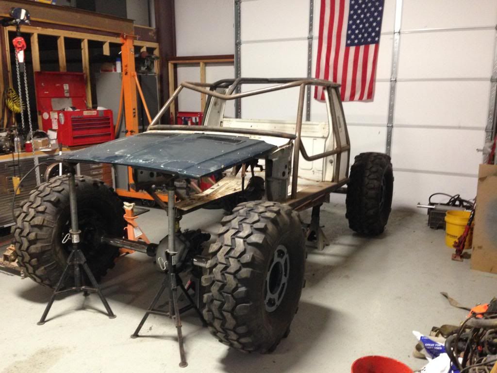

i couldnt help it so i mocked up the hood and wheel base

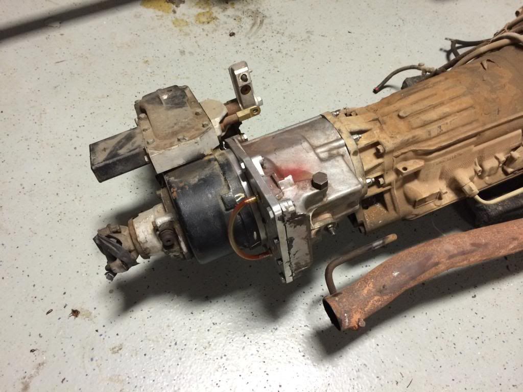

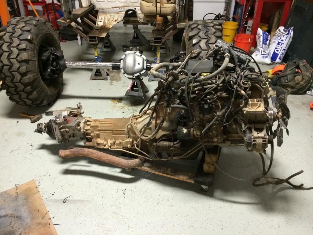

I had started thinking about making up the crawl ratio i was going to lose going from the 465 to the aw4 so got a really good deal on a brand new box for rocks kit and NWF triple stick set up. First I had to switch inputs in my doubler, luckily i had a broken 231 from the donor XJ
I had purchased another 300 a while back with a DEO flip kit to solve part of my 465-300 problems. had to woller out 3 holes to get the 231 clocked how i wanted on the pass side so i could get the 300 to fit.
I under estimated how long this drive train is... spent too much time staring at the 350-465-300
