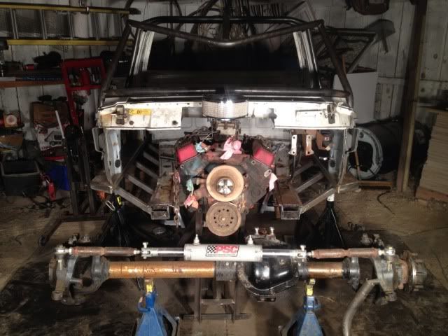

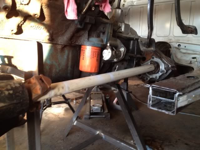

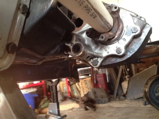

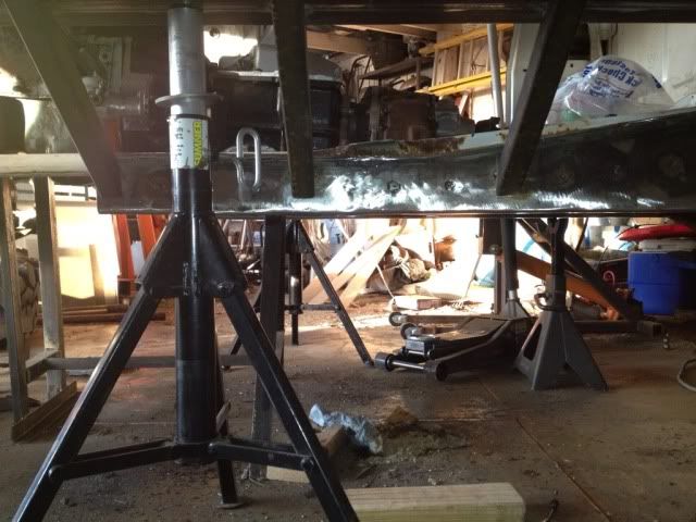

Nick came down this weekend and helped out while we banged our heads against the floor... seems like everything we tried to do had clearance issues... but what ever, got a plan to move forward. Cut the firewall and cowl out and got the motor pushed back 6 inches. going to have an access panel in the cowl to remove the distributor. the 300 stock shifters interfered with the trans so i had to take it apart and going to have to move the shifters to the top of the case. i wanted to run lexan panels in the foot wells so we decided to cut the whole fire wall out and trim some more off the frame so i can run longer lowers. with the manual my foot pedals were going to be close with a 4 link and the boat sides so we decided to run a 3 link with pass side upper. got the rock jock set at full bump, which is 6"s of up travel, should be able to get away with a one piece drive shaft. also bought another set of air bumps. ordered my headers this morning so once they show up ill be able to get moving with the front geometry.
pics...
works better this way, ill be able to run some more structural tubing down to the frame and have a flat firewall without all the BS holes to fill. also plan is to build a removable dog house and trans tunnel so everything will be serviceable from above. bring on the hate...

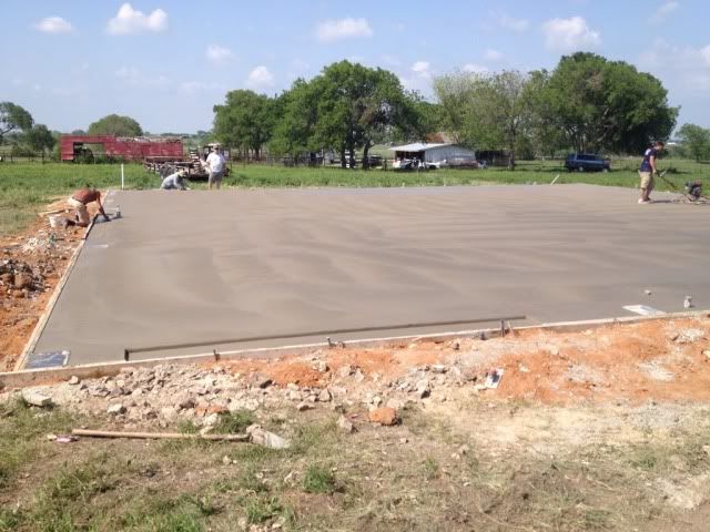

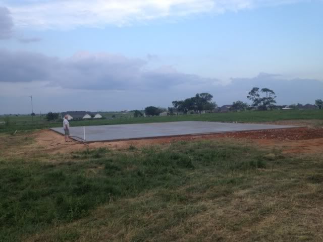

Oh and then there is this...
Finally building our shop! 60x60, overhead Trolly hoist, and 2 post lift. Stuctural is going up next week!
cgmrdc is offline

Weld up metal building? Are y'all building it or contractor?

Free span, all welded connections. Having a contactor do the first 60, too busy with work and need it too bad to jack with building it ourselves. In the next year or two we plan on adding anothe 60' to it, we will prob build that.

In the future let me know what you need. The family business is engineered steel building manufacturing and components. We do complete steel buildings and components for weld ups. Everything is fabbed or formed in house.
