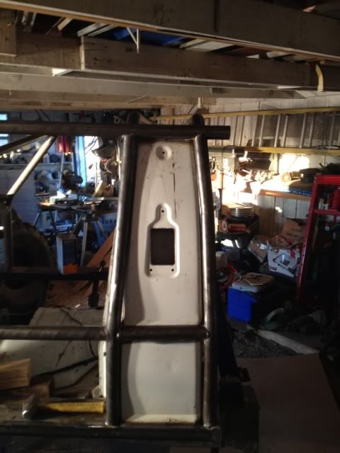

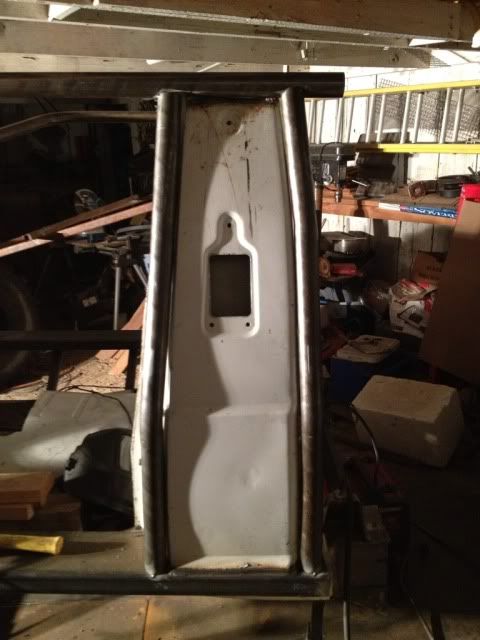

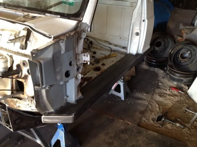

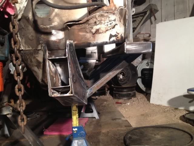

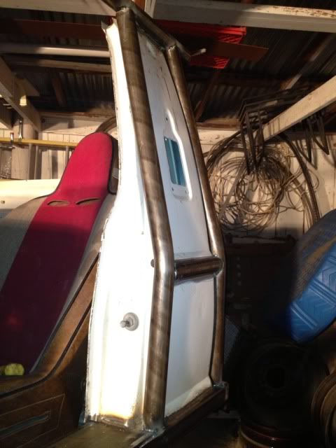

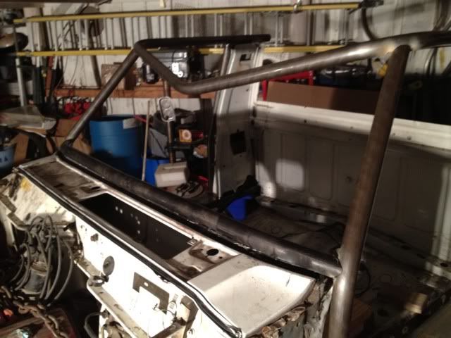

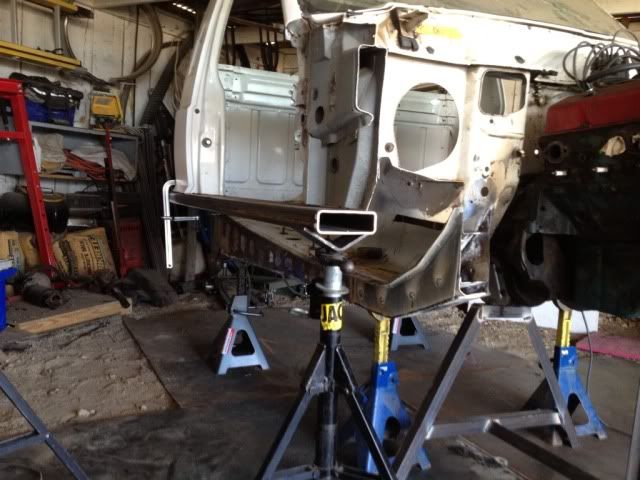

got some time in this evening after work

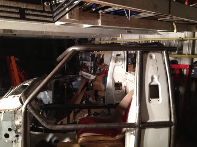

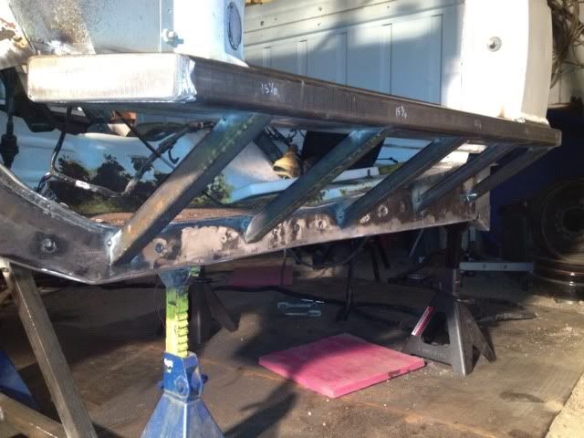

side protection
dash bar
mis bent the a pillars and they ended up being perfect for how i wanted my door bar so went ahead and threw one on tonight

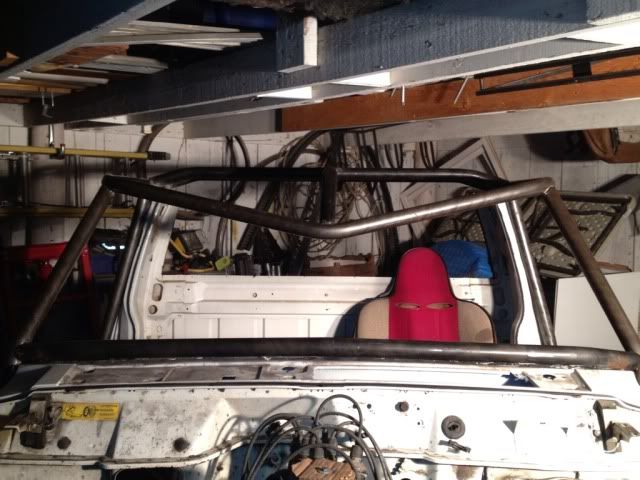

post #69 of 186 Old 03-11-2013, 11:01 PM
TechJeeper
Location: Midland
Posts: 521
Forget the haters it's looking good so far. Are you going to cut the roof to match the roll cage? Angry roof too match the angry cage and graft it into the cage.

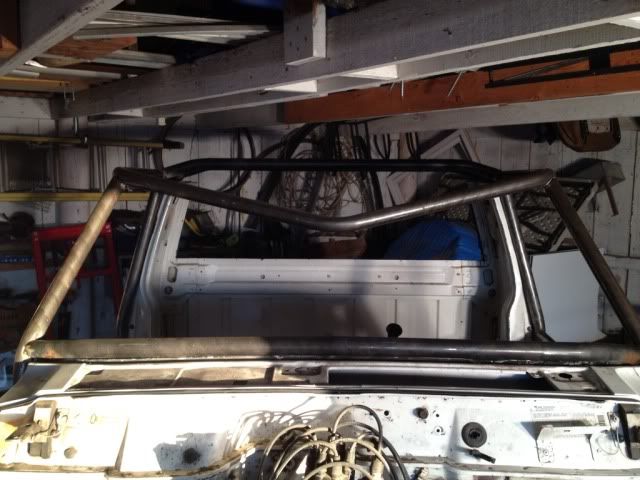

post #70 of 186 Old 03-12-2013, 09:59 AM Thread Starter
cgmrdc
1988 MJ Comanche
Location: Denton
Posts: 909

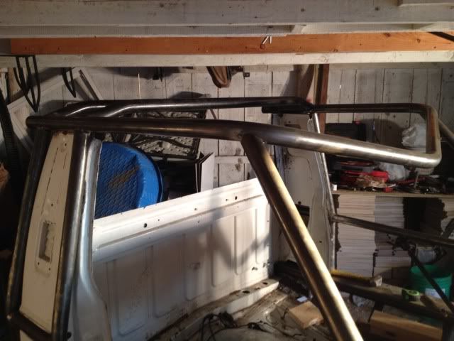

The original plan was to graft the roof back on to the cage but the stock sheet metal sucks, even with the TIG it's a pita... And I work with thin sheet metal all day long... I'm going to fill in a couple places with some 12 ga, but most of it is going to stay open. Now that I've got the cage design locked down I don't really want to cover it up ya know?

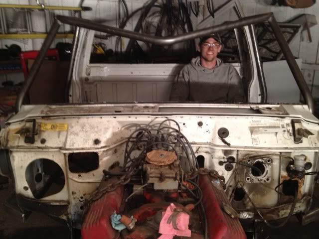

Gf was in town for a couple of days so last night we went out and tinkered a little.

This is the inside of the roof, in order to graft it onto the tube I'd have to remove all the bracing, cut it up, grand all the paint off and the stuff is only like 24 gauge. The roof bubbles and doesn't match the shape of the tube. Plus I'd have to build a filler peice to come down and fill the brow. Again, that's what I originally planned on doing but it's not worth the work. When it's done, if I decide I want a roof, I'll build a new one out of new sheet. But I love wheeling an open top rig so I doubt it is going to happen...
