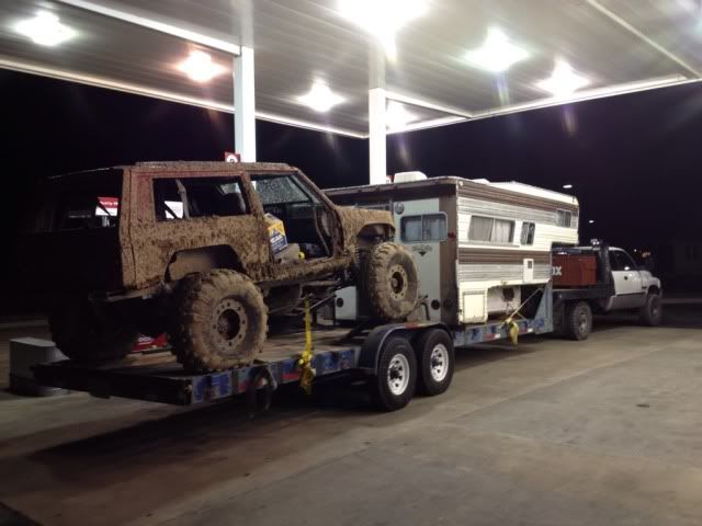

but first, got the camper set up and took it to SMORR Froze Over. all i can say is WAY better than tent camping, especially in the bitter cold

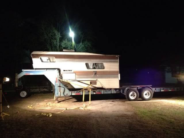

This is the trailer i started with
Finished up about 2 am the morning i was supposed to leave.

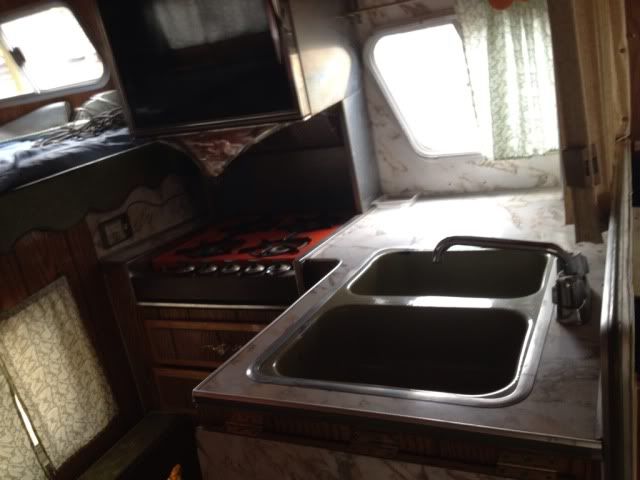

The outside is a little rough but the inside is in really good shape for 1971... Stove, over, fridge and heater all work!
Just the right size for a jeep on the back (lilnickt's xj)

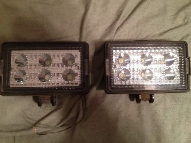

Picked up some LED fog lights, 20 bucks, dont know where im gonna use em yet, but oh well... maxxima 6.5x4s

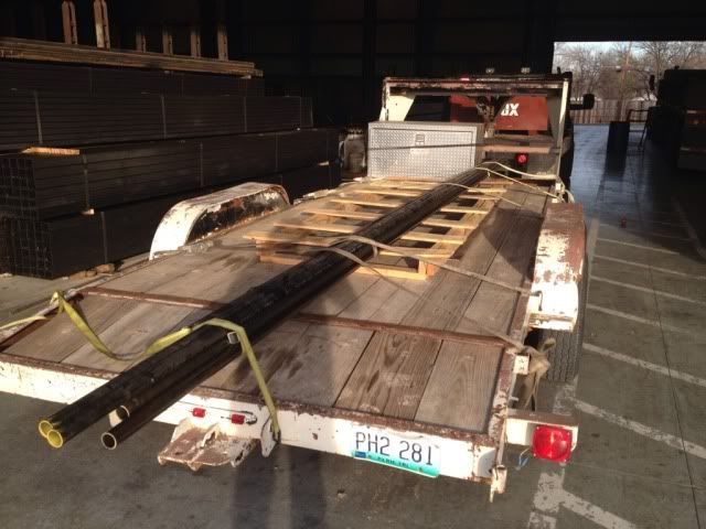

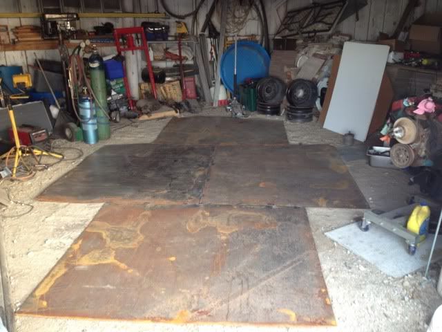

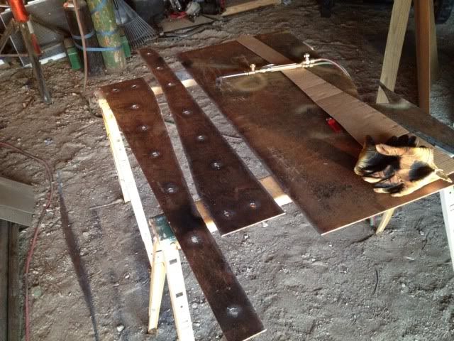

got some more plate for the frame, 90 ft of DOM to start the cage, 2x6 box and 1.5 spare for the boatsides

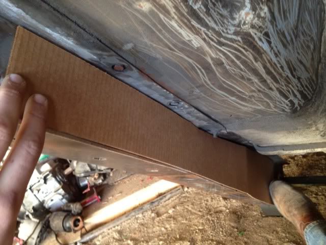

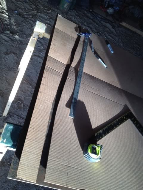

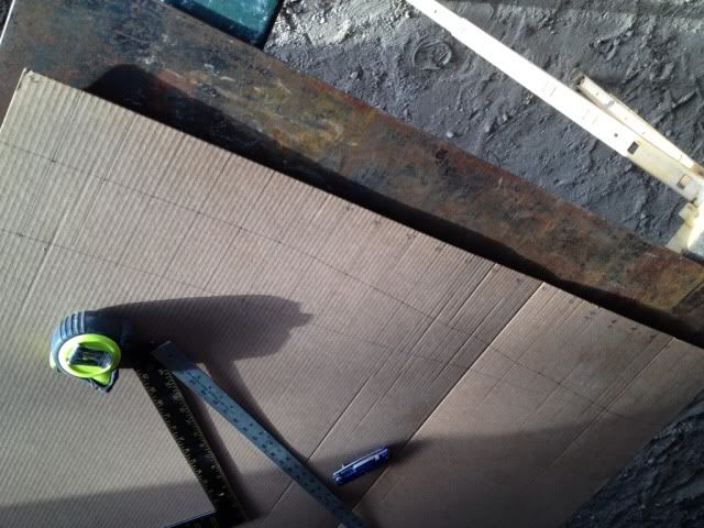

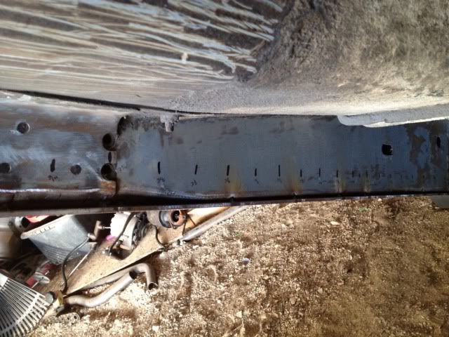

so the side stiffeners are a little more difficult to make templates for, obviously you can trace out the lines on cardboard, so i drew lines on the frame every two inches and measured the cross section
then i transferred that to the cardboard
cut it out and trimmed a couple small spots
the best part is this template works for the inner and outer frame rails, so i traced it on the steel and cut it out, cleaned em up and tacked em on

I like your idea for for measuring the frame to create the templates. I'll be using that idea soon for my MJ.

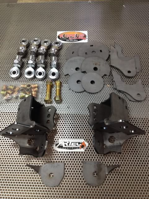

sooooo, as if i wasnt busy enough with work got some upgrades to do to another jeep has put the halt on the MJ... but that just means more money for the build right!?
Doing a rear 4 link/ coil conversion with a mixture of ruff stuff and artec parts (normally i build my own brackets but in the interest of time we decided it was best to buy some) i will say im extremely impressed with the artec 4 link brackets we got, shipping was super fast too. and as always, you cant go wrong with ruff stuff.

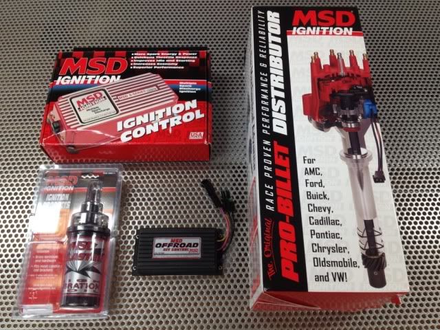

More parts! got an MSD pro billet distributor and MSD-6 off off road ignition with a blaster high vibration coil from intensebik on pirate and got an MSD off road rev limiter from a guy here in dallas on CL. everything brand new in box!:smokin:

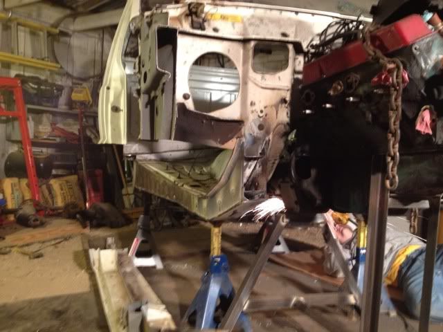

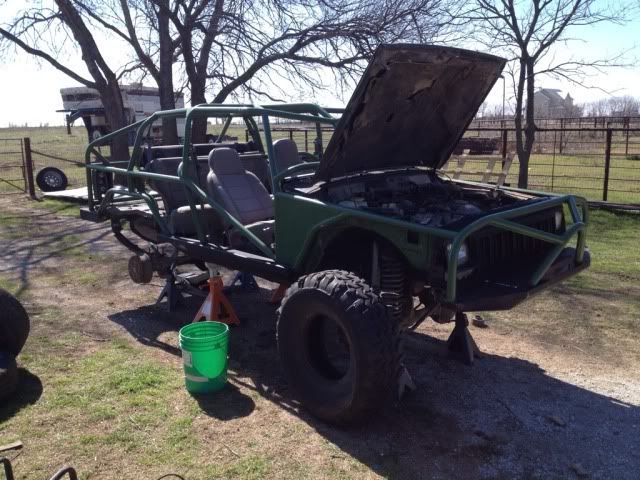

got the bottom and inner frame plates welded out tonight. im going to go ahead and cut the frame off at the fire wall so i set the jeep back down and put it at ride height so i could make a straight cut and then build my last small inner stiffener piece.

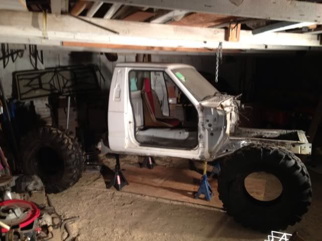

and since i was wrapping up for the night i figured id throw the tires up and see what it would look like. Pic is at 110" WB with 20" belly on 39.5 TSLs. Thinking maybe another 2 inches in the front would look about perfect. Thoughts?
cgmrdc is offline
post #58 of 186 Old 02-26-2013, 10:25 PM
MisfitSeven
MAiL Crawler.
MisfitSeven's Avatar
Location: Bennington
Posts: 4,293
Definitely, two more inches of wheelbase in the front would look better with a better approach as well. Will the tires run into your front bumper easier if you pushed them forward more, maybe. It will be worth it and should be easy to overcome, though.
While we are on the subject of wheelbase, I think another two to five inches in the rear wouldn't hurt. It could just be the angle of the picture, but I think it might help proportion-wise. Can you take a pic of this wheelbase and post up, ~115"?

dont have one of the rear pushed back, but this is 115 with 5 more in the front... the whole front frame is coming off at the fire wall and the grill is getting narrowed so tire clearance isnt an issue. 115 im thinking will be too long for the trails we ride. some times stock wheel base XJs have trouble making some turns in one shot...
Im thinking its the picture angle and bad lighting. i cant get far enough away in my shed to get a straight side shot. but with how im planning on doing the rear tube work it should help the proportions as well.

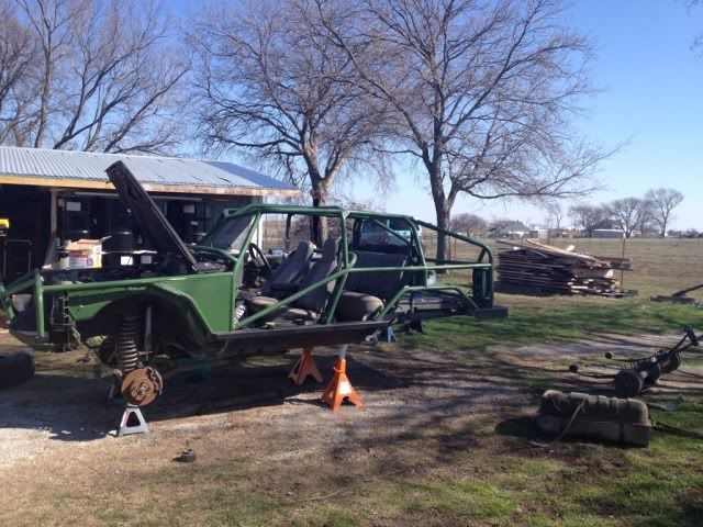

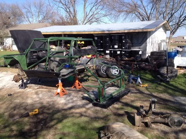

post #60 of 186 Old 03-05-2013, 01:26 PM Thread Starter
cgmrdc
1988 MJ Comanche
Location: Denton
Posts: 909
Ill let the pictures speak for themselves...
