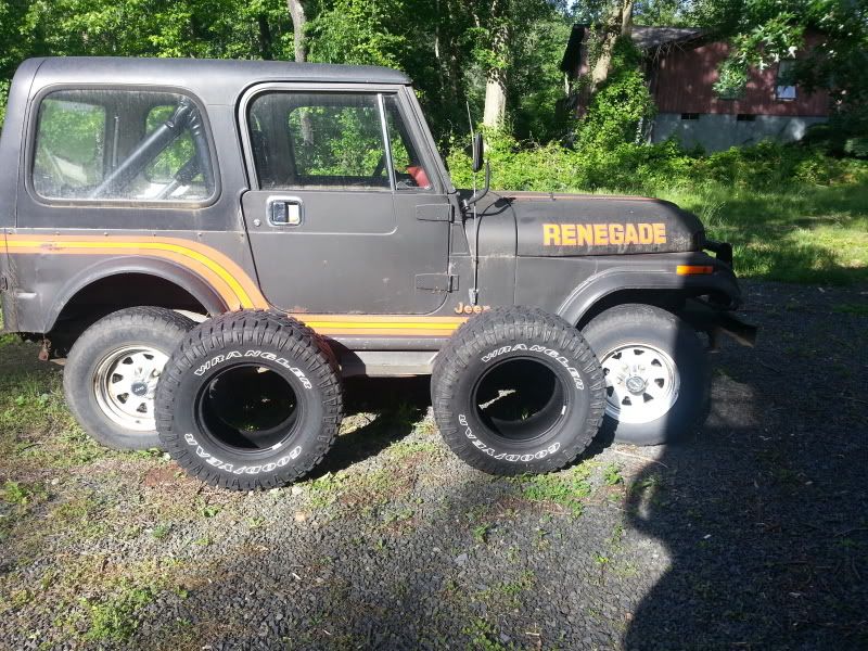

In other news I plan on picking up some lightly used 31s tomorrow and hopefully by the end of the weekend have some new wheels and tires mounted up....

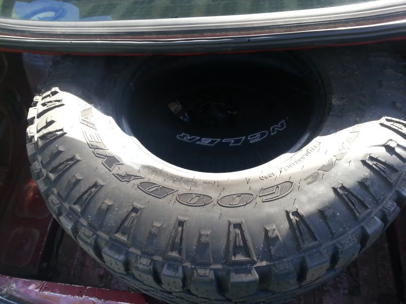

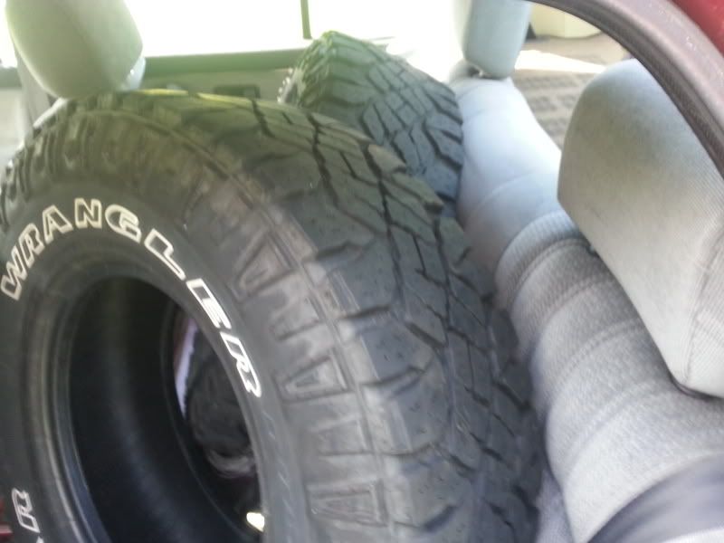

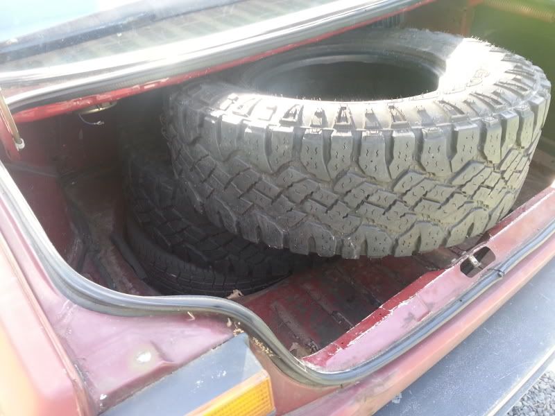

Made some more progress, picked up some used but in great condition tires today.... Take a look.
My friend my know jeeps but doesn't know much about a 1985 jetta. He insisted I wouldn't be able to transport all four tires in her..... Well it fit with room to spare
And two in the trunk...
Here they are in comparison to what's on there now...
The girl I picked them up from said the tires rode awsome, I'm sure they will.
85cjrenegade is offline

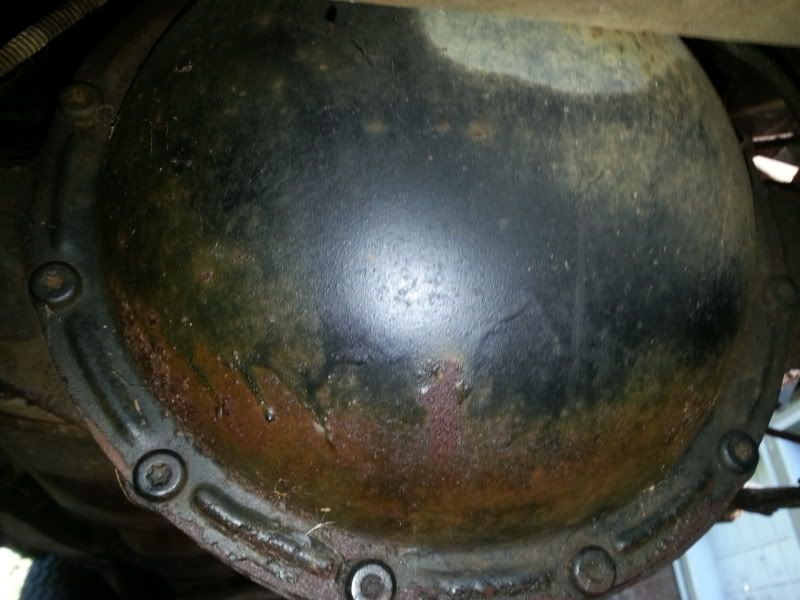

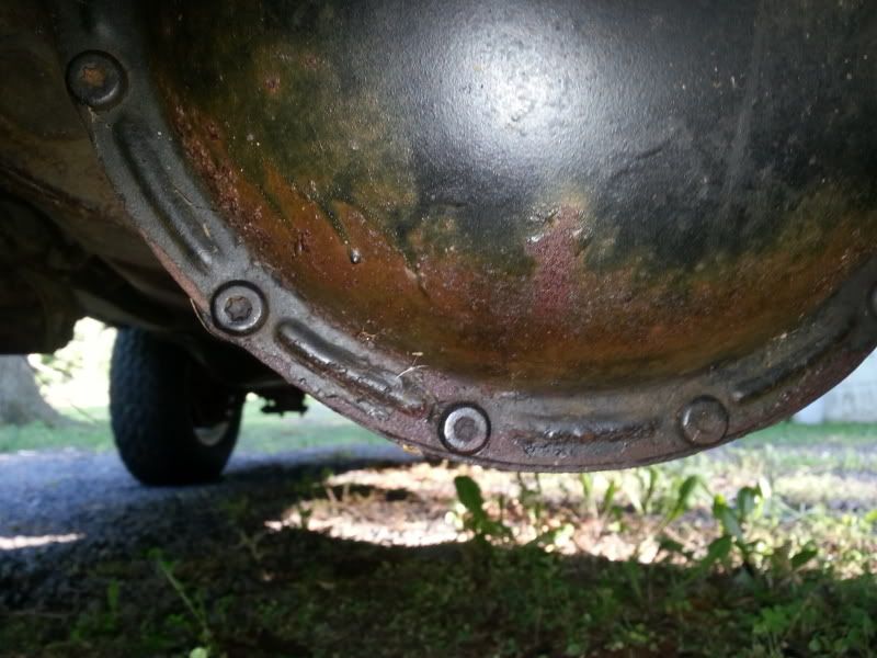

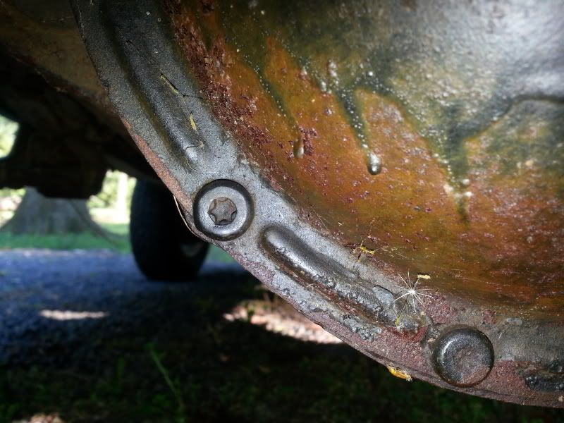

On another note can someone tell me by looking at this if it has truetrac?
post #53 of 306 Old 06-13-2013, 09:15 AM
06moneypit
Location: Cream Ridge
Posts: 91
That's just the cover or the AMC20. What is the tag number on it say? Can you get a pic of that after the rain passes?

Sure where is the tag located?
post #55 of 306 Old 06-13-2013, 05:20 PM Thread Starter
85cjrenegade
Join Date: Jun 2013
Location: Central
Posts: 244
Ok I climbed my monkey *** under the jeep in an attempt to find an identifier...
This is what I found..."B"
A b indicates
Wide Track AMC 20
3.31 gear ratio.... open
There we have it folks

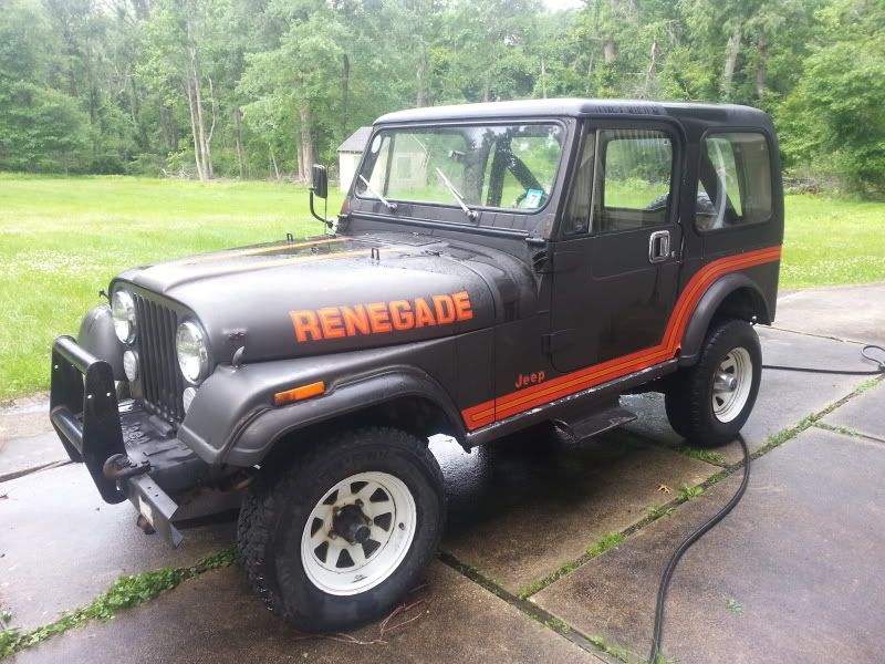

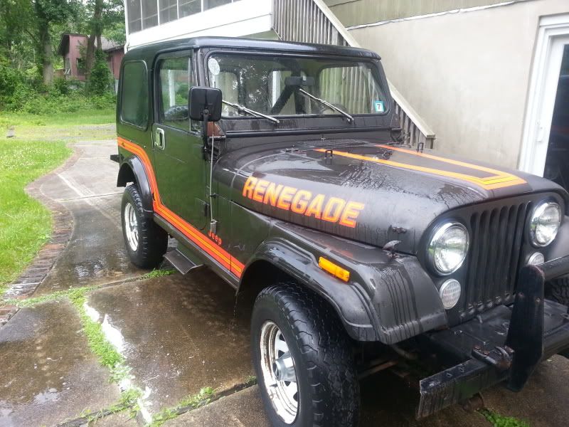

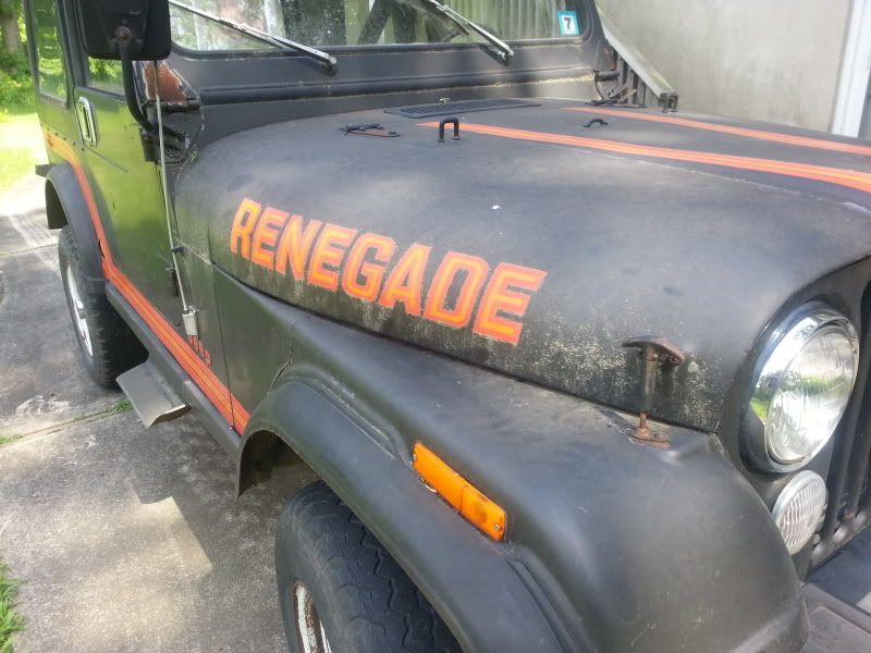

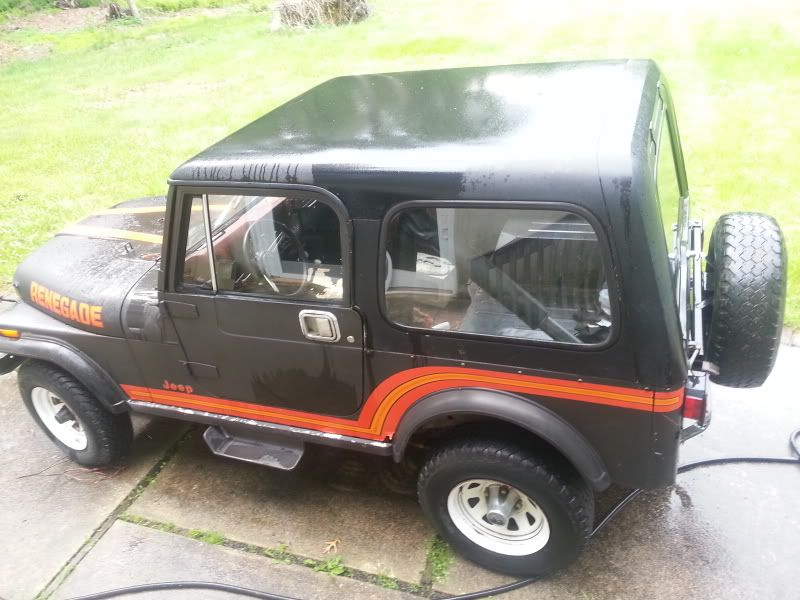

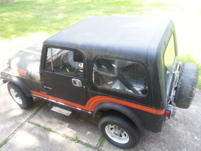

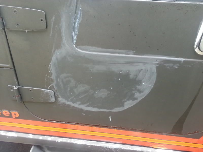

Nothing earth shattering here today.... Had just a little bit of time so I washed the old girl... I I didn't expect much but wanted to get some of the green funk that was on it... Came out better then expected look here...
Pre wash...
Post wash...

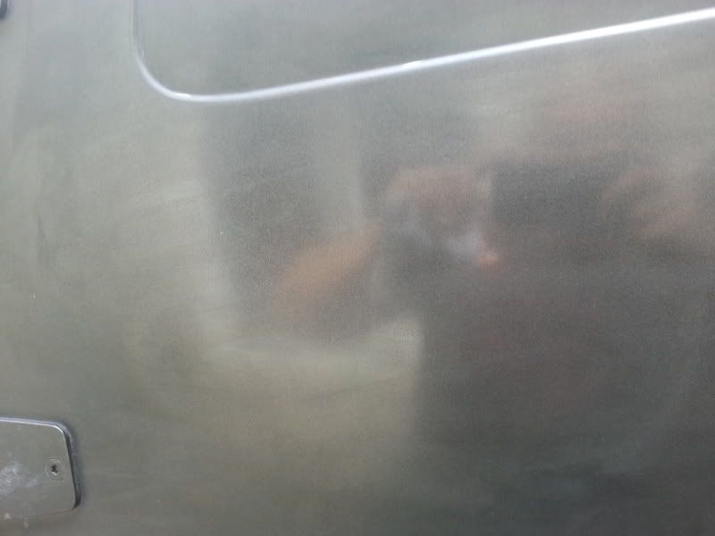

Just for ****s and giggles I polished up the door a bit to see what was left in that tired paint...
Section of door looking very much like slate
Came out alot better then expected picture does it no justice...
Look at the color of that water!!
