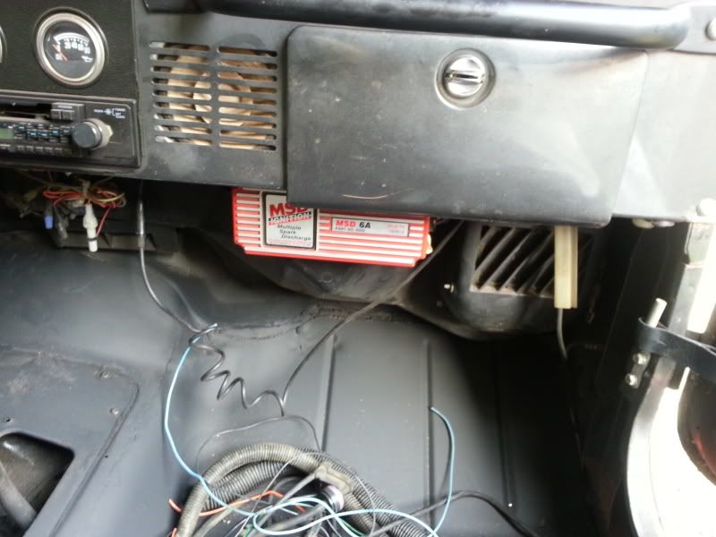

I noticed alot of people install it on the fender however heat is definitely a concern with it sitting under the hood. I plan on installing it inside the car most likely behind the dash were the Oem emission control box was installed, I also thought maybe the drive shaft hump/tunnel in front of the shifter, might be good.... Take a look.
Behind dash.
On hump..

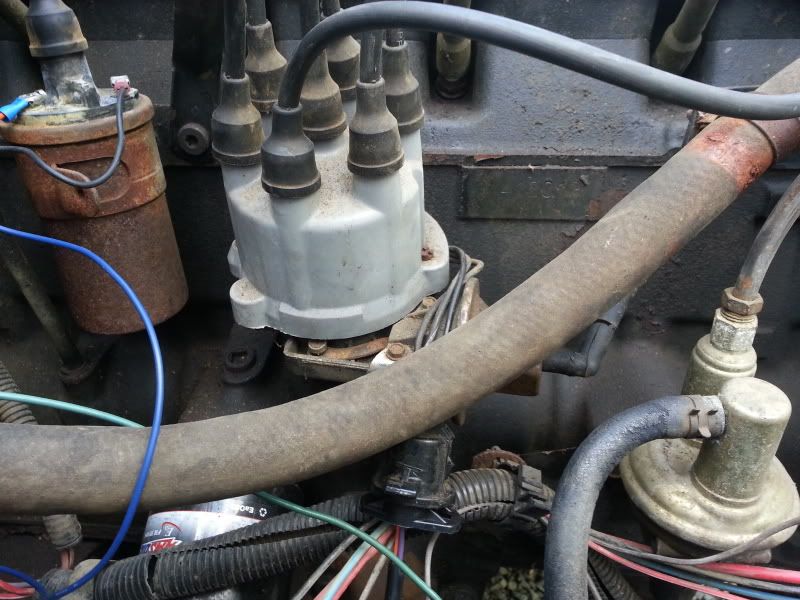

So here is where the Oem ignition system gets plugged in, and will be the source for the Msd ignition... I can't believe it's wrapped in what is comparable to duct tape....
Here she is discontented...
And now for the adapter.
All plugged in...
I also bought the distributer adapter and the magnetic pick up extension...
Here is the Oem distributer plug..
Plugged in...
And the extension..

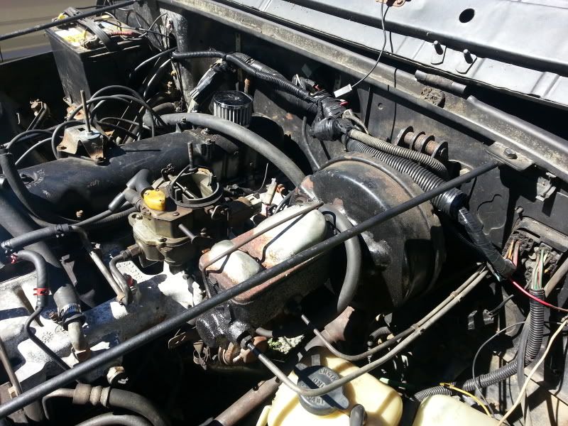

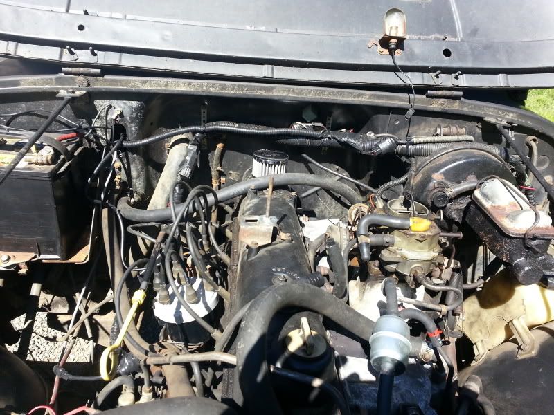

If you remember I got rid of slot of emissions related parts however one thing I plan on keeping is a pvc style system... I'm going to run a filter in the rear valve cover opening and a catch can out of the front opening....
Here is the filter, went with k&n I don't know how I feel bout the chrome I might paint it black...
Some new rubber gaskets...
And in she goes..
And here is the angle fitting I'm going to run to the catch can....

Put a little work in today, I was determined to get her running today. First I started by installing the Msd ignition. It's very simple to install thick red and black wires go to the battery, thin red goes to signal and orange and black go to coil that's it. The hardest part was figuring where to put this thing.... I found a nice location where it can be both showed off, out of the way and also get plenty of air..

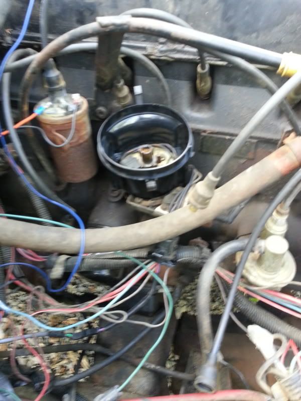

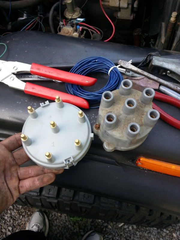

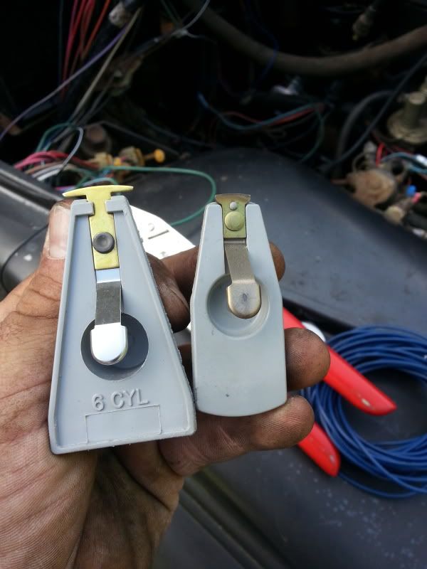

While I was at it I figured I'd do the team rush upgrade.... Installed the larger distributer which always for a more accurate spark...
Bigger lower adapter...
Difference in rotor size...
Difference in distributer cover...
All in place..

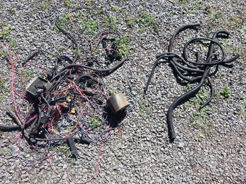

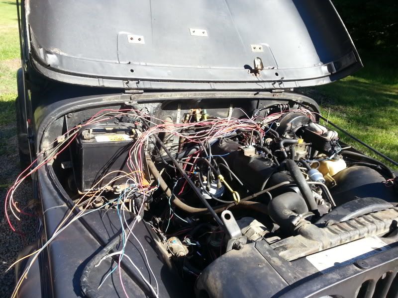

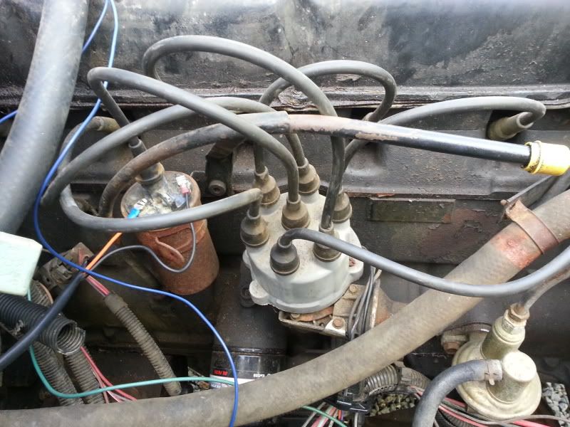

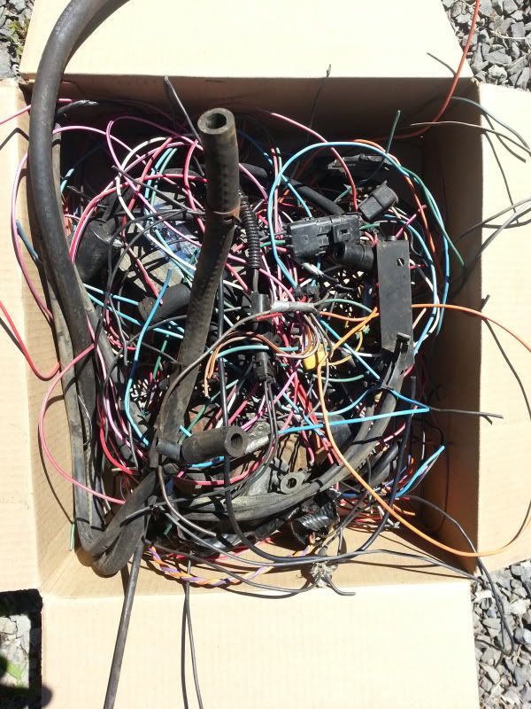

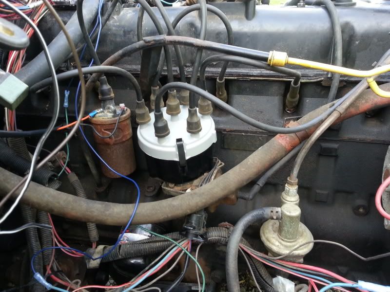

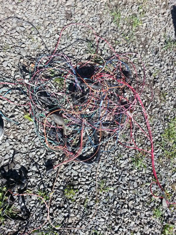

Finally got around to cleaning up those damn wires... And boy did I.
I just followed each wire, and after every few, I'd check to make sure it still started up.
Here is where we started at...
After a few...
The finished product..
Look at all these extra parts... Jeep could have saved themselves alot of money if the would have just left these parts off.. Lol
85cjrenegade is offline

How strange.. Were those just wires used for less important things like tailgate lights and stuff?? Or dome lights? Or what?
theCREECH is offline
post #142 of 306 Old 09-18-2013, 06:54 PM Thread Starter
85cjrenegade
Join Date: Jun 2013
Location: Central
Posts: 244
Mostly safety stuff.. Lol.. All emissions nonsense my friend

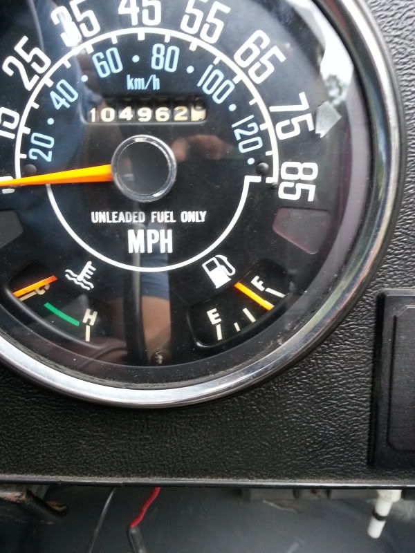

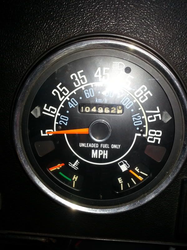

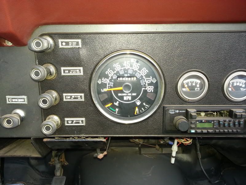

Today was a good day I... I took the jeep out early this morning and made my way to the gym... After that drove all around town and really enjoyed the nice weather.... I was able to fix the fuel gauge that is ever so important and also bolted up the drivers side mirror..... Good day all around.

Why is the fuel gauge so important Doug?
RonJitsu is offline
post #147 of 306 Old 09-22-2013, 01:35 PM Thread Starter
85cjrenegade
Join Date: Jun 2013
Location: Central
Posts: 244
Lol cause day one I ran out of gas :-(......
