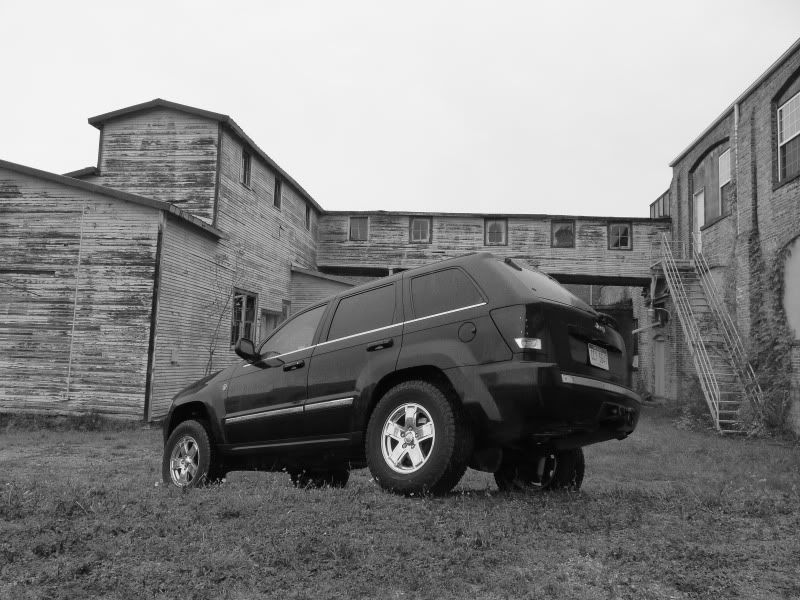

Come a little farther...
In the past week I've installed a set of 3000k HID''s in my fogs. They are from DDMTuning.com, very reputable and very affordable company throughout the automotive community. I did not use a relay for the installation or the direct power harness that has a relay inline because I wanted to see if I could manage without, which I have. They are extremely bright and I cannot wait for a foggy or snowy day to experience the best of them. They are perfect.
Yesterday I had a set of 265/70/17 Hankook ATM RF10's installed. They are a 10 ply version that have gotten some amazing all around reviews from offroading and truck magazines, as well as rave reviews online. I was able to pick this model up for $187/each installed which was a deal from what I could find elsewhere, $792 OTD. I couldn't resist the urge for a quick photoshoot today, taking them offroad next weekend!

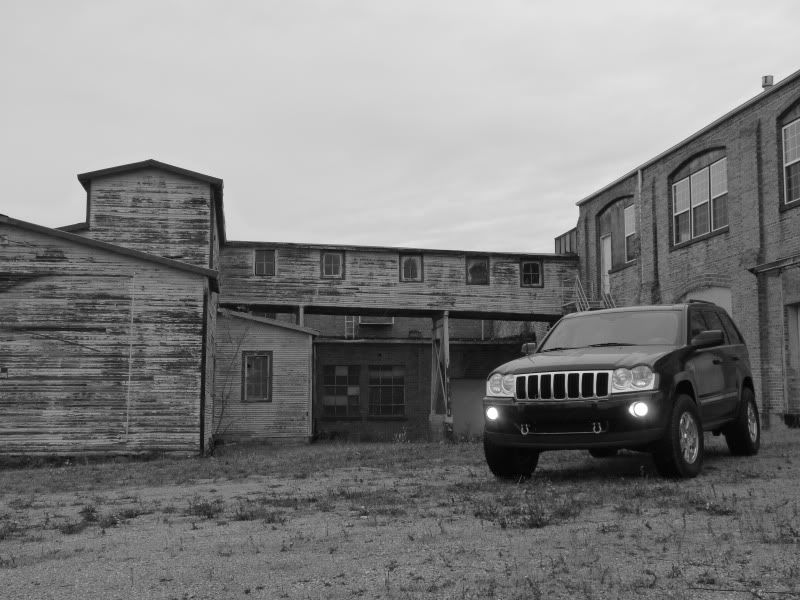

I've been doing a lot with the Jeep since I put the tires on... How about a little picture update?

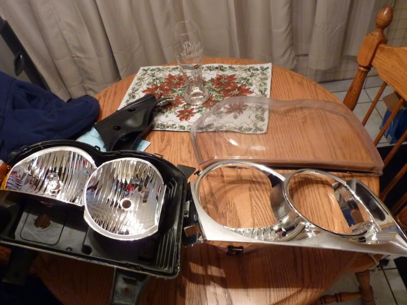

Just a little update! I installed a Laredo grille, ordered a S4xC t-case skid and 4xG belly guard. I also installed a 4xG diff guard and had the front windows tinted. This thing is basically done as far as I'm concerned... front guard eventually but I scrapped the idea of a muffler and intake for now.
We thought we would try something new and tape off the rings with pinstriping as masking leaving a chrome ring but when we peeled it off the chrome came off too. Even with painters tape the chrome was coming off. Cheap ****s!
Will post more pictures when skids come in. I also plan on undercoating this thing somehow. Whether I have to put it on a lift, scuff it myself, and rattle can bed liner it or pay to have it done professionally. Either way I want this thing to stay as rust free as possible!
