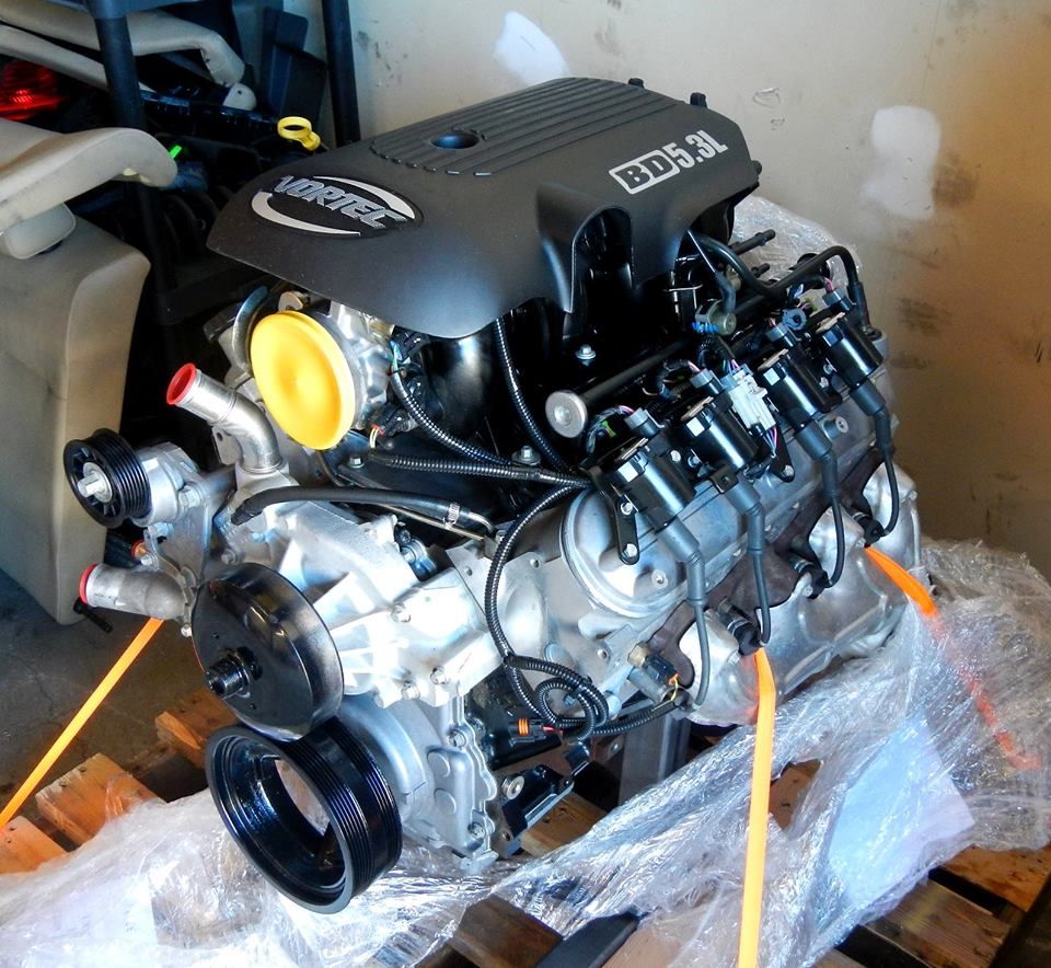

...even after jetting the carb for "off-road" the Jeep would still stall on steep inclines and hard drops. So with minimal research I decided to go thru BDTurnkey Engines. Sure, I know I could have pulled one from a junk yard or hit up craig's list....but my business and hours spent at the office just do NOT allow me such time. This was much easier and built properly. I feel the choice was well made.

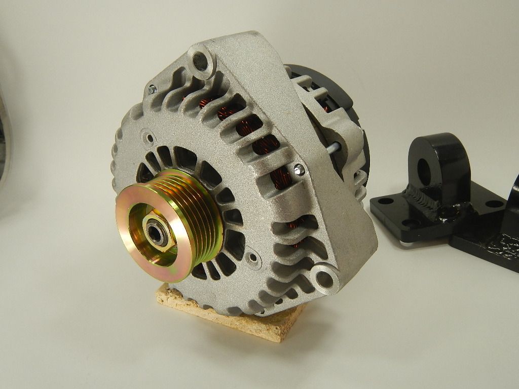

..opted out on the stock alternator and upgraded to a 250 amp version....

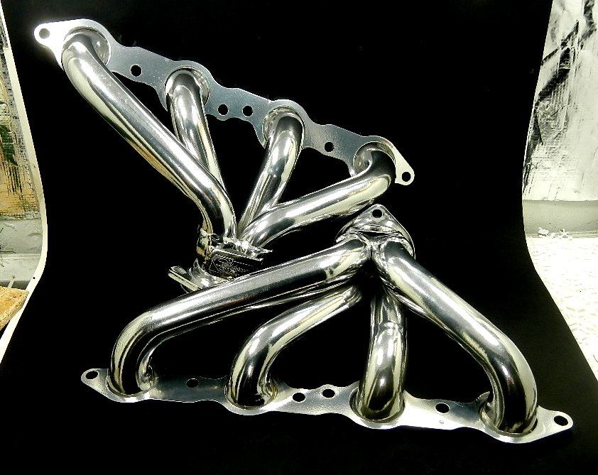

Knowing the Vortec headers would not work in my application I bit the bullet and bought ceramic coated Sanderson headers...oh my God the wife DID COMPLAIN ABOUT THIS ONE! It's kind of a "forced purchase"...got to have different headers.

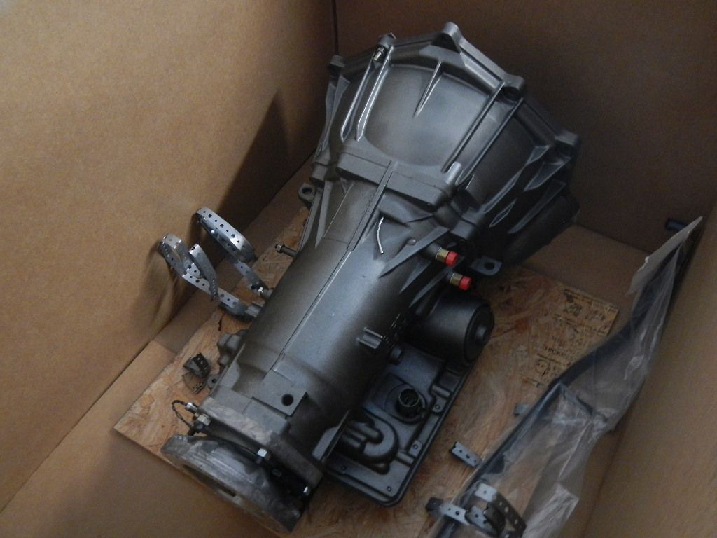

...FINALLY this came in this afternoon from Novak. Already adapted for the NP208 transfer case, VSS installed too...
[IMG][/IMG]
[IMG][/IMG]
Trans is their Level II build...
all the stuff done to Level I of course plus
High performance, furnace brazed torque converter
TransGo shift kit for strength and improved, calibrated shift timing
Alto Red Eagle clutch discs and band
Beast Reaction shell
Corvette 2nd gear piston
8-clutch 3rd gear pack
29-element sprag
Wide band
New reverse input drum
Large boost valve

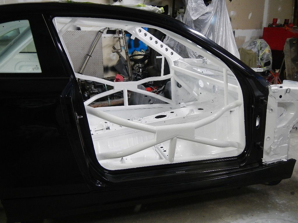

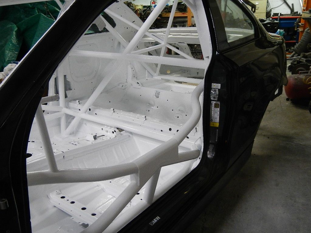

..in case anyone is wondering when I mentioned BMW's....this is current Grand AM project I am painting. My buddy does all the building.
[IMG][/IMG]
[IMG][/IMG]
[IMG][/IMG]

and I will have this same style tube door in the jeep...with an short bar across the top section for comfort/armrest....
One blessing is the shop is DIRECTLY across the street from my house...walk right over with my coffee and get too it!
[IMG][/IMG]
[IMG][/IMG]
